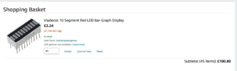

so the best deal I found is 45 of the 10 led bar display's for £100 the moneys not too much of a problem but wondered if you could source some cheaper ones?
Where did you get that price from?. I’m sure I bought 10 bar graphs for around a £5 off eBay. (China).

Of course. RS will cost a lot more but should have quality components. But they get theirs from China too. Mine are good quality as well for a fraction of the price. Just had a little wait. As they say “slow boat from China “. About 10 days really.

You’re paying £7.20 for each set of 10.
Ebay is £3.94 for 10 sets! Including postage.

that's incredible, and to say I was going to pay £100 and upwards £14.50. I'll order through a friend because I can't buy on ebay where I am.
