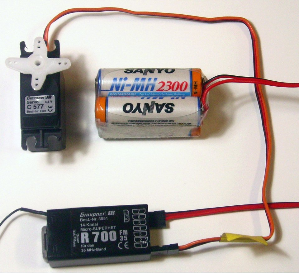

Hello,
The circuit is indeed for a RC servo.
It uses pulse width to control the position of the RC servo.
Read this wiki page for more info:
