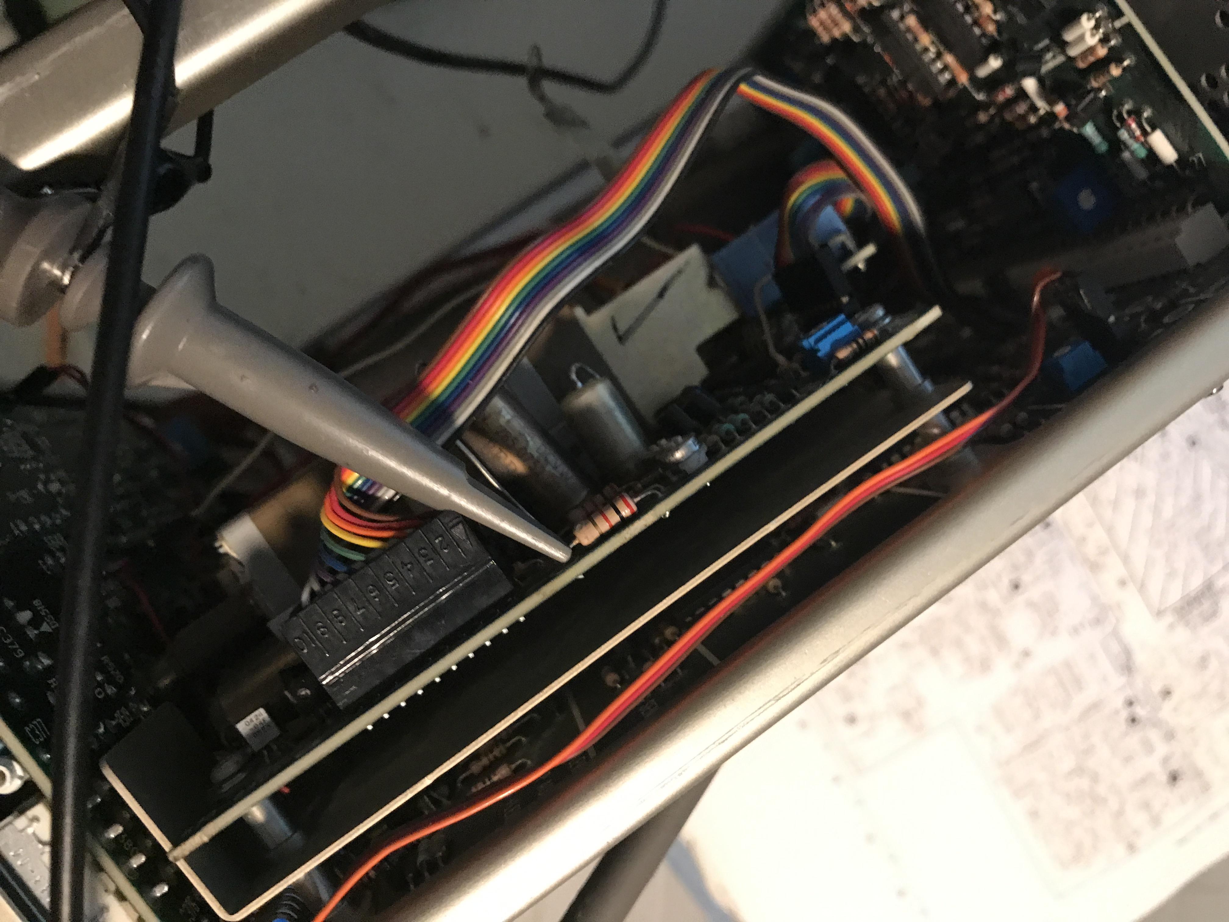

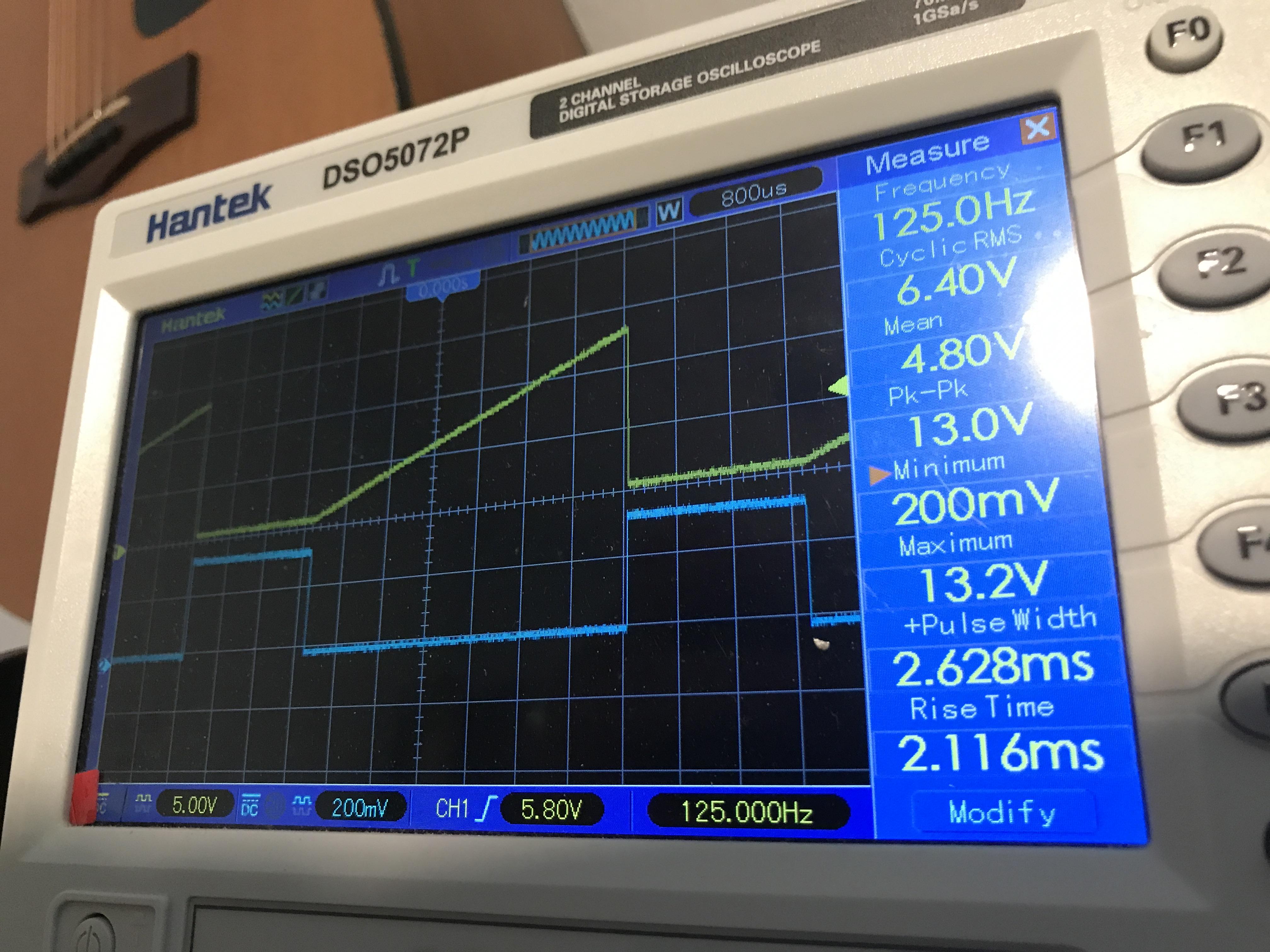

More info
Ran for seven hours without issue, playing with every knob and switch. Started again out of nowhere. During the time it ran perfect, it ran perfect in both Channels 1 and 2. During time of failure, it failed in channels 1 and 2. This still only happens on A and never on B.
Reading through the TOA where channels 1 and 2 converge to see where this splits off to A and B to try and localize the fault
JRUBIN
Jul 17, 2015
96
Jul 17, 2015
96

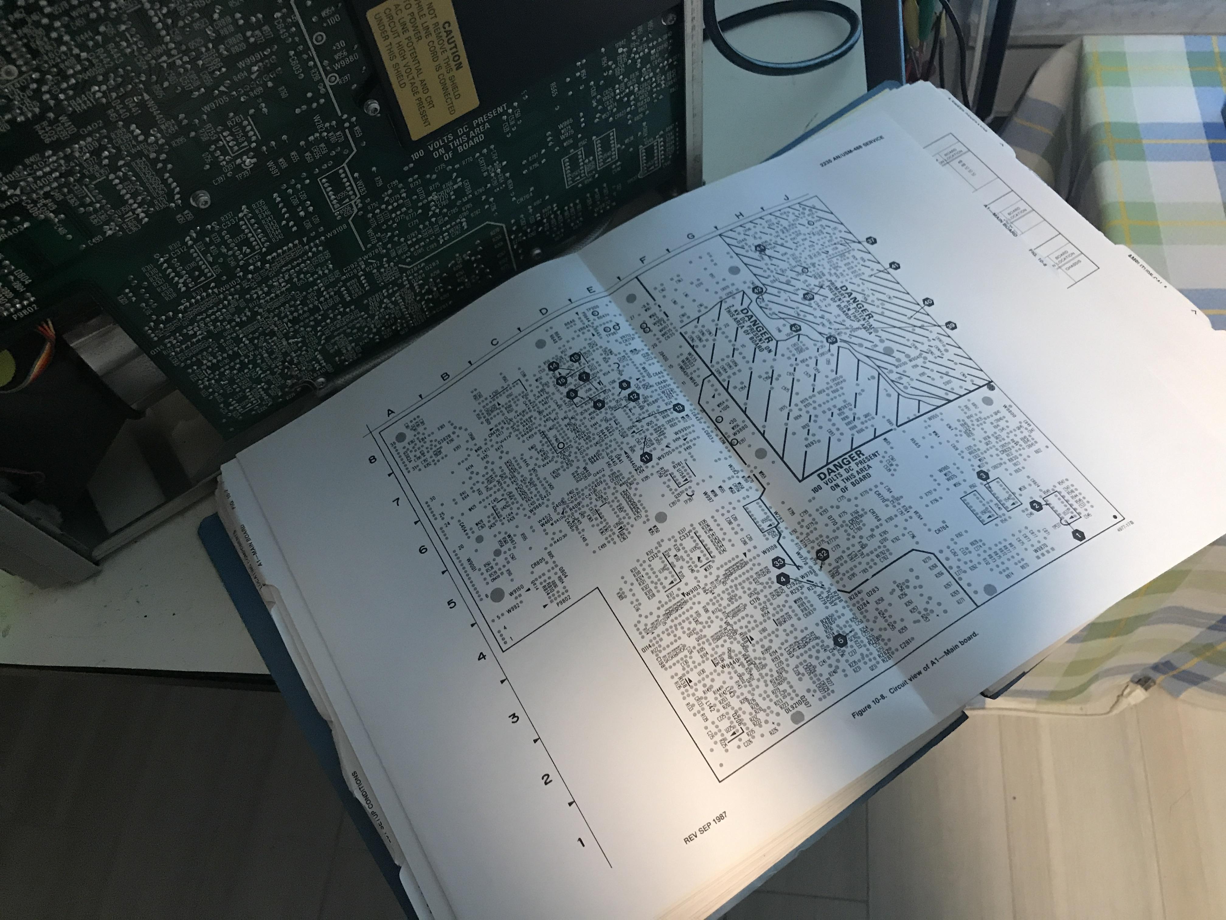

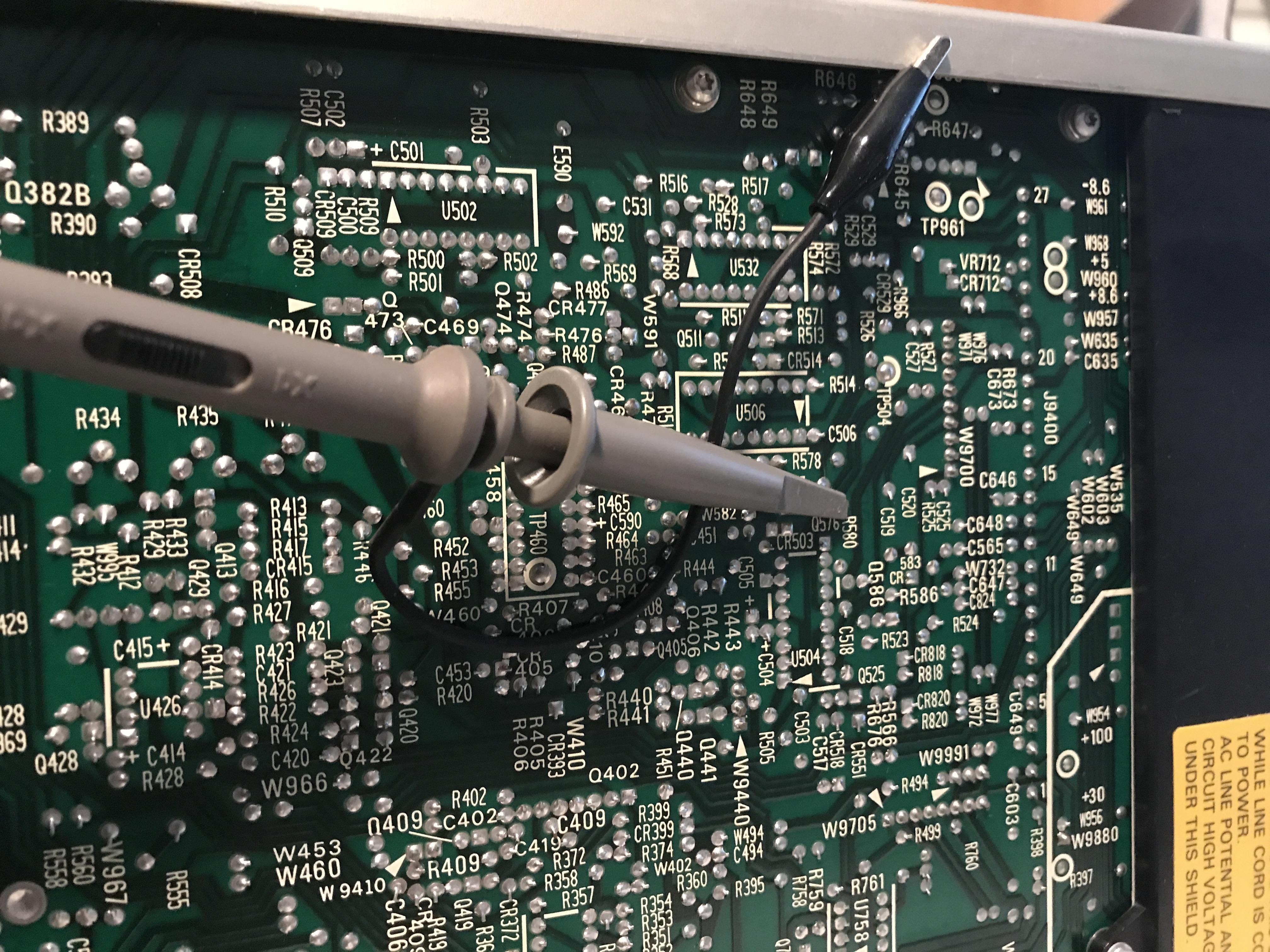

All of the test-points in the A4 timing section were checked today [6 through 16] and no indication was found that did not align to the diagram in the book or destabilize with the waveform displayed on the CRT.... onward and forward
The main block diagram indicated much activity from [4] into [3] so the next section to look at will be A TRIGGER
JRUBIN
Jul 17, 2015
96
Jul 17, 2015
96
As I read more, The front panel does not have much by way of test points, section [6] horizontal amplifier seems like a good place to work back from and should display the fault to start a traceback..
