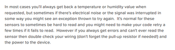

Make sure your sampling rate adheres to : https://cdn-learn.adafruit.com/downloads/pdf/dht.pdf
Follow all the recommendations in the datasheet. Like pullups as discussed.
Also if DHT11 directly in air flow path of fan consider locating it in an
area that has more thermal inertia, eg. target object, if whole room then
in some area of room out of direct air flow.
You might want to average a few samples before making decision in code to
turn on/off the fan. Hysteresis has the disadvantage that object temps have
wider variation of control. Still needed however, just be aware of this consequence.
The datasheet has no specs for output sensitivity to supply pin noise, so make
sure your supply well bypassed. Use a scope on infinite persistence, AC, say 100 mV
per box vertical setting, and look at pk-pk noise as a guide to your bypassing efforts.
Lastly make sure your code library for sensor up to date.
