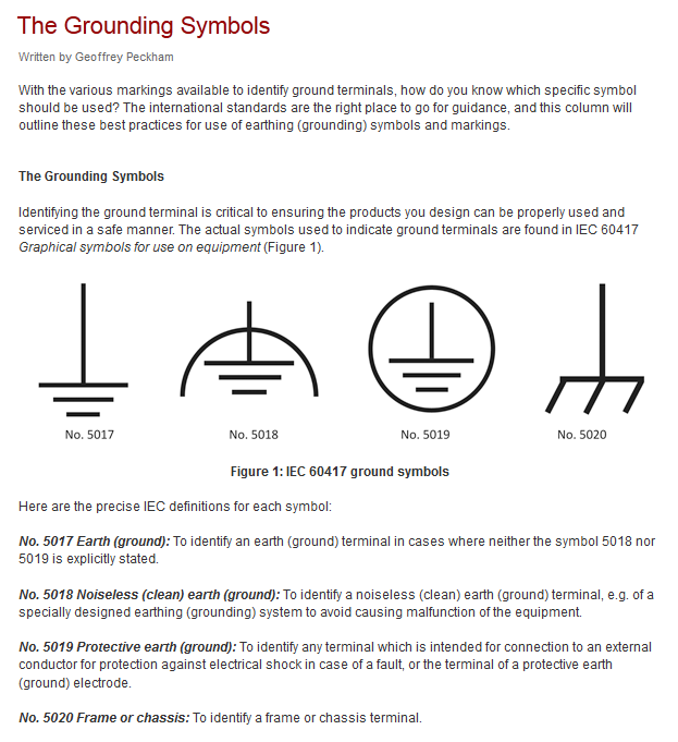

I look at both chasis ground and earth ground being the same.
I'm looking at a pc board with a flat wire connector. The one post is marked "GD". could this be chasis ground or earth ground? Oh my! Just food for thought.
The NEC and NFPA79 spell it out the IEC symbols.
The IEC 5020 is for equipotential bonding of equipment and does not indicate in and of itself that it is earth grounded.
In UK for example the term Earth Conductor is used as opposed to N.A. where Ground is used for both earth grounded and ungrounded circuit common plane, or chassis ground..

Or better still, from my experience working with other engineers. Todays CAD programs such as Altium have made us lazy in some respect as well as high density circuit design where unnecessary symbols, normally the ones with single ended arrows are removed and replaced with a wire and netlist attached to it. The ground symbols are of no exception, since the idea is to remove graphical clutter and get to the point of what the topology is saying. Since the CAD program relies on netlist for the PCB design. These netlists can also be assigned track widths and planes. Considering that there are also many different variants of the ground plane such 0V, GND, COM, CHASSIS, DG and AG throwing extra symbols to represent these ground planes would end up as confusing clutter, so a wire terminated with a ground plane netlist is an easier solution.

On Schematic capture and PCB design s/w such as Kicad, I use the exact same symbol throughout, the Logic Common symbol, if the circuit consists of systems isolated from each other, the label itself is enough to identify the various commons for the board capture.
