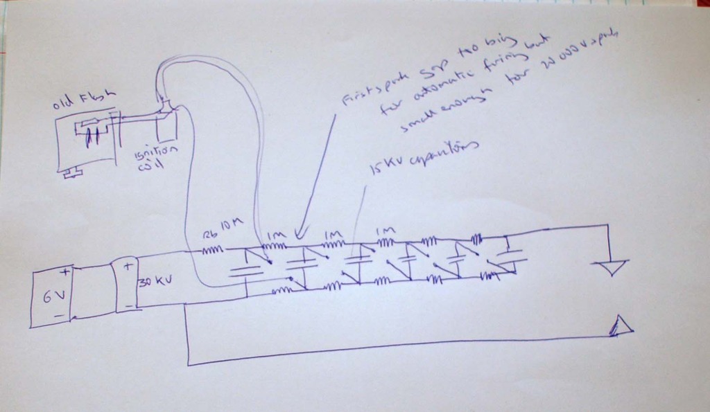

Last night I tried wiring up an ignition coil to an old flash which gives me about 20 000 volts as I take a picture. I tried opening up the first spark gap to prevent the automatic discharge and adding the 20 000 volt spark when I take a picture to actually trigger the spark when I want it.
But it isn't happening. Can anyone suggest a way that I can trigger this Marx generator with my camera flash circuit please?

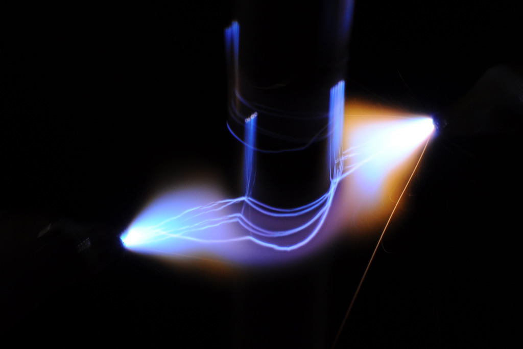

Here's an example of a spark at 1/4000th sec through sugar.
This was the flash circuit I used to trigger that spark.

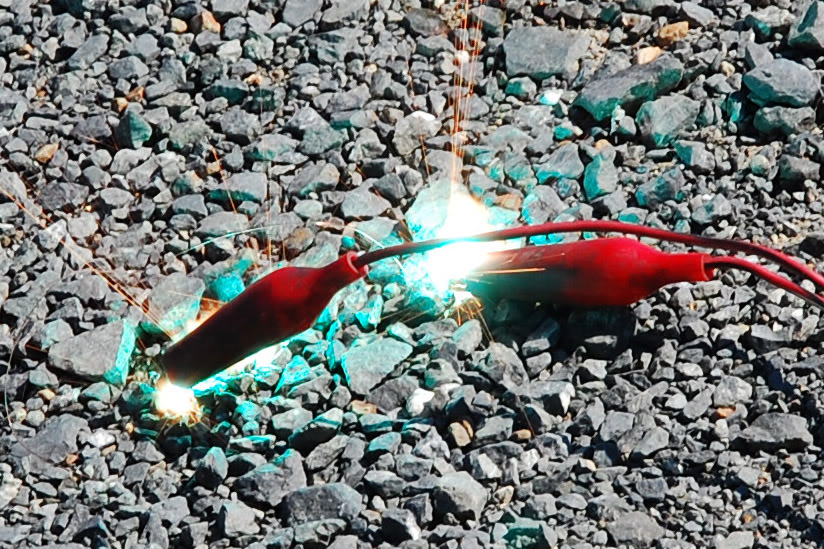

And this is an SCR dumping 300 volts from a 3300uf capacitor through a piece of copper wire at 1/1000th sec.

The DC resistance of the ignition coil secondary winding appears to be shorting out the first stage of the Marx generator. You need a high impedance there, i.e., a spark gap, to allow the downstream stages to charge up. Then, when you create a low-impedance spark, it causes a domino effect, triggering all the spark gaps downstream as the capacitors upstream become connected in series and voltage across each successive spark gap increases. For this to work, you need a low impedance in all the spark gaps, created by the ionized air when the gap fires. The secondary resistance of the ignition coil doesn't satisfy the requirement for low impedance. The way this is usually done is with a pulse transformer whose secondary has low resistance and is in series with the first spark gap. After the Marx generator charges, a pulse applied to the primary of the pulse transformer triggers the first gap and away you go.
I don't know anything about pulse transformer design, but I would experiment with winding a few hundred turns of copper wire on a ferrite core to form a primary and an identical secondary. Discharge the photoflash capacitor into the primary and see if enough voltage is developed in the secondary to trigger the first spark gap. Pay attention to polarity to ensure the pulse adds to the voltage already across the spark gap.

Nice image of incandescent copper droplets flying off the copper wire.
