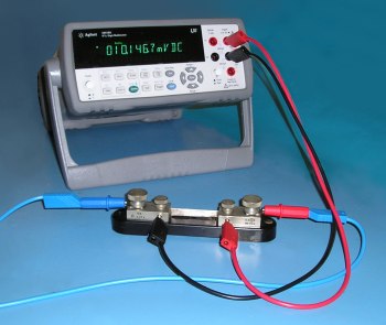

The Hall-effect sensor is probably your simplest current-measuring solution, but you need to explicitly define what you are trying to DO. Take a look at the Allegro ACS723 for a sensor more closely matching your anticipated current range. The most precise current measuring techniques use a four-wire Kelvin measurement. The so-called "shunt" or current measuring resistor has two heavy-gauge wires to carry the current to a precision low-resistance element and two small-gauge wires to measure the voltage drop across the resistance element. Depending on current rating, these devices have fairly low current-to-voltage sensitivities on the order of a few millivolts per ampere. Below is an image of a typical Kelvin current measurement using a precision measuring resistor:
The two inner terminals with the red and black test leads are precisely located at two points on the low-resistance "shunt" bar to allow measurement of the voltage drop across this element when current is present in the two blue test leads. Note the blue leads do not appear to be "heavy" enough to handle the maximum possible current the device is capable of supporting, but the measurement will nevertheless be accurate regardless of the resistance presented in series with the load by the blue test leads because very little of that measured current will be "burdened" by the high input impedance of the digital voltmeter.
The Arduino ADC is very limited in accuracy and resolution, but these are relative terms. You need to determine what accuracy and resolution you require before deciding an Arduino is the solution. For example, it is moderately easy to interface the digital ports of an Arduino to an external ADC that does meet your requirements, but you first have to define those requirements.
Calculating the resistance of the current-measuring shunt depends on how much of a burden this device will place on your solar cell. For example, if the solar cell can produce 5 A of current with 0.5 V output, then its internal resistance is R = V / I = 0.5 / 5 = 0.1 ohm or 100 mΩ. A shunt with a resistance of 0.01 or 0.001 ohms might be appropriate, and this will provide a "full scale" output of V = I x R = 50 mV (for 0.01 ohms) or 5 mV (for 0.001 ohms). Clearly some amplification is necessary to match this low range of voltage output to the chosen ADC input range.
Another problem might be how you choose to "short circuit" the solar cell array output. MOSFETs with low on-resistance are a possibility. A heavy-duty motor contactor is another. All depends on how much resistance you can tolerate in the "short circuit" path. Mercury-wetted relays might even be a possibility. In any case, you need to carefully measure the solar cell output voltage when it is "shorted" to determine if the "short" is good enough for your purposes (which you haven't told us).

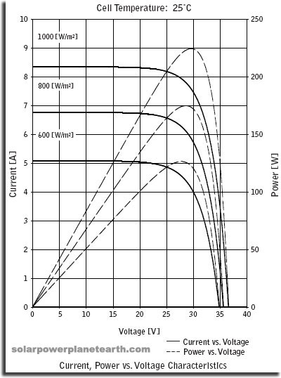

Probably the point of interest in comparing the "efficiency" of solar cells is the maximum power point of a particular cell, Pmax. The figure below plots solar cell current against solar cell voltage with the maximum power point indicated. This curve cannot be obtained with just two measurements of open-circuit voltage and short-circuit current, nor is it easy to determine by inspection where the maximum power point occurs.
The second set of curves, shown below, plots the V-I characteristic curve for three different levels of illumination and also the power produced (dashed lines). Clearly the maximum power peak not only increases with increasing illumination, but the cell voltage where maximum power occurs also increases (slightly). A constant-voltage power supply capable of sinking the solar cell current is typically used to obtain the V-I characteristic curve, while differentiation of the the VI product will yield the maximum power point when the first derivative of the power curve is zero.
It seems reasonable to me that when comparing solar cells under identical uniform lighting conditions, temperature and known "fill factors" you would judge the cell with the greatest peak power output to be superior to cells with lesser output. And it may be possible to forego obtaining the complete V-I characteristic curve to do obtain a valid comparison if the cells are sufficiently similar, but I think that would be bad science. especially if there are substantial differences among the cell constructions. There is a short discussion found here, from which I copied the two graphs above.
The curves shown above apply only to a particular cell. To obtain a valid comparison among a group of cells, each cell in the group would need to have a V-I curve obtained and the maximum power point for that cell determined from the V-I data. Using an arbitrary fraction of the open-circuit cell voltage to "compute" the maximum power point is, IMHO, not a valid way to compute the maximum power point. Your mileage (or kilometers) may differ. And a two-point measurement of short-circuit current and open-circuit voltage may be "good enough" for sales advertising purposes.
