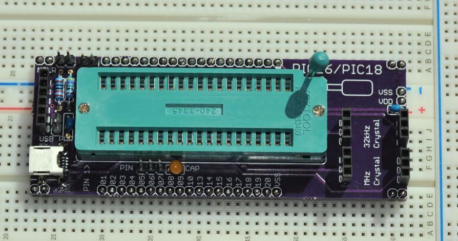

ZIF sockets are absolutely the best. The only drawback, they don't go well into the breadboard, so intermediary PCB is needed for breadboarding.

Thanks for the ideas. I have a ZIF for one of my PIC programmers but did not consider them for the final circuit. Might be pricey?
Regarding "Machined Contacts" do you mean the circular ones? I know there are "side wipe" ones that seem more like spring contacts. Is this what you mean?
