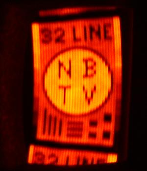

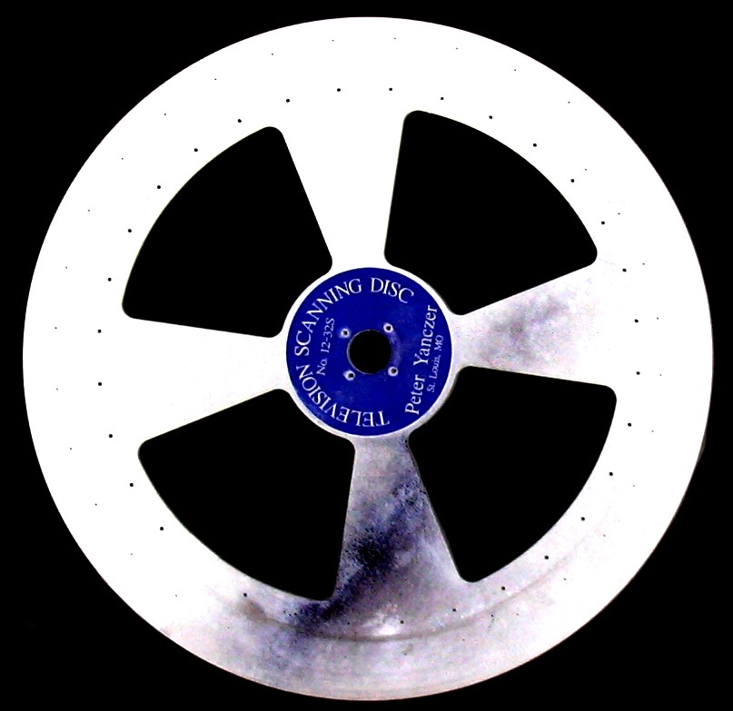

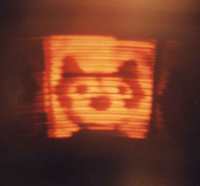

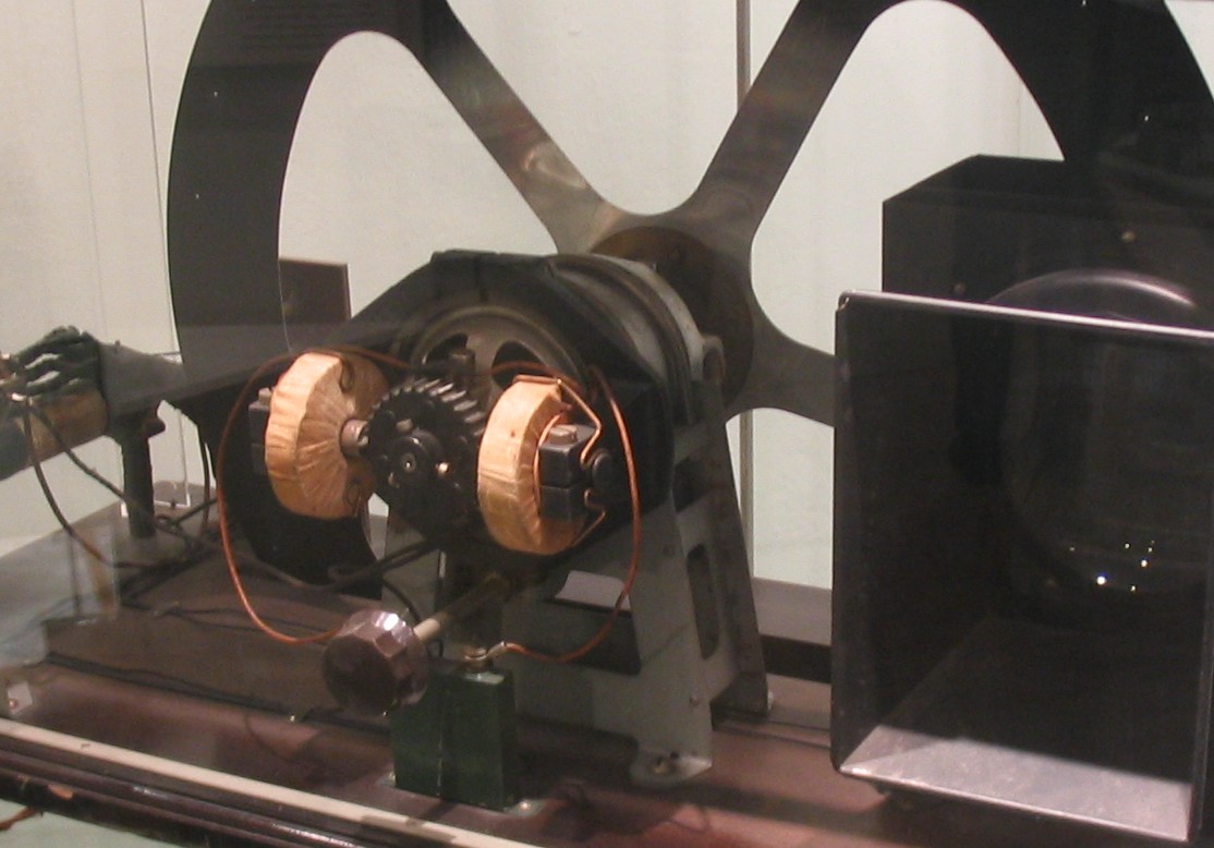

I saw an article out of a magazine from 1928 that teaches you how to build your own mechanical TV receiver, which is compatible with a standard MW broadcast receiver and SW amateur receiver by simply adding in some gain stages after the dector tube and connecting the output of the power gain stage you added to a light bulb and then the light bulb flashes on and off instead of a speaker cone moving in and out from the rectified amplitude modulations and the light bulb flashes on and off at different intensities and the light bulb flashing on and off is synchronized with each flash is a scan line and a complete picture is 48 scan lines at 7.5 frames per second and these scan lines are created by a fan motor spinning a plastic disc that has one hole cut in it for each scan line and the disc spins at a speed that creates 8 frames per second. It uses 5khz bandwidth on a standard SW receiver for the video component and the audio component is received on a standard MW receiver.
http://en.wikipedia.org/wiki/WRNY_(defunct)
So the video component of mechanical TV used simple amplitude modulation that is compatible with existing radio receivers, while the electronic TV uses quadrature amplitude modulation that is not compatible with existing radio receivers and requires a separate receiver for the TV.
So we had a mechanical to electronic transition in 1935, and we had an analog to digital transition in 2009 (in U.S.).
So radio amateurs using electronic television in the SW band at the frequency allotted for the amateur station would have to custom build a SW QAM transceiver which could be connected with a coax to the antenna connection of an existing TV and have the TV tuned to channel 3 and use the custom SQ QAM transceiver to change the channel instead of using the channel tuning controls on the TV, correct?
Funny thing is, looking at the Wikipedia article for picturephone and the links it provides, in 1928 when mechanical television broadcasts began in the U.S. as an experimental technology, magazines said that television was not suitable for the masses and said that television was only suitable for the amateur radio operator, at the same time that AT&T was furiously trying to develop a video phone and AT&T said that the video phone would replace the telephone.
