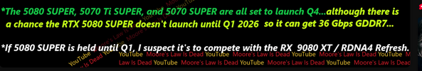

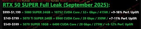

Tomorrow I will get a USB Hub Controller, let me see if that helps. I am also saving money every month to purchase a new GPU. I am thinking about an RTX 5ß80 Super. I am also thinking that a new GPU with photonics. This will reduce the power consumption as it replaces copper connection beween functions in the CPU chip made with copper today that are the places where a lot of power is consumed on the chip. But those might be available by 27.
