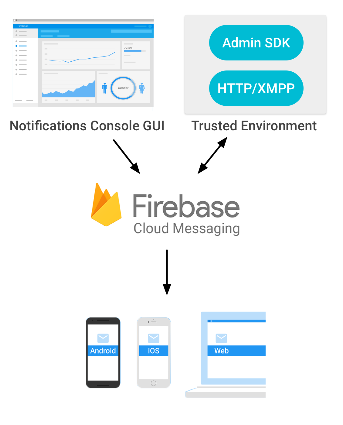

The FCM implementation includes two main parts for sending and receiving:
1. A trusted environment, such as Cloud Functions for Firebase or an application server for building, locating, and sending messages.
2. Receive iOS, Android or Web (JavaScript) client applications for messages.
You can use Admin SDK or HTTP&XMPP API to send messages.To test or send marketing or engagement messages with powerful built-in targeting and analytics, you can also useNotifications composer

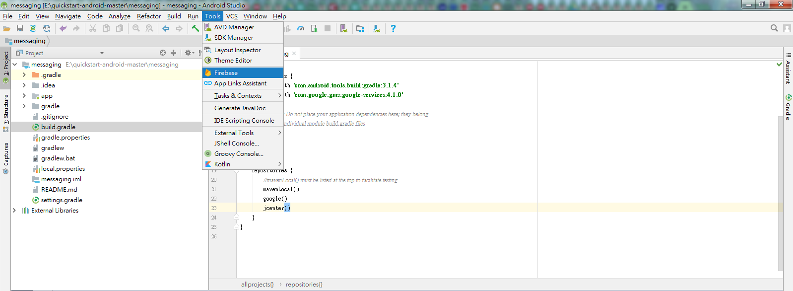

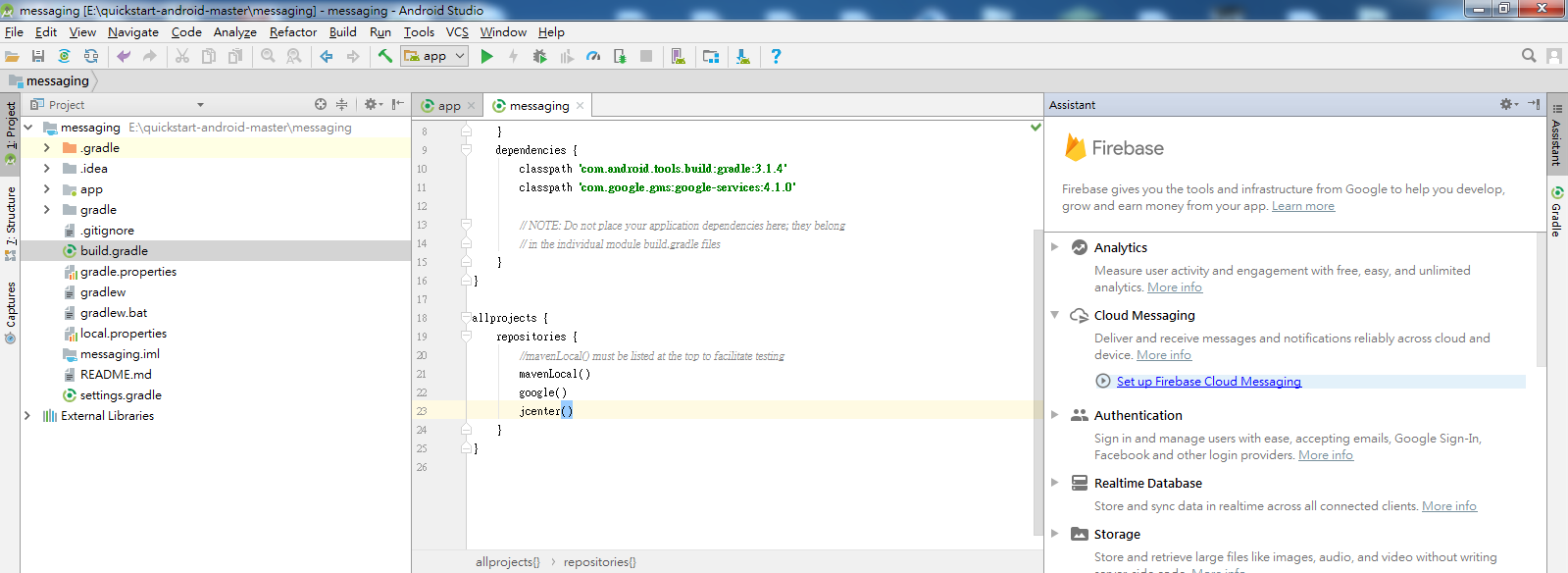

Wait until the required components for compiling the app are installed, you can open the messaging project, and Android Studio comes with the Firebase registration function.

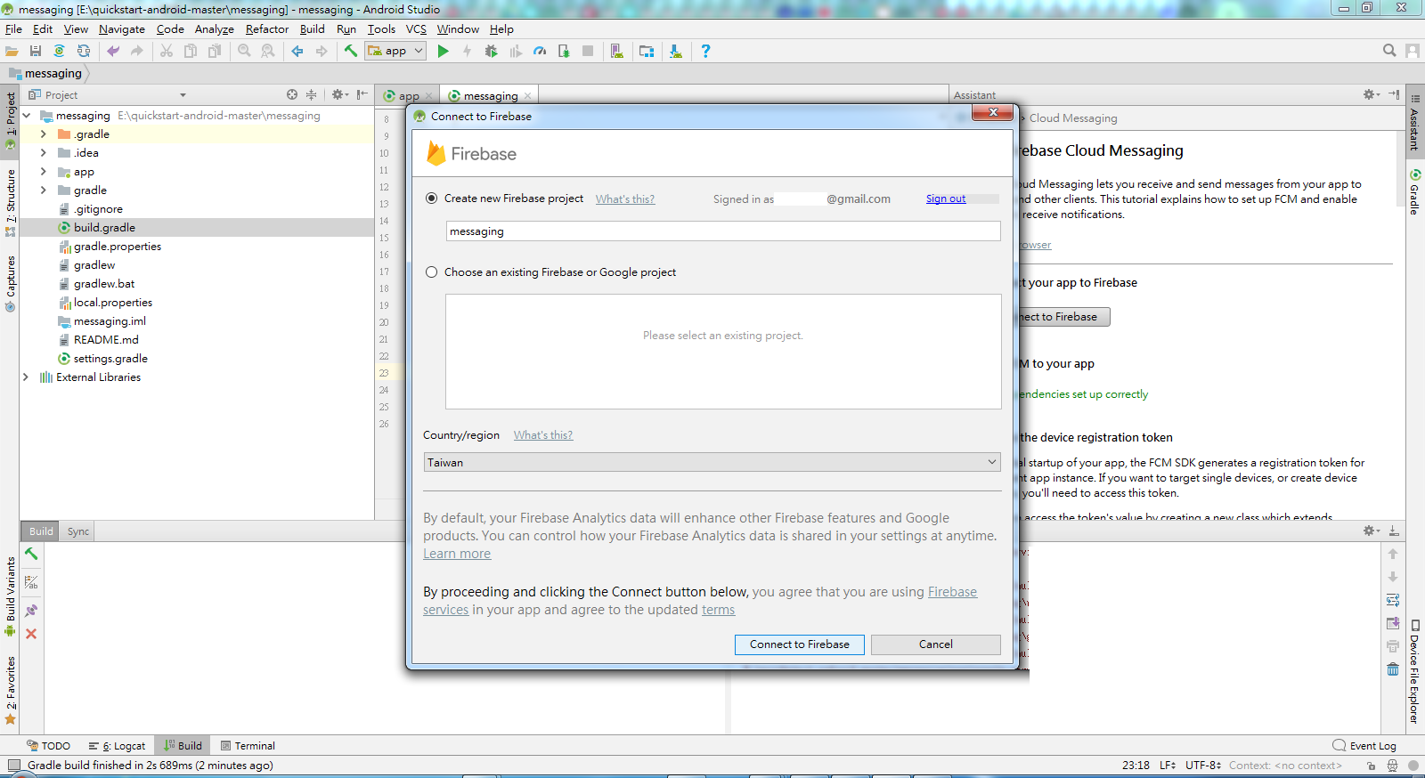

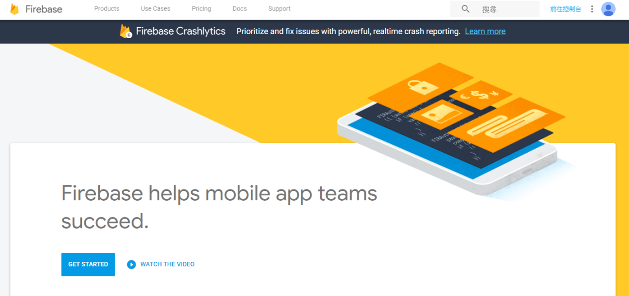

As shown above, open the toolbar and click Tools->Select Firebase.

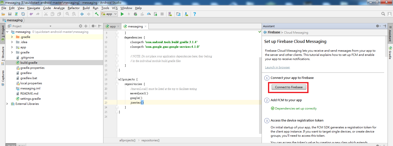

Open Firebase Assisant in the right pane, then see Cloud Messaging, select Set up Firebase Cloud Messaging to start the registration process.

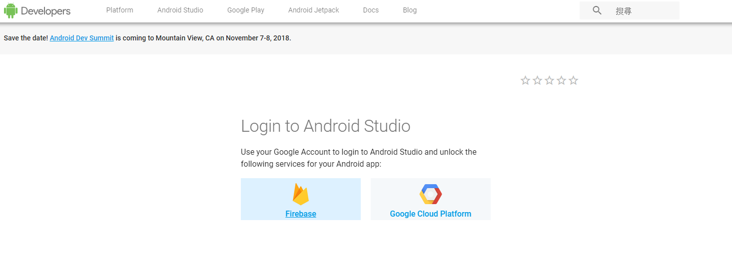

Click Connect to Firebase
Then bring out the page, and click on Firebase on the left and log in to the Gmail account. Once you log in, you will be taken to the Firebase homepage.
Let's keep the homepage first, we need to go to the Firebase Console and go back to Android Studio.
We can see that when the webpage is successfully logged in, Android Studio also brings up the login information dialog box, click connect to Firebase

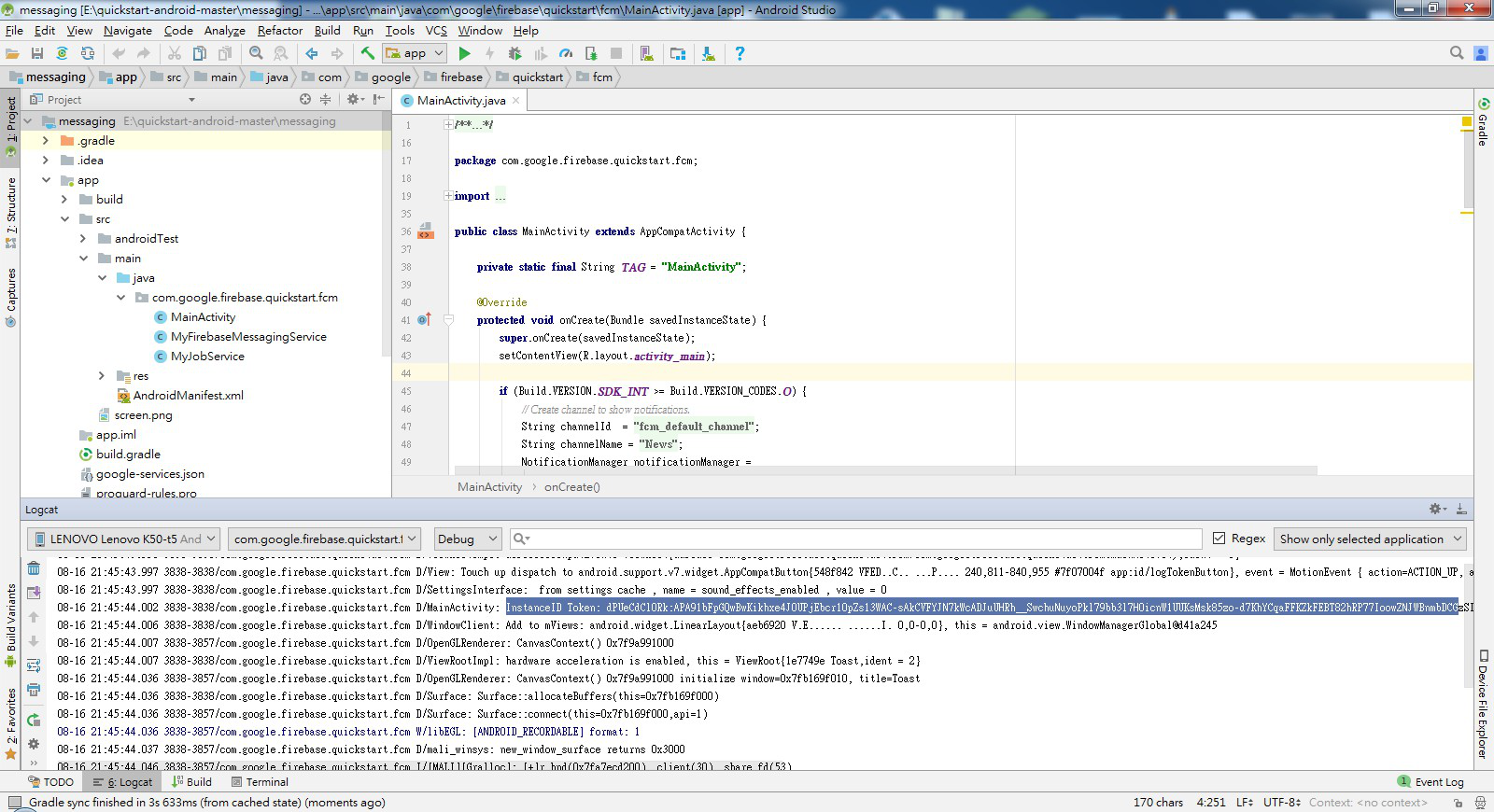

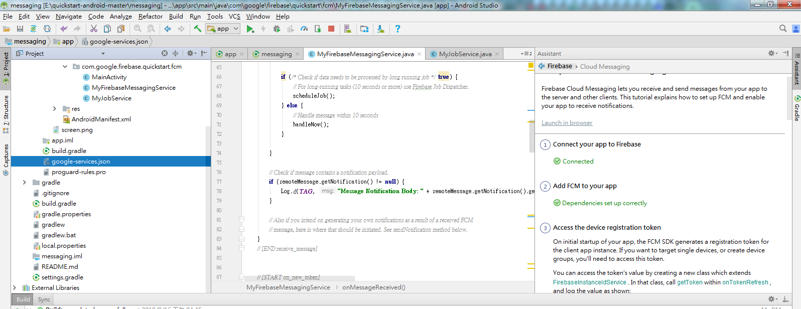

You can see Dependencies set up correctly in the right pane and see a google-service.json file in the left pane, indicating that the app has been registered successfully.

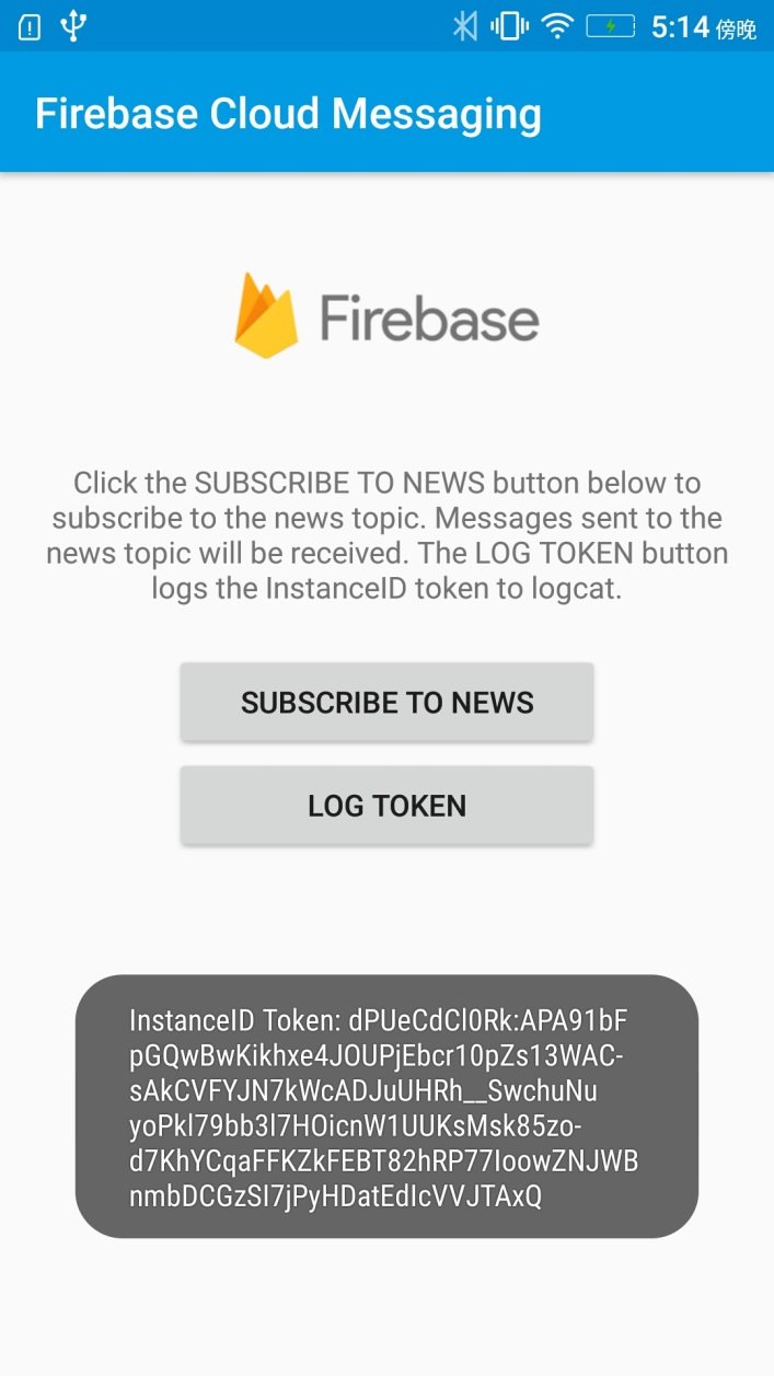

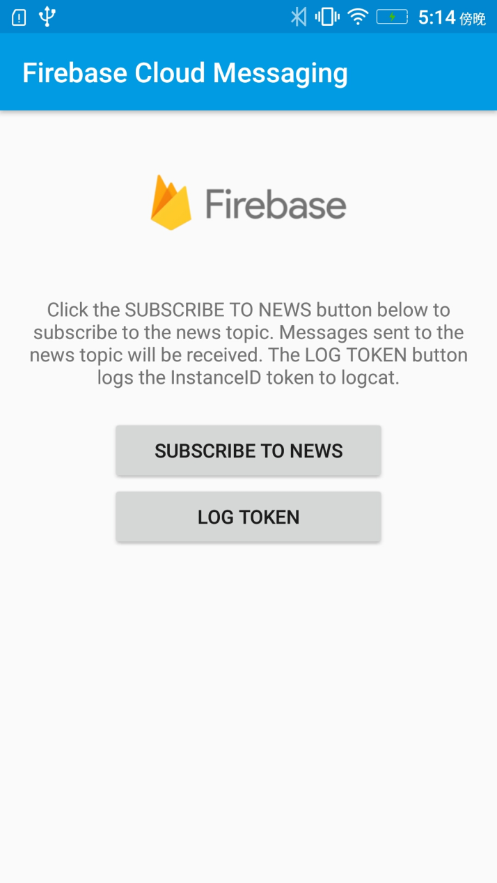

At this point, you can connect your phone to your computer (press Shift+F10) or press the Runs App in the toolbar. Please note here that Firebase requires a mobile phone to provide Google play service (GPS) service. An example of not being able to use Firebase without installing Google Play.
As shown above, the messaging app is installed and executed successfully on the phone. Click LOG TOKEN at this time.
There will be a Token ID, which is the Access Token required to send the message, representing the ID of the FCM service APP installed on a particular phone. This ID is unique and will be reassigned when the app is removed and re-installed. It means that the message can be sent to a specific phone. The FCM service can also push messages to a NEWS (Topic). This section can be found in Firebase topic-messaging:

Therefore, we need to save this Access Token, return to Android Studio as shown below, select Debug at the log level of the Logcat. When you press the LOG TOKEN button on the App, Logcat will print out the Access Token ID. We will save the code after the InstanceID Token: in the Log message.

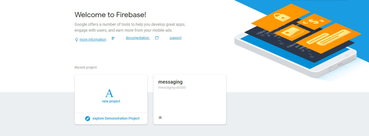

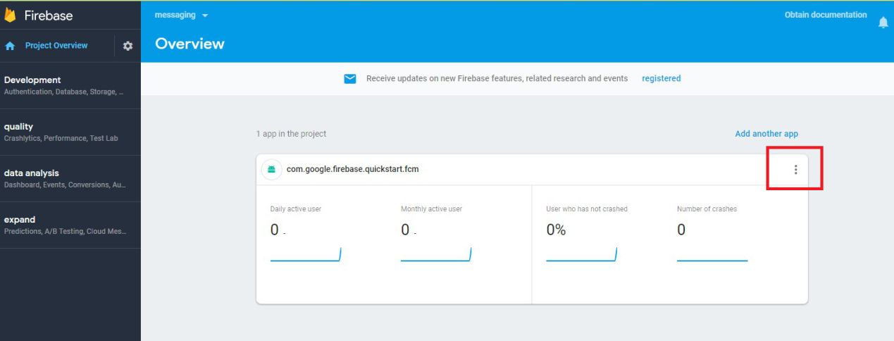

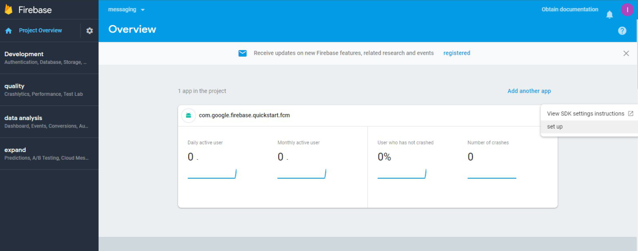

Then we have to go back to the page that was brought when we first logged into Firebase.
Click in the upper right corner to go to the console
At this point, You can see that Android Studio has just built the messaging project for us in the operation.
Click to enter the messaging project with settings page, as shown above.
Select Set up

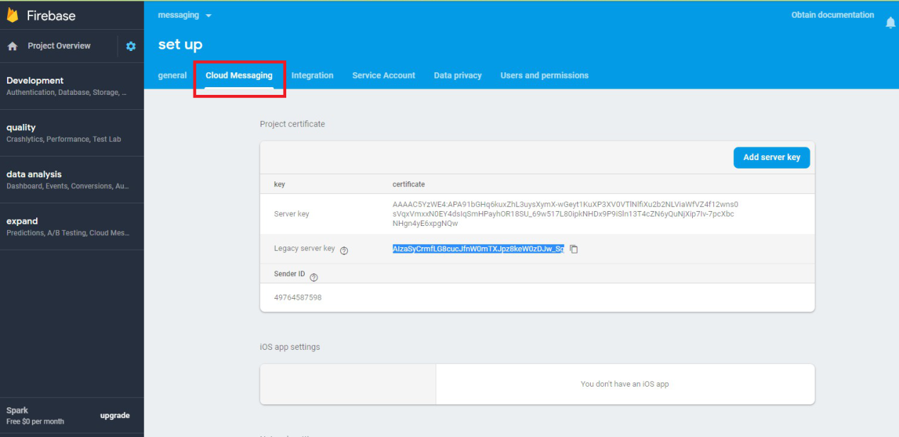

Go to the Settings page and select the Cloud Messaging page. We will see the Legacy server key. This Server key also needs to be used in the program. Let's save it and start editing the code.

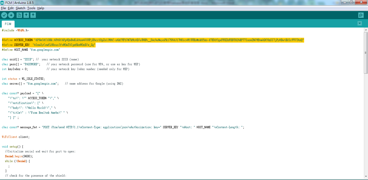

Open the example "File" -> "Examples" -> "AmebaWiFi" -> "Firebase.ino"
As shown above, ACCESS_TOKEN and SERVER_KEY are defined in the reverse white part, that is, the ACCESS token ID that we just saved from the APP and the Server Key saved in the Firebase console page. We fill in the two sets of IDs, compile and upload them to Ameba. Press the Reset button and open the terminal.

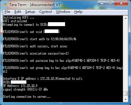

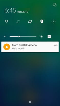

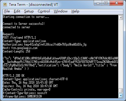

Connect to FCM Server after connecting to AP
After showing Connect to Server successful, it means that the FCM connection is successful and the message will be sent. During the process, HTTP/1.1 200 OK will be received to indicate that the message is successfully pushed. At this time, the mobile phone screen is opened and the App receives the message from Ameba.

The sprintf part puts the payload into the HTTP POST content and sends the message out after connecting to the FCM Server.
loop()
while (client.available()) {
char c = client.read();
Serial.write(c);
Waiting for the response from Server and printing out the response
