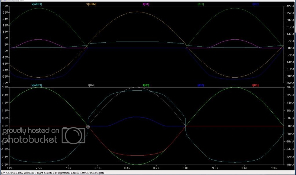

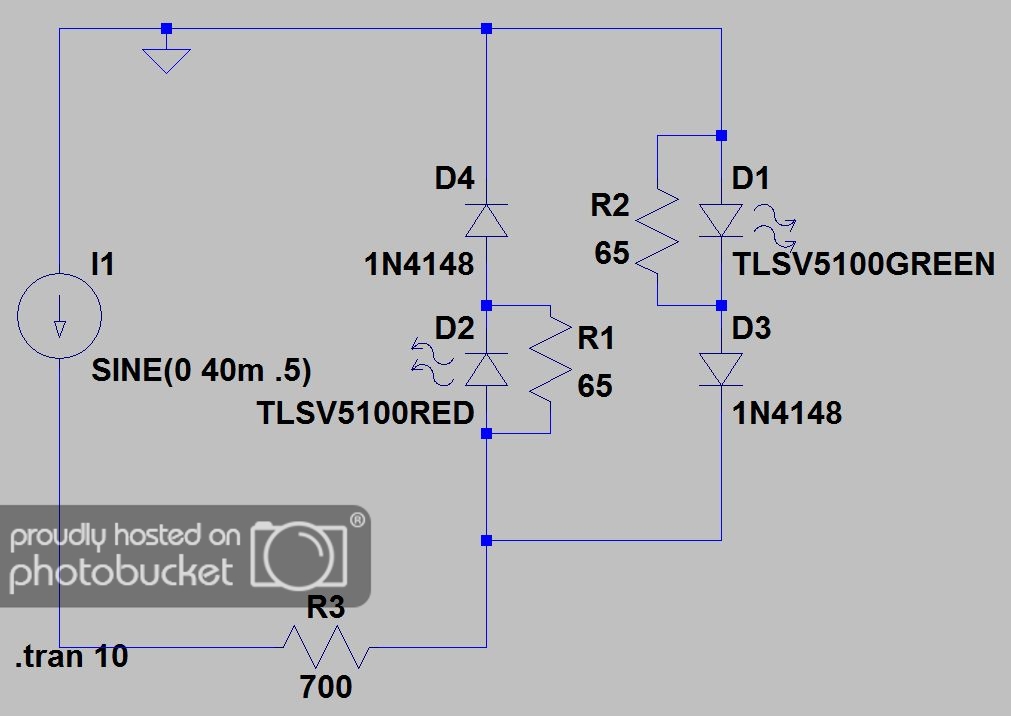

All,
I'm using this 555 based polarity switching circuit as my base:
https://www.electronicspoint.com/555-timer-reverse-polarity-circuit-t250411.html
My supply is 30V DC so I'm using a DPDT relay to switch the legs. I'd like to put LEDs in the actual legs to show that everything is truly working.
I've attached what I'm trying and would like constructive
comments.
D1, D2 - reverse breakdown voltage is 4V
D3, D4 - reverse breakdown voltage is 3.6V
I put the zeners in there thinking that they would "protect" the other leds. Is this necessary?
thanks,
dave
