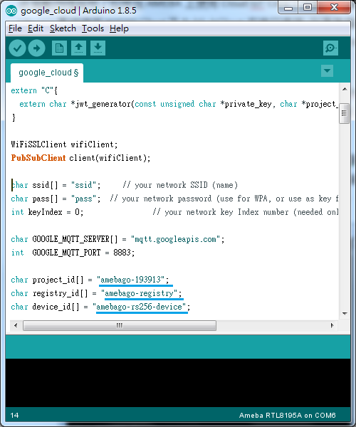

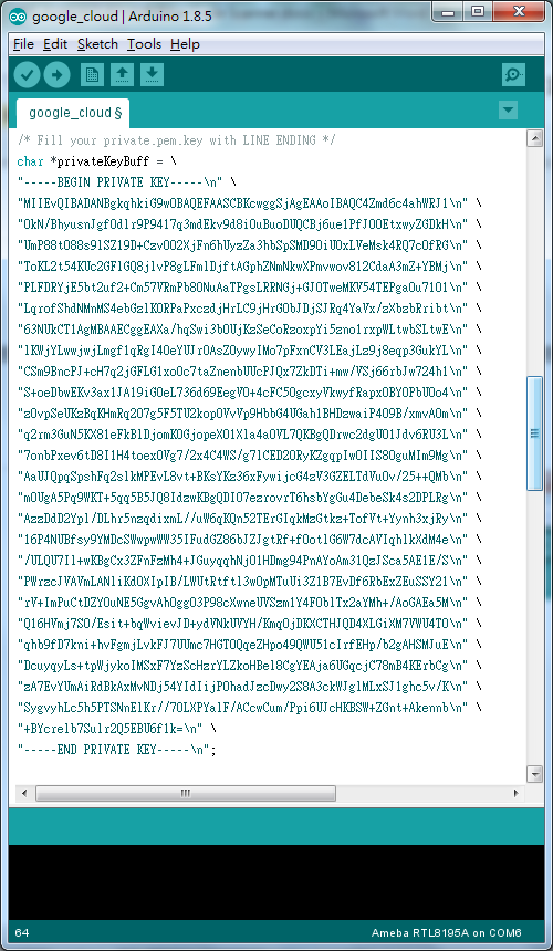

Open the example “File” -> “Examples” -> “AmebaMQTTClient” -> “google_cloud”, we can get project_id, registry_id, device_id and private.pem.key if Google Cloud IoT Platform has been set up. In the example, fill in amebago-193913 for project_id, amebago-registry for registry_id and amebago-rs256-device for device_id as follows. Remember to fill in private.pem.key for privateKeyBuff. Compile and download to Ameba after updating these parameters.

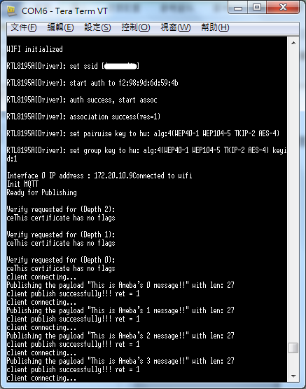

Then open the terminal, start to connect to Google Cloud and it shows ” This is Ameba's x message!!” when the connection is successful as follows. The "x" is the increment value for each loop.

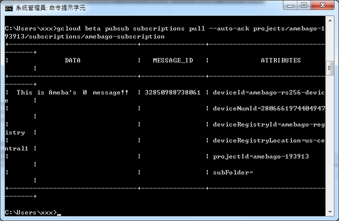

Verify:
Key in with Google Cloud SDK Shell:
$ gcloud beta pubsub subscriptions pull --auto-ack \
projects/amebago-193913/subscriptions/amebago-subscription
The following are the messages sent by Ameba.
