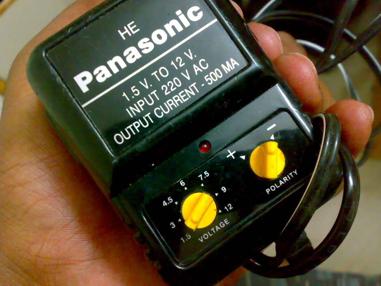

barathbushan
Sep 26, 2009
223
Sep 26, 2009
223
Wall mart's are good for beginners in electronics , but nothing can beat your self made power supply !!!
But if you dont want to build your supply , you can try this , it was really helpful when i started out .
It also has got "SHORT CIRCUIT PROTECTION"
