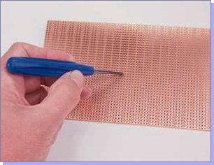

In need of a tool to cut the tracks of my veroboards, I have bought this pen. It accepts noses composed of many glass fibers and works as a brush. I have been unable to break a single track, with much brushing I have managed to break two or three adjacent tracks. And by that time everything in a 5 dot radius was badly scratched. Not to mention the loose fibers piercing my fingertips, adding to my frustration.
1) What is the "proper/formal" name of this devilish device? So that I may perform searches in Google.
2) Any suggestions on how to use it? Any clues? Links to tutorials?
3) Does anybody have another tool to suggest?
Thank you very much.

Hi Autir,
I have used a lot of Veroboard for many years and have never seen the "brushing tool" you have. I purchased from Vero a handtool which was a drill bit in a wooden or plastic handle, called a "spot face-cutter". Most of the time I use my drillpress to cut the copper tracks. If the drill bit is dull (it gets dull quickly when cutting epoxy-fiberglass Veroboard) or you drill too deep then it leaves small pieces of copper sticking up around the cuts and bridging the tracks.
I don't think Veroboard exists anymore. For a few years I have been using good Chinese copies. Cheap copies are phenolic which is paper mush with glue. It warps with time and its copper is thin and doesn't stick very well. I always use epoxy-fiberglass Veroboard or the copy of it called "stripboard". ;D

By the name "veroboard" I was referring to the type of the board, not a specific brand. What is the difference, if any, between a veroboard and a stripboard?

Veroboard is a name-brand and its good quality is well known. Stripboard copies could be bad like the one made in Taiwan that smells like it is made of dung.
RadioShack had a type of stripboard made of cheap phenolic and with very thin copper. Its holes were too big for most parts leaving the remaining copper around them very narrow. ;D

That brush he is talking about reminds me of the fiber glass pen brushes used to spot remove the protective covering that comes on commercial boards. They can be usefull when working on somthing with small connections that has been sealed after construction. (Like a motherboard...)

I know there are some Greeks among the members of this forum.
Can anyone please tell me where I can find a Strip Board Cutter
or something similar in Athens?
