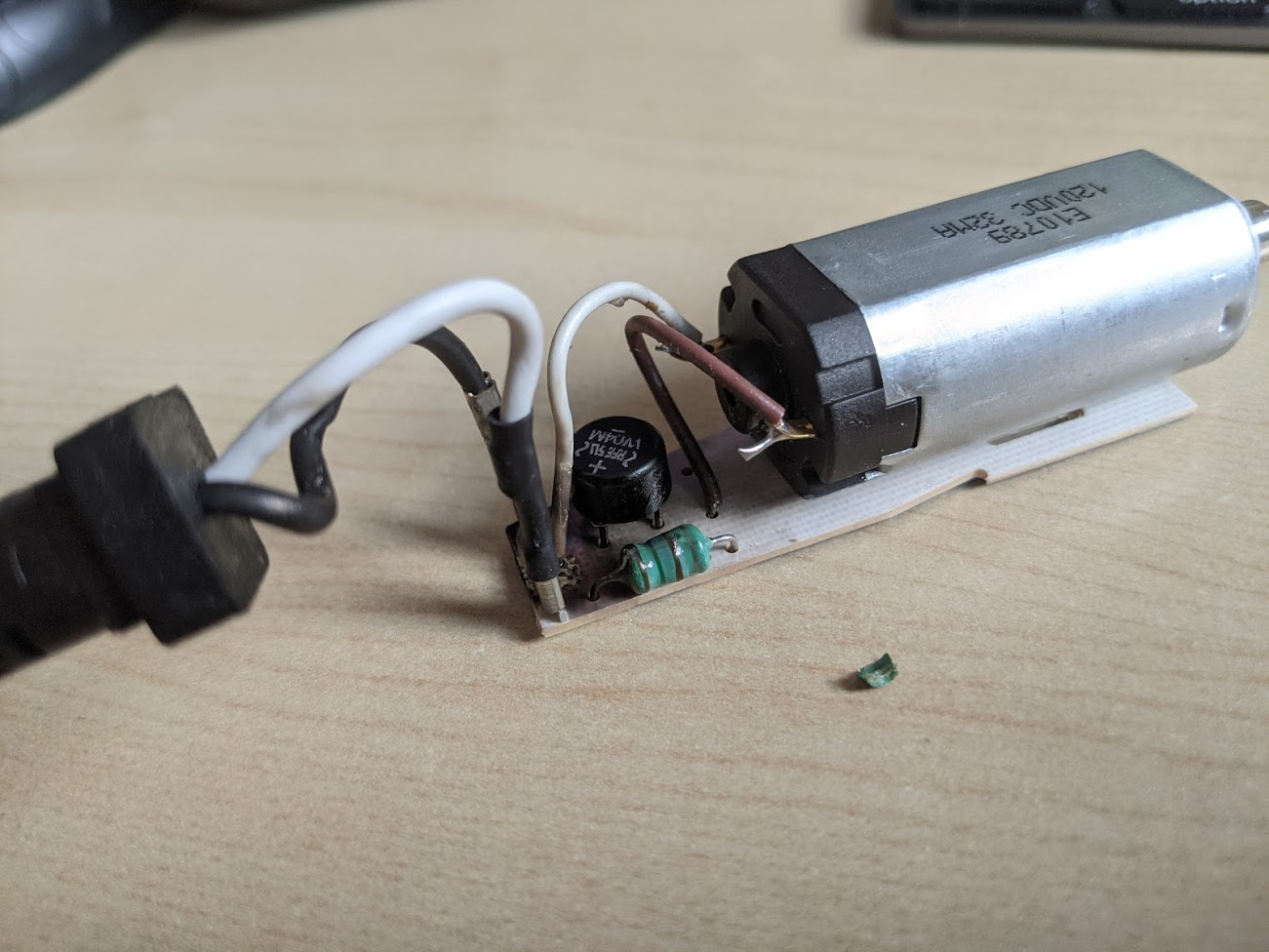

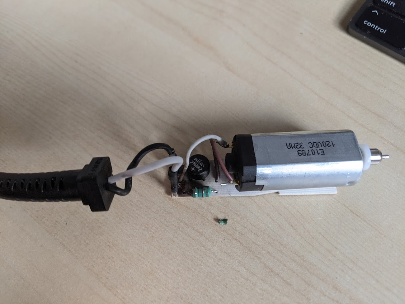

In a moment of naïveté I had basically the exact same experience today.
Got an instant 'pop' sound and sudden feeling of being an idiot :)
I was able to disassemble my Peanut, here's what we've got:
This thing is the 'low end' model of the Wahl lineup, as I understand it.
If I had a voltmeter, how might I confirm the thing is FUBAR or not?
I'm not sure but I'm not seeing an obvious fuse, at least I don't think so (is the black round bit a capacitor?)
The green resistor has clearly seen better days, and I suppose it needs to be replaced, assuming it's possible to repair.

test the motor with a source of power, it might be the motor thats dead?

The motor doesn't seem to have a rating on it. Is there a way to deduce its expected amperage based on the bridge rectifier?
UPDATE:
I checked the housing of the unit and it revealed 3W.
Seems I'm on the hunt now for some appropriate power source that can do 120V @ 3 Amps.
Don't have a lot of experience working with AC - what might be a reasonable way to power this for testing purposes?

I think I misspoke before - 3W @ 120V should be, if my math is right, 0.025 Amps. (P = IV)
If possible I'd prefer to test with non-mains source, e.g. an inverter hooked up to some batteries maybe. Is that viable you think?
There's also an electronics shop nearby with a workbench intended for customers. I've soldered there before - wondering if there might be some kind of power supply product I could ask to borrow? What would it be called?
In the meantime this is what I got when I looked up the resistor details. (if I understand right the resistor seems quite likely to need replacing)

The printing on the motor states 120 V DC , 32 mA. 120 V DC is not just "any power source".
The resistor has blown some of the insulation. It is probably open circuit now. Try to identify the original colors and find a replacement. I see you have done so. If you're confident about your readings, get a 150 Ω resistor for replacement. Wattage should be 1/2 W or higher.
The bridge rectifier can easily be checked with a multimeter with a diode testing range. Just check all four diodes for correct operation.
The motor can be tested by verifying at least that is is not open circuit. It should show a resistance somewhere in the low kΩ range.

I had this same issue. I plugged it straight into the 220v outlet. When I turned it on it ran like a raped ape for 1/2 second and popped. The issue with mine was the resistor had blown. The resistor was a 150ohm with 10% tolerance. Hope this helps.
