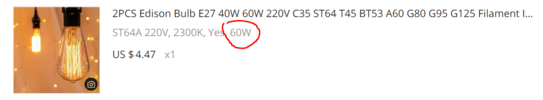

Hi,
I purchased couple Edison lamps from aliexpress @60W.
Then I connected it in series with this working Dell PSU, and I shorted the green pin with the black one so that PSU launches.
But the PSU didn't launch and the lamp is flickering slowly; like, 1 flicker every 1 second.
I measured the impedance of the PSU and the lamp, the PSU is 1M ohms and the lamp is 178 ohms. So what is the explanation of this action ? I doubted that the seller shipped me a 60W lamp.

If you use an incandescent light bulb not an "LED light bulb" on the output of a power supply for a load then you must realize the low cold resistance results in an inrush current spike and can trigger over current protection circuits in the power supply unit under test.

Hello,
You likely bought a ledlamp with a brightness of about an 60 Watt incandescent lamp.
The power will be around 6 Watts.
