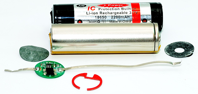

What kind battery is use in cordless power tool, the battery look like 18650 battery.
Are they 18650 battery unprotected type battery or protected type?
Are there high drain battery?

That is unanswerable with the little info you have given
It would depend on the manufacturer to what they chose to use

The 18650 is not a battery, it is a lithium cell that when using multiple wired in a pack become a battery. A lithium battery is usually protected; has circuitry that prevents mishaps and abuse in charging and discharging. When such circuitry is implemented, cells do not need to be individually protected also.
Individual cells that do not work as part of a battery pack can be of the protected type. There is both types of 18650 cells. High drain is achieved by connecting several cells in series/parallel.
----> https://lygte-info.dk/info/battery protection UK.html

Manufacturers of tools with user-replaceable individual cells, could go either way, placing the burden on the owner to use a protected cell, or building in a protection circuit into the tool.
Tools that don't have user-replaceable individual cells, instead integrated into a battery housing, generally use unprotected cells, but with a BMS circuit in series that provides for overdischarge protection, overcharge protection, balance charging, and often thermal protection.
If you gave us a bit more context of why you are asking or a link to a particular tool, it would be easier to determine.
