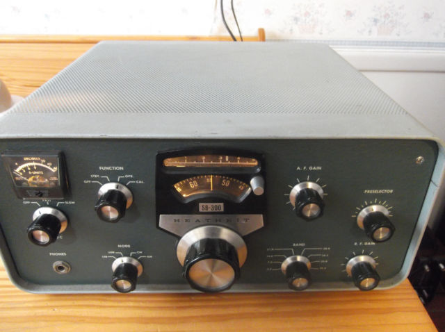

I had a LOT of time on my hands during off-duty hours, and I was anxious to get started in amateur radio. I couldn't afford a Collins "rig" which was the "top-of-the-line" equipment in 1966, so I settled for an almost "look alike" Heathkit SB-300 receiver kit:
I was barely able to afford this kit on my A2C monthly salary. And there was no money left over to purchase a transmitter. So, after putting the receiver kit together, and with the help of a few friends (and permission from the first sergeant) we erected an 80m dipole antenna about ten feet above and parallel with the gravel-and-tar roof of our barracks. I found a spool of "practically new" coaxial cable tucked away in a corner of our Armament and Electronics (A&E) maintenance shop. Using an oscilloscope and a pulse generator, along with a variable 100 ohm potentiometer connected across one end of the coax, I determined that the coaxial cable characteristic impedance was 50Ω. Voila! My first sergeant determined that the spool of coax was "surplus" to our shop's current needs and allowed me to remove it to the barracks and install it between my ground-floor room and the roof antenna some three stories higher. So after a few months of labor I was now "on the air" as a short-wave listener (SWL) and could practice receiving CW transmissions by real amateur radio operators while I built a Novice transmitter.
