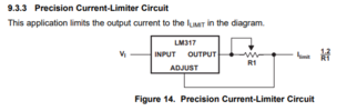

danadak
Feb 19, 2021
1,104
Feb 19, 2021
1,104
A quick and easy way is (each leg) :
Its short circuit protected, thermal protected, line ripple rejection,
can get in SOT package or TO220 or TO92 package. Also very
close leg matching current due to decent Vref accuracy and T
stability. Note min load current to stay in regulation is 10 mA.
Regards, Dana.
