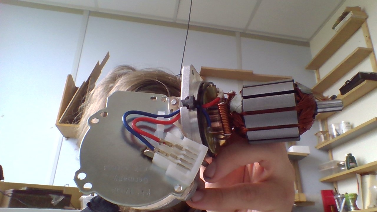

HI all, new to this forum as usually on diy stomp box forum, but I'm steadily moving further into mechanics and motors.
I just recieved a Febi 17092 windscreen wiper motor, rated at 12v and 40w. I need to use it for single direction continuos rotation and thought it's be simple enough to wire, obviously not as I'm here. I tried many different configurations, isolating the chassis/ground etc but still can't figure it out. If anyone could offer me advice I'd much appreciate it.
There is five pins on the plug, left is ground/chassis. red and blue wire connect to the motor (i'm assuming these are two different speeds). Thanks for your help

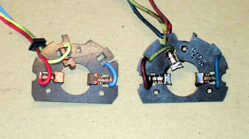

A common 2 sp wiper motor has three leads common, hi sp & low sp, the low speed is an offset brush on the commutator.
So one or the other is energised, not both.

So what I did was connect - to common, and tried applying + to the low or high speed but it just shorted, I tested continuity and it seems it's all connected unless I unscrew the brush plate from the chassis.

This shows the normal 2 sp brush set up where Blue is common, red is low speed and yellow is high speed.
M.

Thanks M, that's useful.
I'll re open motor on Wednesday when I'm back in my workshop and report back.
Edit*
In fact, let's see if I get this correct. As long as blue (common) is connected to - and red or yellow to + the motor should turn? And I figure I'll have to isolate the ground from the chassis? as if not there's continuity to both speeds. Writing that last sentence makes me think I'm missing something.

As long as mechanically there is no reason why you cannot run in reverse then polarity should not matter, but in a installation blue would be common or -ve.
A visual inspection of the brushes/connections should bring some enlightenment.

I only see two wires disappearing into the motor. Is there continuity from either or both of these wires to the motor frame? If so, then the frame is the return lead and either the red or blue leads control the motor speed, per @Minder's comment. At 40 watts and 12 V, this motor will draw in excess of 3A, more if heavily loaded or not rotating. Is your power supply capable of delivering three amperes or more at twelve volts? It would be normal to measure continuity between the red and blue wires, but if there is also continuity to the motor frame then you apply 12 V between the frame and either, but not both, red or blue wires. You say "it just shorted" when you tried this. Please tell us what this "short circuit" current is AND the power supply terminal voltage that occurs when this happens. I suspect your power source, if not a lead-acid battery, is not "stiff" enough to power this motor. Are you using a lead-acid battery or <gasp!> a wall wart to try to power this motor?

Yes there is continuity from both to the frame. So When I get an appropriate power supply, I apply - (return) to the frame and then + to either lead? Probably another gasp is going to appear here, I was going to see about controlling the speed via voltage control, by using LM317 variable regulator, however on another unit I've put together (much lighter motor) I've noticed these get very hot under load, so I'm assuming in this case I will need something more substantial?
