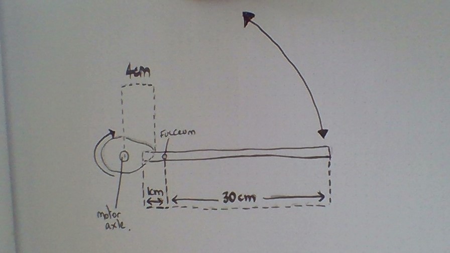

.. I intend on using the motor as in a dead lift scenario, 4cm cam off motor axle, lifting around 1.5kg off an arm around 30cm long, so it will be fairly heavily loaded. Not sure how to calculate this into amps needed, I'm in the middle of learning torque and torque conversion calculations at the minute, getting there slowly.
This is probably NOT going to work. The motor shaft will turn too quickly (hundreds if not thousands of RPM) to allow control of the cam. There IS a way to make it work by using pulse-width modulation to control the motor speed, but you are still looking at huge torque requirements to lift 1.5 kg at the end of a 30 cm lever arm with a 4 cm cam, even if the cam is located directly under the load. You don't specify what the total cam "lift" will be, or where that "lift" is applied to the 30 cm arm. A clean sketch using a black felt-tip marker on plain white paper, well lighted with no shadows, should be photographed and uploaded for our inspection and comments.
I fear you are going to need a geared motor for your lifting application. The windshield wiper gear box contains a worm gear driving a spur gear that in turn drives the reciprocating mechanism. The motor always runs in one direction, at two speeds, and the reciprocating mechanism may not appreciate being driven in reverse. It may jam if reversed. If possible, open the gear box and do your "power take-off" from the shaft of the main gear that is driven by the worm gear. Discard everything else. Or purchase a worm gear speed reducer box and adapt it to fit your motor. Or purchase a geared motor as others here have suggested. But do the torque and speed calculations first, then decide what you need or can adapt to your purpose.

In the mean time whilst I'm learning here is the requested diagram. A very simple yet demanding mechanism for my purpose, but just want a lift and drop mechanism that can replicate an arm lifting a staff and then dropping it, on a a resonant surface, it's for part of an installation I wish to have ready for 3 weeks time if at all possible. So yes, the automagical music beat is a wish. :-0

Ok so time to see if I've learned correctly, and see if I can work out how to calculate all of this.
First equation I think need to be the lever, to calculate force needed to lift 1.5g weight.
Fe = (1.5kg) (9.81 m/s2) (0.3m) / (0.02m)
= 22.07... N
In weight this will be (I hope):
fe = (1.5kg)(0.3m)/(0.02m)
=22.5kg
now I think I need to work out what what torque is required to lift 22.5kg off a 2cm cam. If this is correct, thinking about it this really puts into perspective how demanding this task is for the motor and electronics.
so I think the equation
need for this is:
t (Nm) = (mass)22.5kg x (gravity) 9.81m/s2 x (radius) 0.02m
t (Nm, newton meters) = 4.41
Is this correct? I need a motor that's capable of 4.41Nm (guess it's best to go higher than required)?

Your calculations for torque do not look right. The cam, operating at a 4 cm (0.04 m) radius applied to the short end of the 30:1 lever means a 1.5 kg mass applied at the long end of the lever will appear as a 45 kg weight for the cam to lift. This will require a force of 45 x 9.81 = 441 N. The cam rotating on a 4 cm radius will then max out at (441)(0.04) = 17 N m of torque or about 150 pound-inches. Of course these calculations assume the lever is horizontal and doesn't move through the arc you show on your sketch. The torque diminishes as the centerline of the weight moves closer to the fulcrum, becoming zero if the lever is vertical. The torque acting on the cam depends on the cam angle of rotation and cam profile, but let's not get into that right now...

HAAAAAAA yes I comply
Sorry Hevans, I wrote the radius of the cam incorrectly it should be 2cm.
Hmmmm, incorrect calculations, more learning to do.

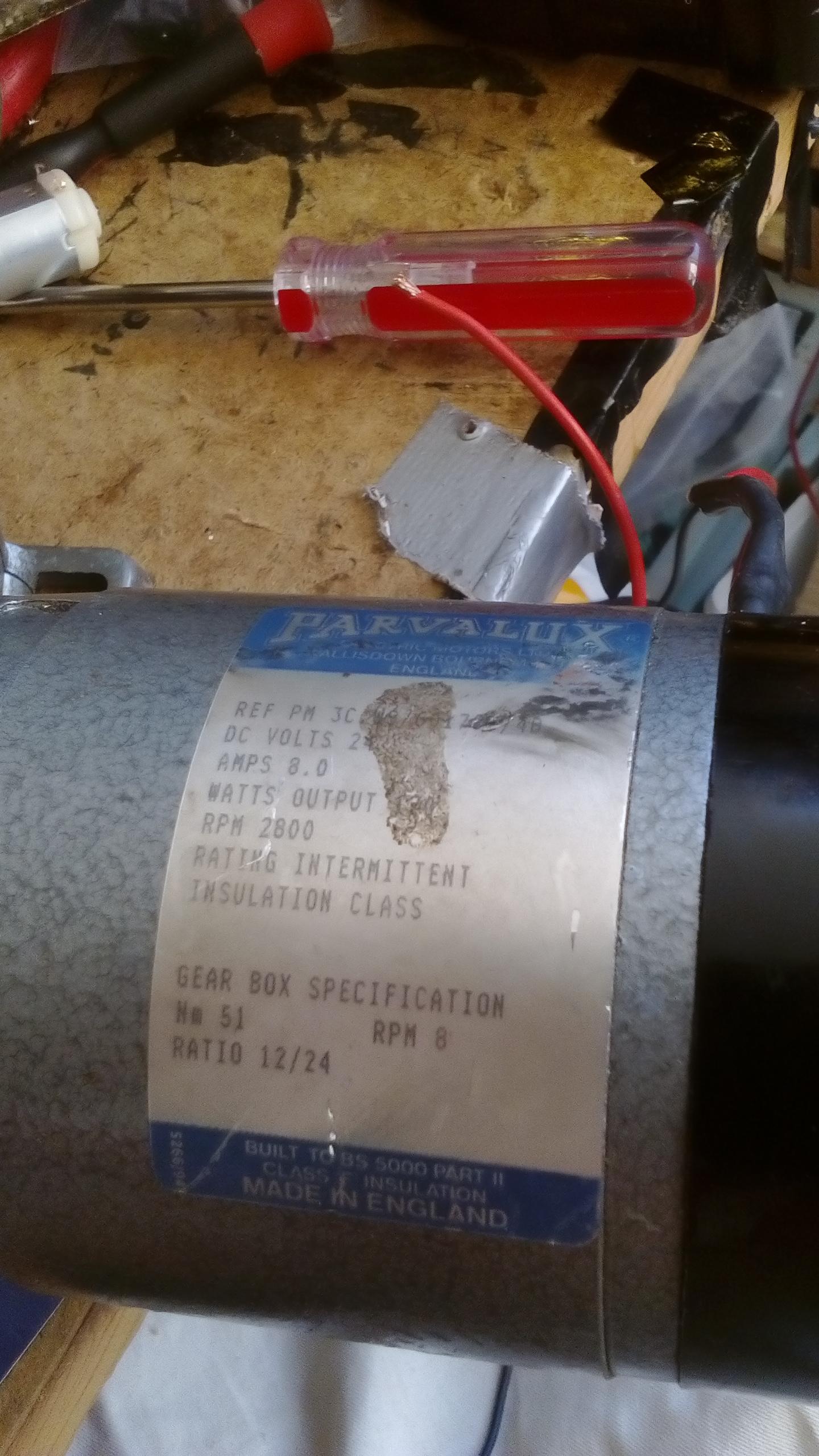

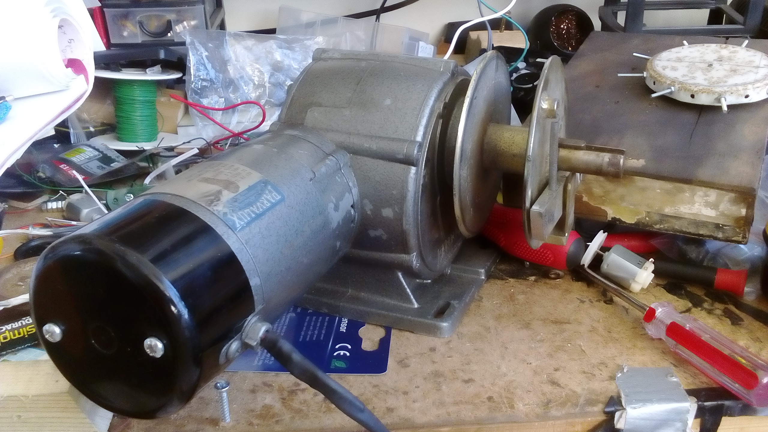

Mangaged to get the wiper motor working today, thanks all. It didn't cope to well with lifting what I needed and I think I over loaded the variable motor controller circuit, it got very hot. But it'll be a great motor for another mechanism. Now I bought another motor which I'm sure can handle the job, it's a Parvalux motor (I love how this motor looks)the label on it reads: dc 24v, amps 8, watts output I think reads 120w, rpm 2800, rating intermittent, insulation class. Gear box spec, Nm 51, rpm 8, ratio 12/24. I have posted images below. I am hoping to run this at 12v, will It still need the 8 amps? I've not worked on anything this heavy duty before, is it beyond my pay grade? Thanks for help.

That looks like a brushed DC motor rated for 24 V DC, rotating at 2800 RPM and driving a worm-gear right-angle speed reducer. I have no idea what the 12/24 ratio means. Maybe 12 teeth on the worm and 24 teeth on the output gear?
This motor will operate poorly with 12 V DC. Better to use 24 V DC (or more) and pulse-width modulate the current to achieve rated torque at a slower speed. Pretty good torque for your application... you might be able to drive that arm directly from the output shaft without a cam. One and a half kilograms at the end of a thirty centimeter arm requires only 4.2 N m of torque to lift it. So try it with 12 V DC excitation and see if it will do the job before spending money on a PWM controller.

The 12/24 almost implies it is dual ratio, on 12vdc it will run approximately half the rpm..
It is a strange looking GB, most likely worm and pinion, which are typically fairly high ratio.
With a motor stated at 2800rpm and the GB 8RPM implies a 350:1 GB??
Also intermittent duty on 24v, you should get longer operation on 12v if needed.
Remove that back cover, you may be able to move the shaft manually to find out.

The gear down is double staged..
At their nominal speed on the basic motor, if running at ~2800 RPM . . it initially gets dropped by÷12
down to `233 RPM then the second ÷ 24 gear down gets it down to ~9.7 RPM .
Then figure in any friction and loading down to end up at the spec of 8 RPM.
And with the hefty initial power consumption at the motor proper . . .then prepare yourself for one HELL of a lot or torque at the output shaft.

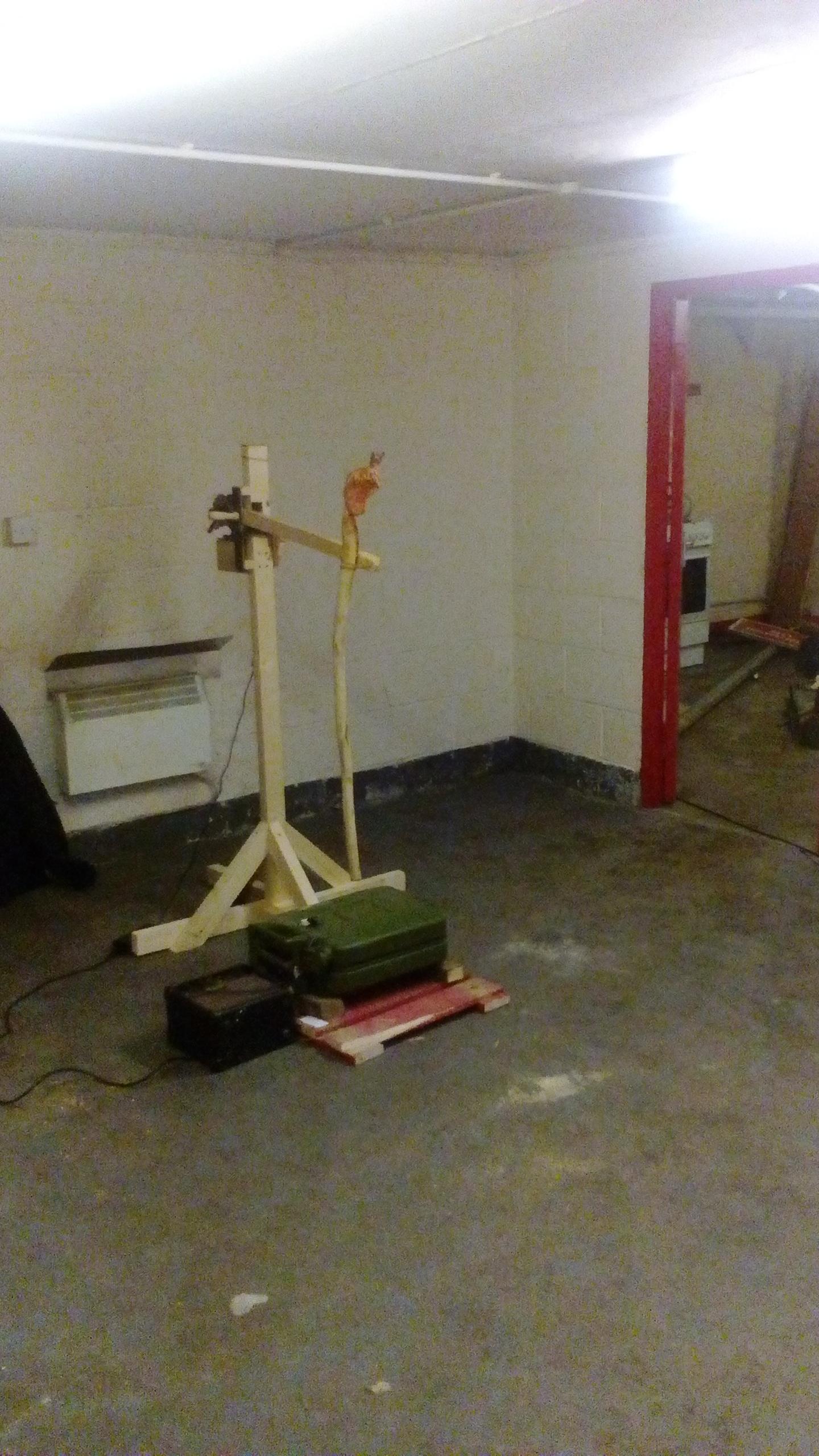

Hopefully when my power supply arrives it'll work without a glitch and then comes the construction phase, gonna have to be a hefty frame for this. Then hopefully I can post some pics of what it may look like!

Finally got it ready for the event. It worked great. Made a huge bang in the entrance when people opened the door. Thanks for all your advice. Lot's learned.
