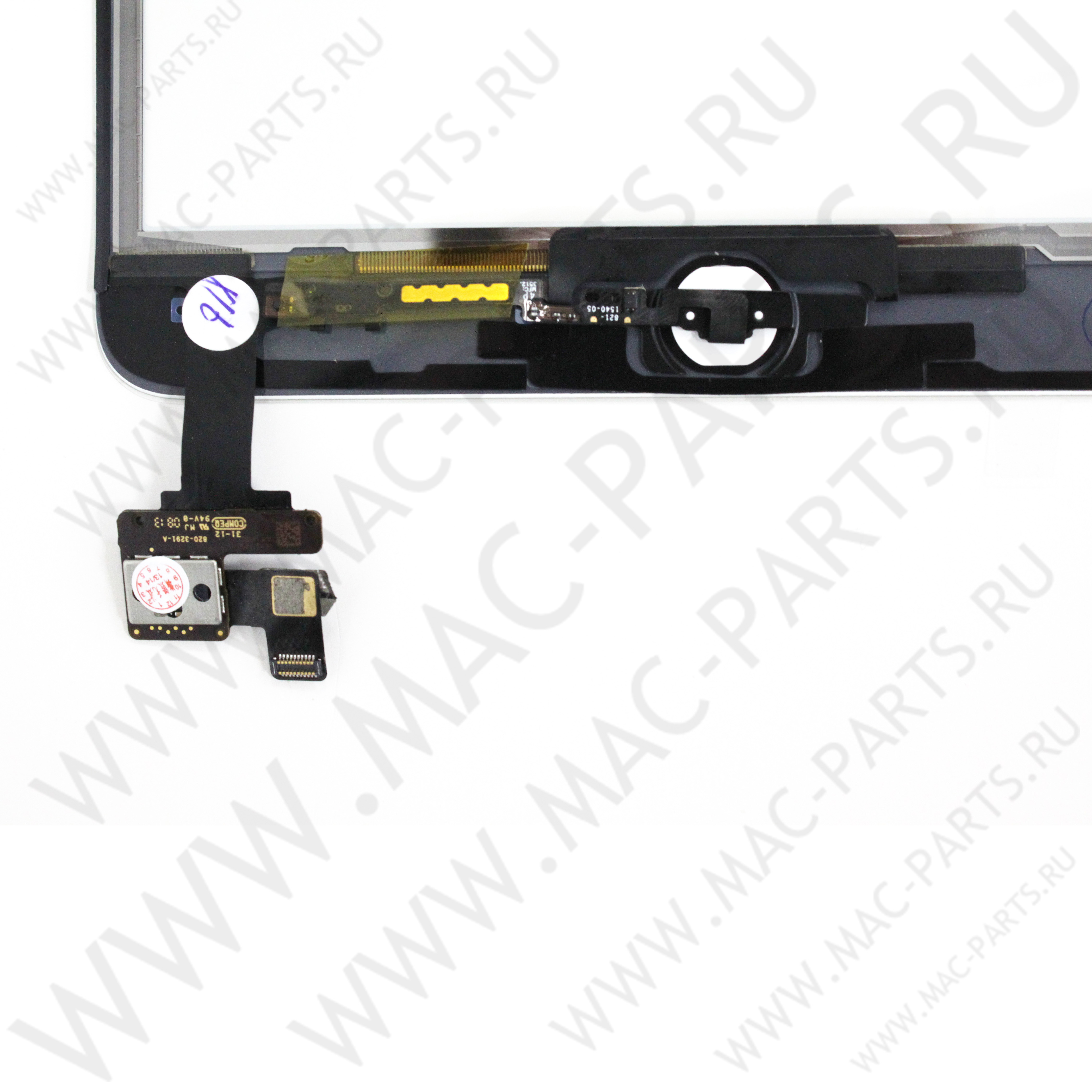

Hey all I have a simple question that I haven’t been able to find the answer to.
What gauge wire would I need to purchase in order to solder a wire to some places on an iPad mini?
The area looks like this:
h_a965cce79ab15da460df5ec13b3f1038
Originally I was thinking that 30ga would befine but I’m not sure.

Under half the in pitch - whatever that is....0.5mm???
wire of 0.25mm diameter so 33 or 34swg but probably 36swg to give decent clearance..
