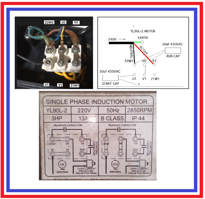

So I bought a new , unused electric motor off a mate cheaply but it didn’t come with a power cord wired in.
It is a 3HP , 13.7 amp , 2800RPM single phase 240 volt YL90-2 . The box it came in says it is a “Powerstar” brand but says YL-S02. It does have YL90-2 stamped on the nameplate of the motor though so presume they labelled the box wrongly. There is no wiring diagram on the underside of the terminal box cover. What is the correct way to wire this ? My daughter is a third year apprentice electrician but has no experience with electrical motors. She does however have a Fluke multimeter that we can use to test the wires inside the box should that be necessary.
From the photos, obviously the blue cap (250 microfarads) is the start and the black (50 microfarads) is the run. There is also a thermal overload switch in there to complicate matters.
I have a 15amp circuit to run this on and the motor will be used on a bricksaw.
Yes, I am just a humble carpenter so keep it as simple as possible.
Many thanks to anyone who can point me in the right direction here.

Bluejets
Oct 5, 2014
7,374
Oct 5, 2014
7,374
Active to the floating red cable and Neutral to terminal V2.
And naturally Earth to the frame.
Megger required for testing before plugging in to any power (no, not multimeter) And would recommend doing a load current test (tong meter)before running for any extended period.
Must add not mine but from a pervious enquiry....even though the previous is shown at 120v, should be the same.
https://www.electronicspoint.com/forums/threads/yl90l2-2-single-phase-dual-capacitor-motor.284820/
Note that yours includes an overload device, hence the need for Active on the floating Red rather than U2.
As previously stated by Minder, these motors pull quite a wack of current and it may need more than your available 15A circuit and would most definetely not like to be run on any extension lead.

So a while back I bought a used electric motor off eBay cheaply but the previous owner has “played around “ with it after it apparently blew a capacitor. He couldn’t remember what wires he had disconnected or moved. It has sat on the shelf for a couple of years after I bought it. As you can see in the photos he has tried to replace the starting cap with a run cap from another motor which appears to be 30mf. According to the manufacturers plate it should be 250mf -250VAC so I ordered one and it arrived yesterday. The terminal block letters are hard to see so I undid the screws, made a note of their letters and drew a diagram.
It is a 3HP , 13.1 amp , 2800RPM single phase 240 volt YL90L-2 . There is no wiring diagram on the underside of the terminal box cover ( again! ). What is the correct way to wire this ? My daughter is a third year apprentice electrician but has no experience with electrical motors. She does however have a Fluke multimeter that we can use to test the wires inside the box should that be necessary. As per my other motor that I enquired about recently the only guy we know with a Megger is one of the tradesmen that works with my daughter but he isn’t due back from holidays until this coming Sunday.

We wired up both motors and tested them on a friends 15amp circuit on which he has a 20amp circuit breaker. No problem with either of them but when we returned home and plugged them into our 15amp circuit they blew straight away. Obviously as per Bluejets advice above we need to get a 20amp circuit breaker on there. Now, I have done some research and from what I've gleaned we need something like a 20 amp C or D curve circuit breaker which has a higher initial amp rating - if that's the correct terminology ?
Stewie
