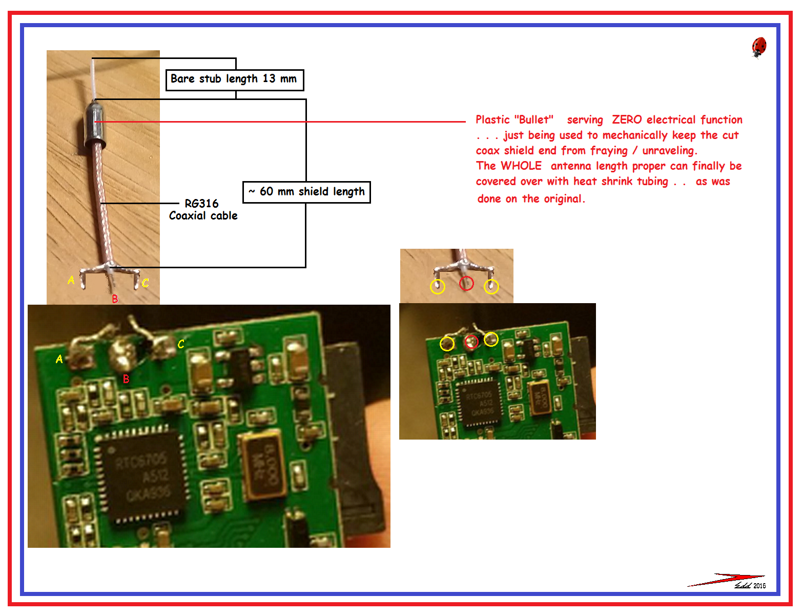

Sir kagaos . . . . . . .
Ahhhhhhhh Sooooooo . . . . .Most honnable apologies . . . .I be velly velly bizzy lately.
Saw your third from last post and see that the ohmmeter testing would have had two errors.
The BLACK probe lead needs to be moved from the 10 AMPS input jack over to the extreme right to the COM input.
Then the functionii selectamus knobbae needs to be dropped down two clicks to the 200 ohms range.
Open probes should give a reading similar to what is now shown.
Short the probes together and note the change in the reading in trying to display a very low ohms reading.
BUT . . . .this is of no consequence now, after I went back and got your post 1 photo and magged it up.
Using my photo referencing, you can compare what you had left clinging to your PCB end, as compared to what it would have been initially.
Since I am blind-deaf-dumb-senile at this end, how about there being any possible communication between this cameras transmitted signal and your control unit display .
Specifically, is there any any chance that the receiver display gives you received signal strength ?
Or do you just have to experience video drop out ?
If not, lets just play it this way:
Take well tinned soldering iron in hand and clean the coax remnant wire strands from A B C and then solder a rigid length of hook up wire to B.
Clip the extended wire length down to that 13 mm wavelength.
Either fire up both units and either walk off with the control unit to see what range is attained before video drop out or do a test flight in a safe area.
I would expect about 1000 ft range with that temporary test antenna stub.
If all is well, then get a piece of RG316 coax and initially work on the PCB end where you take a sewing needle and unbraid the shield.
Then divide the straightened wire strands into right and left portions and twist and form them into the shown
" quasi Trident" for making the 3 connections.
On the radiating end of the antenna , ever so slightly use a single edge razor blade to cut a ring around the clear plastic insulation covering , but not damaging the shield.
Then the same earlier procedure for unbraiding the coax from its end, up to that circle. A pair of fingernail clippers will do one fine job in evenly trimming that wire around the circle.
When all is in order, trim that stub to 13 mm.
I leave the ~3/8 inch dia plastic "bullet" up to your ingenuity in fabricating. . . .be it multi layering buildup or formed and then cut into halves to re-bond together or a 2 part epoxy putty to mold into shape..
