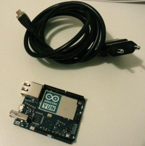

I decided to supply my Yun using an external micro USB power supply (power supplies for modern cellphones works fine):

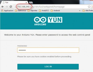

You can reach the administrative interface of Arduino Yun pointing a web browser to the address http://192.168.240.1. The default password is arduino:

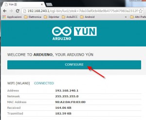

After having logged in, click on configure:
You can change the board’s name (in the screenshot I chose Yun-Luca), the password, the timezone and connect the Yun to one of the wireless networks it detected:
After a reboot, the board will be connected to your network!

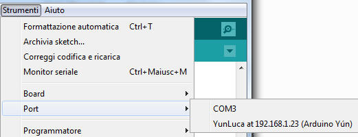

Open the IDE (warning: you must download the latest version, at the moment I’m writing 1.5.4r2) and choose Arduino Yun as your board.
The IDE will scan your network searching for Yun boards and, under the port menu, will display your board and its IP address:

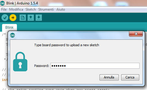

You can now compile and upload your sketch as usual… when the upload process will start, you’ll be prompted for the Yun password:

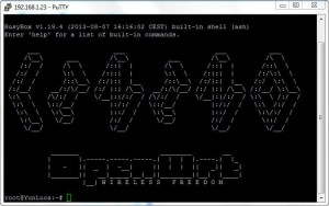

You can also connect to your Yun in text mode, using an SSH client (for example PuTTY per Windows)… in the next posts you’ll discover why this can be useful:
