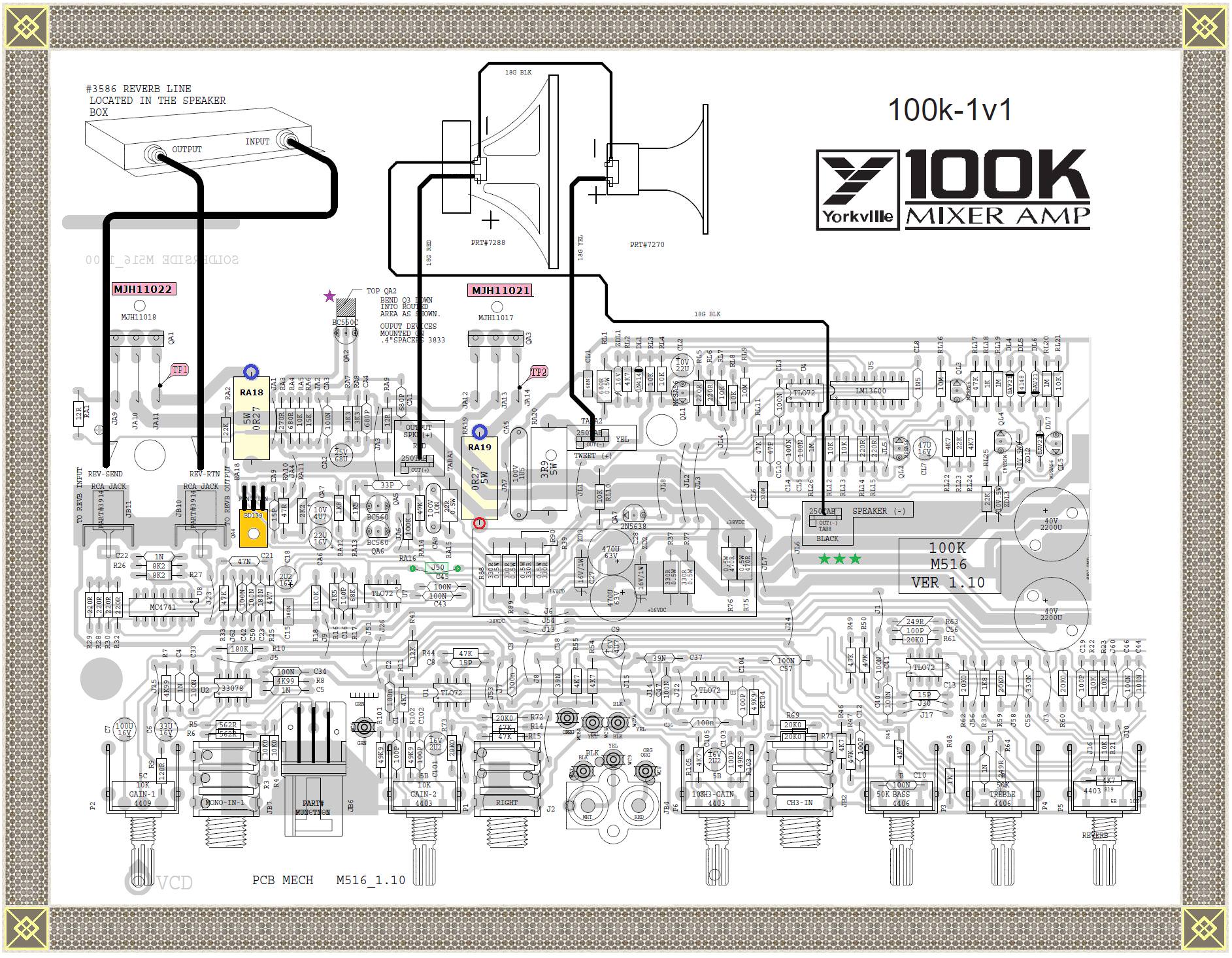

Here is your markup, it being presented as a circuit board PICK-CHOOR, as it seems you handled it better than a schematic page before.
Your new replacement power transistors are marked up, as per positions, and you must already have them in the right slots and I feel that they will be of the TO-247 configuration instead of the older TO-218 cases, look for the mount hole and if it is a 218 that will be a metal tab with a hole in it, if being the 247 case , that will be having a plastic / polycarbonate tab.
What was being used for heat sink to power transistor insulators . . . . MICA washers . . . . or Gray silicone pads ? ^^^
TESTING . . . .
Lets initially see if the DC voltage drives to the bases of those transistors are being proper, by taking DVM and placing in DC voltage mode and having Negative lead to the 3 GREEN stars common ground connection OR even closer is the GREEN markup of Jumper 50 with its bare wire on the component side or two side by foil lands to either side. The metered point of interest will be the RED circle junction of the shared common connection of the RA18 and RA19 resistors of the OUTPUT transistors emitters.
Upon power up, you should have a negative 38VDC coming into the end of one power transistor and a positive 38VDC coming int the like connection of the other power transistor. Now if all is well in your tied in ancillary transistors, that voltage should balance out and result in cancelling out each others voltage differentials and leaving less than a volt at the RED test point..
If this tests out, then feel free to apply your sine test waveform and aurally monitor on the speaker as you raise the audio level, while keeping an eye on the monitored RED point voltage. Take note of any voltage changes, or, if it only starts showing up as your volume level approaches the onset of distortion that you were previously experiencing. ^^^
Run down the volume now and let's do the same test, using differential mode voltage testing .
The Test points will be the BLUE circles, polarity is irrelevant, one probe on each circle.
Now if you are monitoring those points and have an incoming sine, the NPN output transistor will be responding to the + node of the sine while the PNP will then be responding to the - node of the signal, just after each sines ZERO transition points.
If all is well, the meter will not respond at all. Then as you apply sine and incrementally increase the audio there will either be a negative or positive voltage presence if any imbalanced conditions start showing up, advance on up to, and into your point of distortion ^^^ to see if a DC voltage then starts developing.
Final test will be of the emitter resistor pair, for taking a quiescent static voltage test.
No input audio, just power up and have volume to minimum and one DC voltage meter probe to RED circle and read over to one BLUE RA18 circle and read and log in and then test RED to the other BLUE RA19 circle, expecting the voltages to be the same . . . . and what are the voltages. Expect these readings to be down on in the low millivolts.
If those voltages mate out, your suspicion of any damages to the original BD139 driver and QA BC550C seem to be unfounded.
My PURPLE star reference was just for the need of that transistor to be down in its channel to serve as a heat sink temp sensor.
That's it . . .report your findings. . . . .FIO . . . the ^^^'s markers were just relevant to readings needed to be taken and forwarded for analysis..

OK test results.
Test #1
Negative to J50
Positive to red circle on RA19
DMM set to 20 DCV
Reading = 0.02
Negative to J50
Positive to red circle on RA18
DMM set to 20 DCV
Reading = 0.02
1K sine wave test
Low volume, reading = 0.02 to RA18
Point of distortion = 0.60 -> 1+
If I totally crank the amp I start to hear a voltage hum (I think) as the meter goes up.
Video Link: https://photos.app.goo.gl/Bya5TSMYmPeom5Y03
Test #2
Voltage started at -0.07 at RA18 and 0.11 at RA19
Test #3
DMM set to 20 DCV
Probe on RA19 (blue and red circle)
Voltage: 0.09
No input or audio passing through.
Probe on RA18 (blue and red circle)
Voltage: -0.08
Excited to hear your thoughts.

Your supplied numbers tell us that you definitely have problems in your biasing and drive circuitry.
The unit is going into full clipping very early on with that applied audio test signal.
Just as preliminary, yet using thorough testing protocol, lets test the supply resistors in the base feed circuitry that could even possibly burn.
That situation usually went out with the use of molded carbon composition resistors of the 1940-60's .
Spot check the resistances being read by the series string of resistors below :
RA1---- 12 ohms
RA4----680 ohms
RA3----270ohms
RA9----12 ohms
RA10---47 ohms
Next point of interest would be the fact that you mentioned the leads associated with the QA-2 BC550C small signal transistor.
Is that unit being the original unit or a different one . . . . AND . . . . if it was pulled, and reinstalled, could it have been installed 180 degrees in error ?
Is the BD139 the original unit also ?
Last interest would be the pulling and testing of the base to emitter and the base to collector junctions of both of those units.
SAFEST PROCEDURE . . . . . to preclude any foil damage or delaminating from board..
Place the chassis so that pcb plane will be flat and facing up
Apply fresh 60-40 rosin core solder to one of the three connections of a transistor and get the old solder and your new solder mixing and keep adding solder until you get a BB sized round blob, move on to the next lead of the transistor and do same and end up with the third lead also having its blob. On the small transistor it's permissible for the blobs to join.
Since . . . . . you will now grab the case of the 550 transistar and start an extraction pull on it, while you rapidly move a WELL TINNED solder tip between the 3 blobs sequentially, until the leads free and the transistor pulls downward and easily flies free.
End result . . .MINIMUM heating time needed, as well as the heat level being transferred to both the transistor and the foil.
Same procedure on the BD139, but it needs longer heating time and more heat. Plus, confirm that the leads are not folded over and will easily pull straight down, even though its flat case is set at 90 degrees to its leads passing thru the 3 board holes.
Use diode test mode on DVM and expect in the 500-700 millivolts range for each of the two B to E and B to Coll junctions..
Additionally, then do a precautionary, C-E test with the two polarity possibilities of the test probe leads.
