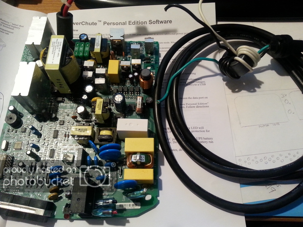

No plan as of yet, but I did score a nice find via recycling my UPS today - heavy duty power cord with strain relief! So that kind of counts as working towards this goal ;-)
Sorry for the picture - the strain relief is the type where you notch your case and slip the molded relief area into the notch. If its loose, I can shim it with some washers and epoxy it in place. The iron core had me curious, should I keep it or just unwrap the wires and set aside for another day?
Btw - the board is just chock full of parts that might be useful. Lots of x rated caps, some relays and a bunch of transformers that are not coming up in a google search. I spotted 4 IRF3205 fets - they are attached to the huge chunks of aluminum on the left. There are about 9 more fets of some kind with heatsinks as well.

That is a good find. But it looks pristine! Are you sure it is not repairable? Sometimes the only thing that fails in a UPS is the gel-cell battery pack.

Agreed, I've had this unit for about 8 years. I've replaced the battery twice and still don't get the appropriate run time as well as periodic shut offs, I figured that the circuitry may have fallen out of spec. I assumed these units take a beating with load regulation and surge protection, so I just replaced it to be safe. I was about to bin it and realized - hey, that's a great cord! After the cord, I found a bunch of mosfets inside - which I probably destroyed a few - was desoldering the heat sinks and managed to short the source of the fet with the heatsink via the solder wick - saw a spark :-( I did lift off several monolithic aluminum heatsinks for to-220 packages, some of those x rated caps and a relay. Solder sucker works pretty good!
So about that iron doohickey at the end of the power cord - I guess its there to have an effect on the magnetic field, but it doesnt make much sense to me since both line and neutral are wrapped around the iron core. What's it purpose? Why not wrap only the line side?

It's called a "common mode" choke. It suppresses switching transients from inside the UPS getting back out on the power line.. either hot or neutral. We use them in amateur radio coaxial transmission lines to suppress "common mode" currents that travel back on the outside of the coaxial cable braid and create "arcs and sparks" back in the shack. Problem usually only occurs at higher power levels, but it is always a good idea to suppress common mode currents. Many hams suppress common mode RF without using the ferrite cores by simply making a few loops of out of the coax where it attaches to the antenna, holding the loops together with black tie-wraps or even electrical tape. Four or five turns on a eight or ten inch diameter provides enough inductance to suppress amateur radio RF from propagating back down on the outside of the coax. If that isn't enough, they feed the coax through ferrite cores. Some hams can get pretty carried away with this, placing a dozen or more cores on the coaxial cable in an attempt to keep RF out of the shack.
At the switching frequencies of your UPS (several kilohertz most likely) it requires more inductance to get the same effect, hence the powdered iron cores to wrap the wire around. Sounds like you have unearthed a real treasure chest thar, matey!

In that case I will keep it on there - I doubt I will have large loads, but I haven't spec'ed out a cap for the psu yet, and that cap can very well produce a large transient! Thanks for the explanation - I was going to say choke, but I didn't understand just what it was attenuating!
The cord alone is treasure, the rest is extra booty. :D If any of those fets survived it will be a miracle!! LOL We shall see.
