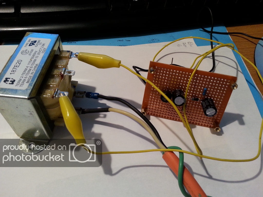

Here is the setup:
The transformer provided 23.45 VAC unloaded, so the caps I picked where rated at 35vdc, close to max, but I figured under load the xfmr would have some voltage drop so that should keep it safe. Perhaps in the psu it would be more prudent to go with 50vdc for the extra capacity in case of transients and ?wild swings caused by high loads on the output which may be abruptly cut off causing back 'waves'?? (My new thought on current is that its like a wave propagating through the wire)
edit - diodes used were 1n4002, bridge 2A, 800V generic 2W08 high speed rectifier.
Anyway at startup, from R7 to common was -0.756 VDC. I am not sure why yet. Bridge + terminal to common was +39.3 VDC (does that seem correct?)
After 10 minutes the R7 to common junction slowly drifted mV by mV to -1.32.
About 20 minutes later, same junction was at -1.25 - temperature in room consistent.
About 5 minutes later, -1.2.
So, it looks like the circuit works as predicted, the diodes apparently need some kind of 'warm up' time to reach a steady state.
Forward-biased silicon diodes have a voltage drop that is a function of current and temperature. So, yes, they do need to reach a stable temperature before their voltage drop settles down. Won't stay there though. The input voltage is unregulated and will vary with power-line voltage. That won't bother your "zener" much as long as the well-filtered current through R7 (get rid of that sawtooth!) stays below 12 mA, but two series-connected forward-biased diodes are not a substitute for your "zener" device. They are just a convenient way to test the negative bias circuit used with your real "zener" device. BTW, datasheet says you need a capacitance of at least 10 nF (0.01 μF) across the LM4041 for stability.

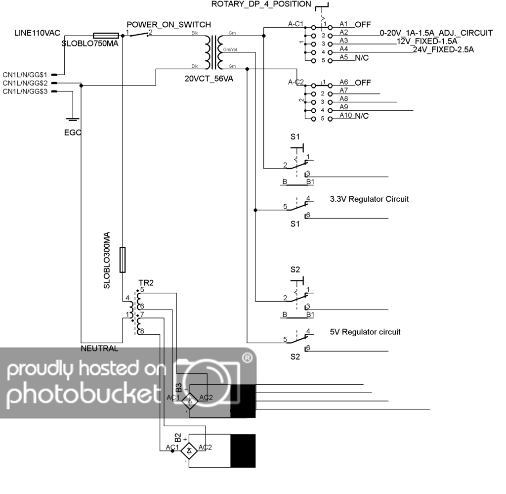

Today's madness brings some design alterations... maybe..
After some thought and some excellent suggestions I have come up with condensing multiple supplies into a compact, usable form. The schematic above is partial - I really just wanted to ask a few questions about the approach. I thought it would be really cool to access the various 'voltage supply circuits' via a multiposition rotary switch. I figured out how to do that for the circuits that use the outer windings. For the two lower voltages that will use the center tap, they each went on their own DPST switches. As is, it looks like I can use either 3.3v or 5v individually or at the same time.
  1. Should the bridge and capacitor bank be ahead of the rotary switch to minimize components? i.e. cap/bridge common to all three upper circuits with separate regulators and discretes after?
  2. Should the rotary switch be 'make before break' to prevent arc damage on the contacts?
  3. As drawn, if the center tap fed circuits are in use, would I still be able to have 20VAC and be able to use the upper circuits (albeit at a reduced current)?
I really like this approach, more flexibility, a few more parts and regulators, but very interesting! If this is a possibility, I would replicate the same group of circuits for the second transformer thus having two identical outputs and the ability to have +/- supplies for audio amps, etc. The xfmr on the bottom is for the panel meters. To save space and number of panel meters, the upper three circuits switched by the rotary switch would share one panel meter - I assume that I would simply need to common their outputs - I haven't fully elaborated on this yet and I am hopefully that this will not be a problem.
Your thoughts?

My thoughts are: you are over-thinking this.
I can see using a separate switch to enable and disable separate power supplies, all powered from separate transformer windings, but it is penny wise and pound foolish to create an elaborate switching scheme to create series and parallel configurations of a single transformer to allow for different rectifier/regulator power supply outputs. What if you need an output voltage for, say, 3.3 V and 5 V at the same time AND an adjustable 0 to 20 V output and a fixed 24 V output at the same time? Likely to overload the transformer or, in the second case, have only one of the two outputs available when you need both. For example, you have a spiffy CMOS circuit you want to energize with 10 or 15 volts and use it to drive a 24 V DC relay coil you just salvaged from a WWII Mark Z whatchamacallit chassis. Oops! Gotta find another transformer and throw together a 24 V relay supply. Good thing it won't need voltage regulation though.
Maybe I'm just old-fashioned, but I would have appropriate individual and separate secondary windings for each power supply output. Each secondary would have a bridge rectifier, an energy storage (filter) capacitor, and a regulator circuit. Then, if I didn't need a particular output, I would maybe have a switch that disconnected it from the output terminals. Maybe a four-pole switch to disconnect the transformer secondary winding too (saving a watt or two), but that's as far as I would go. In all probability I would leave everything powered on all the time and just select whichever output binding posts I wanted to use on any particular day.
I've done it more times than I care to remember, but to base a project as important as your bench power supply on parts you happen to have because they were purchased cheap is not good engineering. Of course hams do this all the time: they find this nifty boat-anchor of a plate power transformer at a flea market for ten bux and dream of building a kilowatt linear amplifier around it. Maybe it works, maybe it doesn't. But the amplifier design should come first and then the design for the power supply to energize it. And in the case of power supply design, you decide what output voltages and currents you need, assume all the outputs will provide their rated current at their maximum voltage, then you find one or more transformers that satisfy the power requirements.
About your Schottky diode from Cree: I purchased four of these puppies for use with four Cree MOSFET power transistors in a high-frequency switching application (PWM control of the four phases of a stepping motor at 100 kHz or so). Their main claim to fame is very fast switching and high power dissipation. You do not want to use these as your power rectifiers. Their forward voltage drop sucks and their internal resistance is terrible. Scroll down to near the end of the datasheet for a model. Except if you need fast switching (which you do not!) these are not the diodes (or droids) you are looking for.
Datasheet for the LM317A from Linear Technology says this device is good for 1.5 A if you properly heat-sink the K package and pay attention the voltage drop from IN to OUT. You don't need a diode from ADJ to OUT with this device, and the diode from OUT to IN should be a power rectifier diode (same as you would use in the input bridge rectifier) like a NTE576 not a small-signal diode like the 1N4148. You might get away with something from the 1N400x series, but that would be pushing their 1 A forward current rating. Although dirt cheap and readily available, this series is not recommended for new designs.

The point about dual tracking ± outputs is extremely important for op-amp circuits requiring bipolar supplies
This I haven't fully understood as I figured it would be easy enough to adjust each supply, no? If you create a tracking supply you no longer have two independent supplies! Wouldn't that be more limiting. I asked about dual tracking supplies last year in my first bench power supply attempt, but never got an answer regarding this, maybe someone can clear it up?
Bench Power Supply
I agree with all four points. But sometimes it is absolutely necessary to "sneak up" to the rated power supply voltage starting from zero, lest the magic smoke escapes from some critical (and usually expensive or no longer obtainable) component you are playing with.
Agreed, had magic smoke fountain out of a cap last year, very unexpected!! I believe that is when I learned about RMS values of ac to dc.
And finally, @chopnhack is building a bench power supply as much for the learning experience as anything else. It is essential that he understand how it works and how to troubleshoot and repair it.
Absolutely, this is critical. I could have placed an order for some of those units we see on e-bay eons ago, but I'd rather learn what these simple circuits do!
Gee, I hope not!
Don't misunderstand, I do intend to do a good job, but this will not be my last p.s.u., lol.
I plan to introduce you to high-power pulsed electronics very soon now.
Negatory, sensei - I must master this, finish the blink circuit and finish the run delay circuits programming as well!!! Only then will I be able to take on a new challenge!
I thought that was my job!? Let's see how soon you can make this... and have it actually work.:D
Ah!! A challenge, dead bug or professional pcb? LOLOLOL Now to be fair, Hop, any joe can slap a cap, a v. regulator and a resistor together and have a working supply :D We need a professional, functioning supply that can meet the needs of my tinkering and the future! I will be posting a sketch in the next few days of the basics, essentially little more than a block diagram to flesh out the ideas that I have come to today. Then we can complicate ;)
