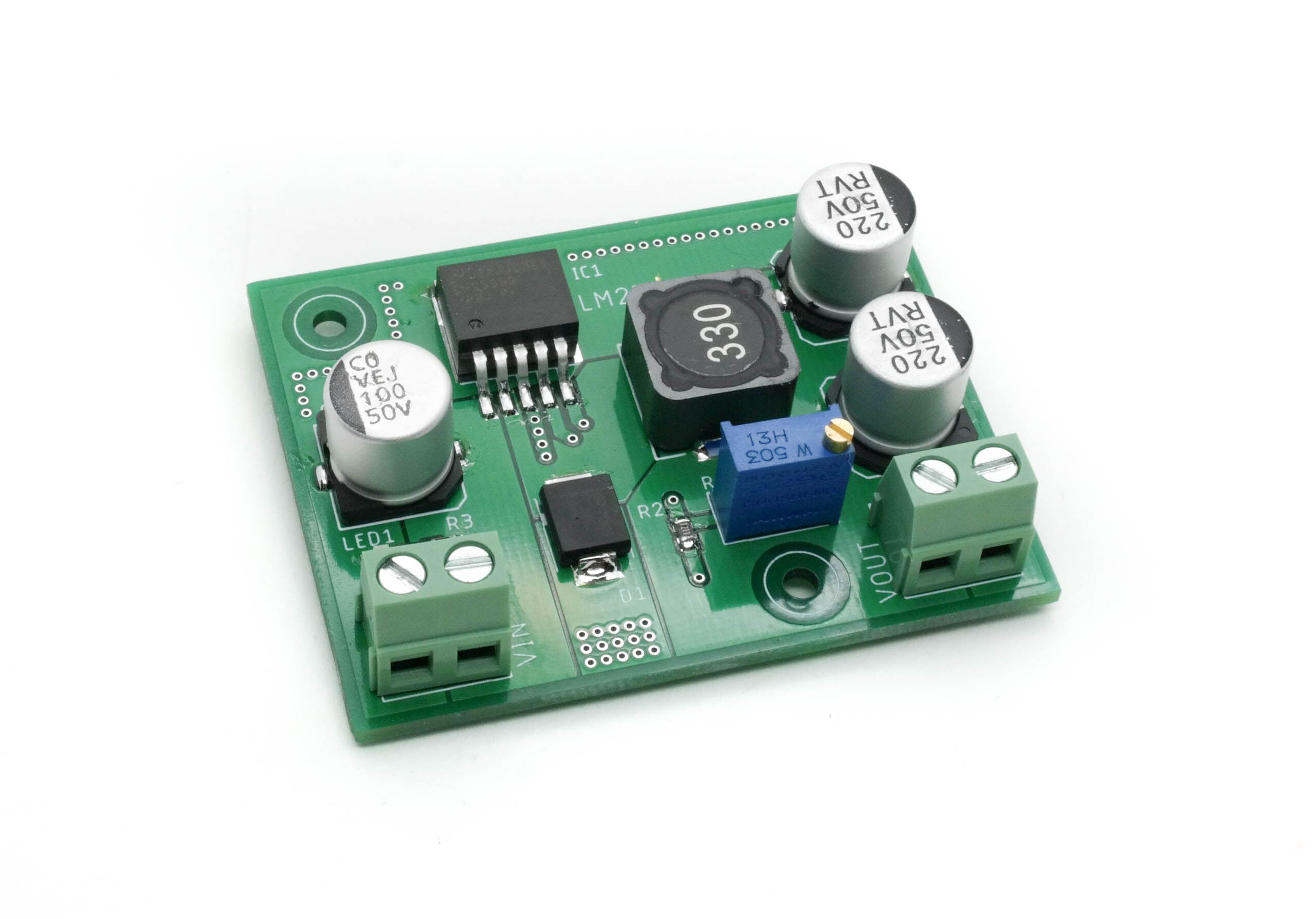

1.2V to 35V @ 3A Adjustable Step-down Regulator using LM2596
This is a highly efficient and compact project that is capable of driving a 3A load with excellent line and load regulation and adjustable output of 1.2V to 35V DC. The project is built around the LM2596-ADJ regulator which is ideally suited for easy and convenient design of step-down switching regulator using buck converter topology.

  • Precise potentiometer for voltage adjustment
  • Output Ripple: ≤100mV

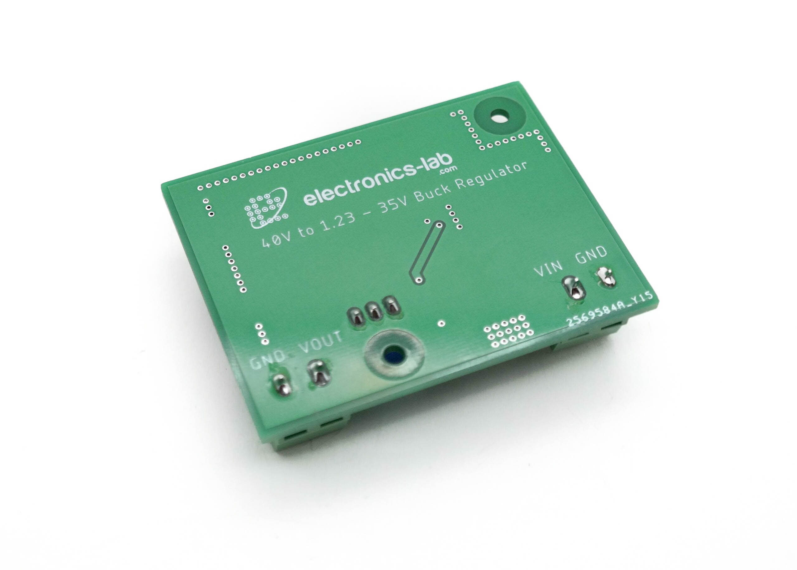

  • PCB dimensions 57.15 x 44.34 mm

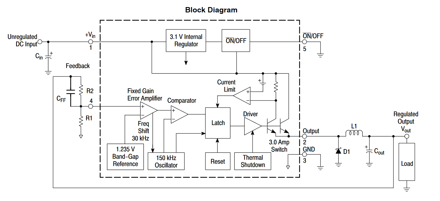

Schematic
Block Diagram

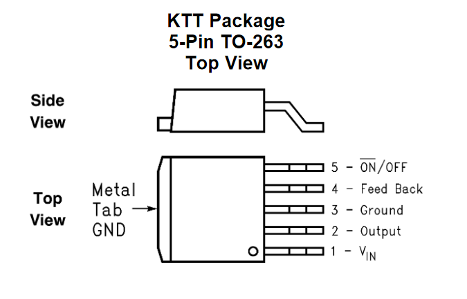

Pin Out

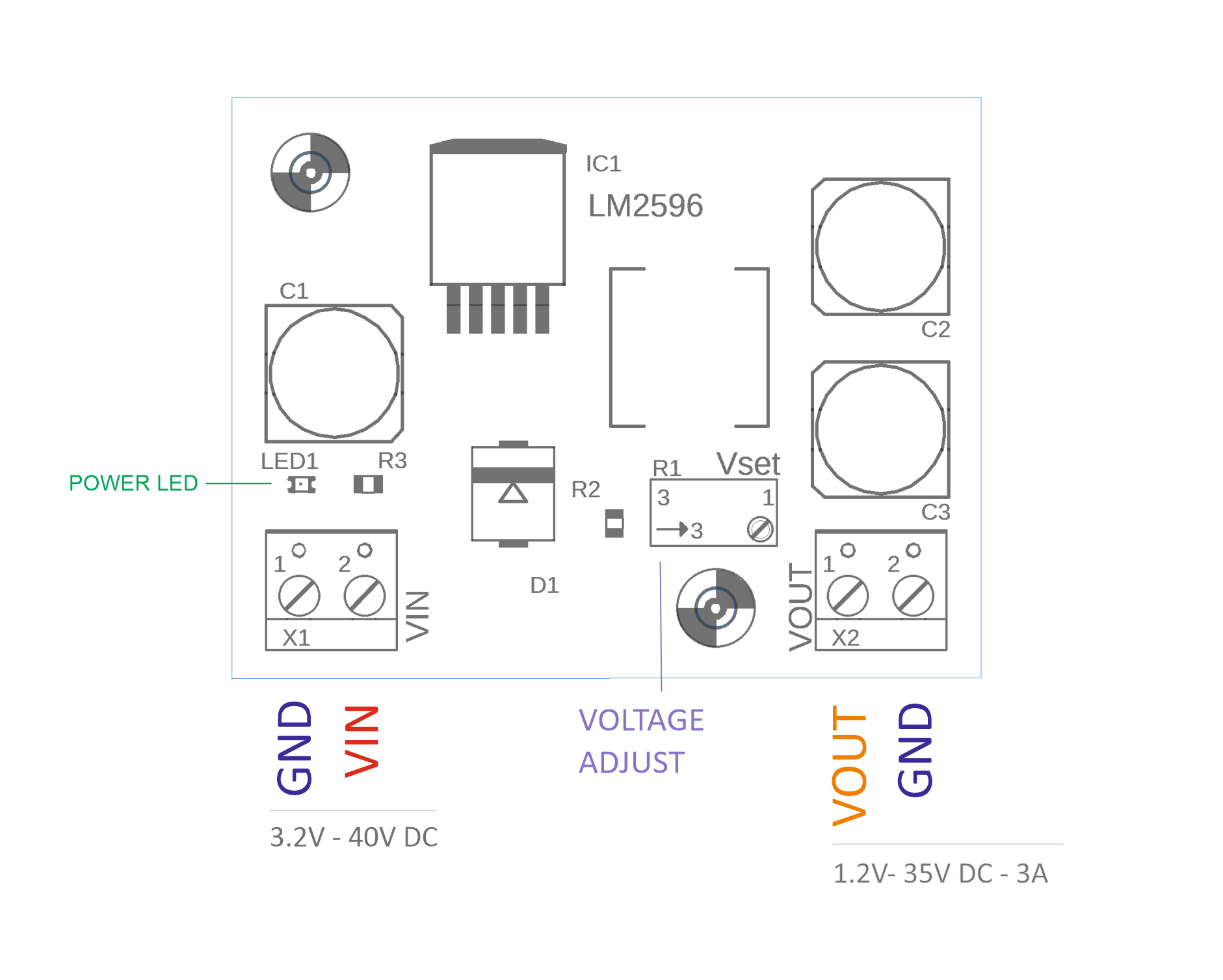

Connections

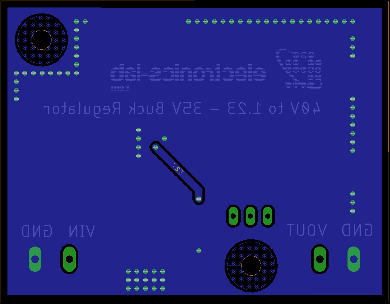

Gerber View

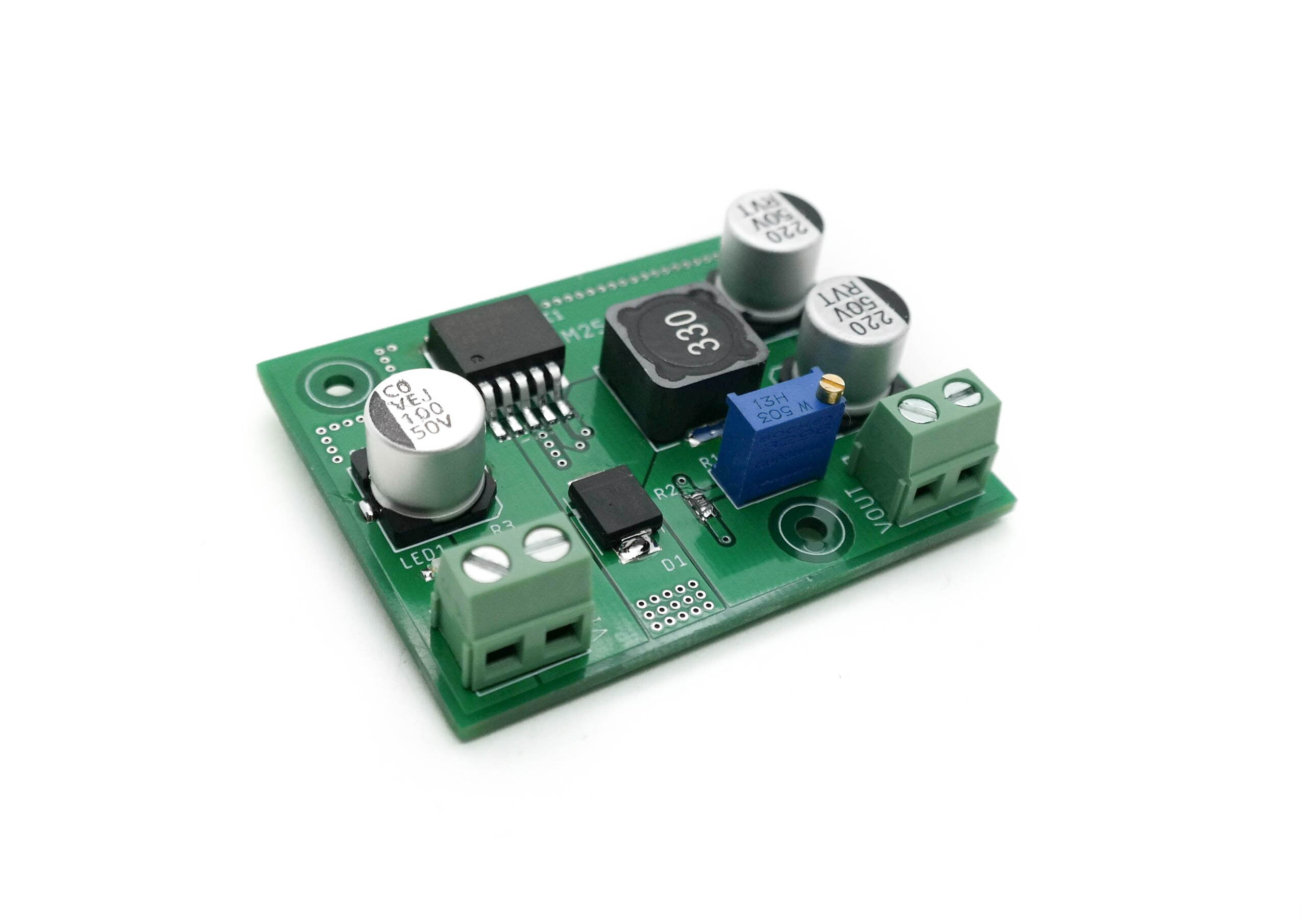

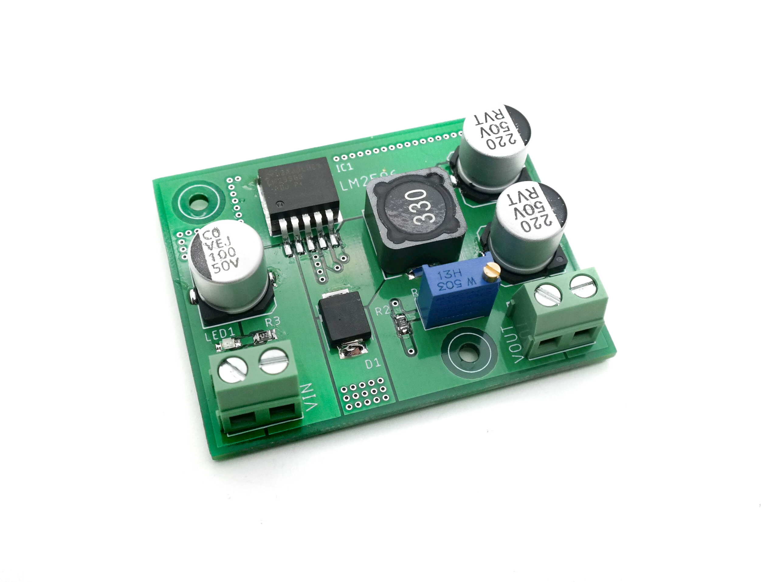

Photos
