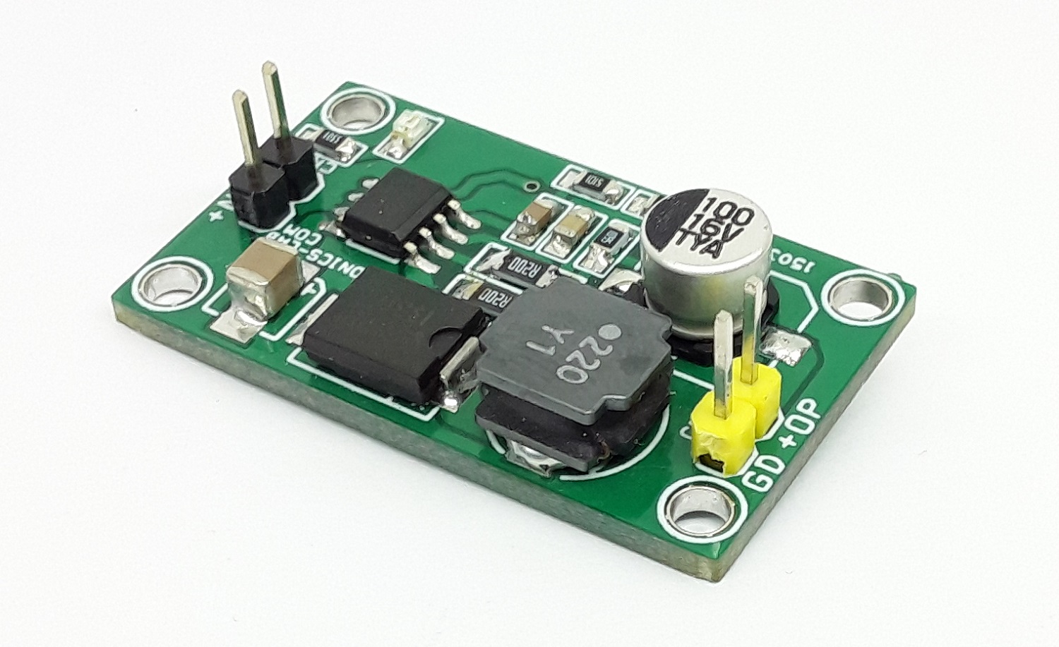

The step-down DC-DC Converter project presented here provides 3.3V @ 1A output from an input range of 8V to 36V DC. The adjustable current limit is an important feature of the project, which prevents the device from accidental output short circuits avoiding excessive load damage.
Power by mixos

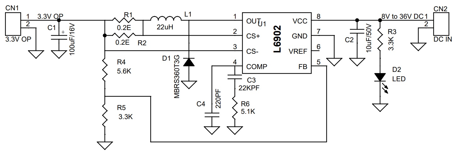

The step-down DC-DC Converter project presented here provides 3.3V @ 1A output from an input range of 8V to 36V DC. The adjustable current limit is an important feature of the project, which prevents the device from accidental output short circuits avoiding excessive load damage. The internal limiting current (latched function) has a typical value of 2.5 A. The project is built around the L6902 chip from ST. The L6902D is a complete and simple step-down switching regulator with an adjustable current limit. Based on a voltage mode structure it integrates a current error amplifier to have a constant voltage and constant current control.  By means of an onboard current sense resistor R1 and R2, current limit programming is very simple and accurate (±5%). Refer to the datasheet of the chip for R1 and R2 values about the current limit adjustment. The project can be used to charge NiMH and NiCad batteries due to its constant current feature. The project operates with a fixed switching frequency of 250Khz. If the temperature of the chip goes higher than a fixed internal threshold (150°C with 20°C hysteresis), the power stage is turned off. Other protections besides thermal shutdown complete the device for a safe and reliable application: overvoltage protection, frequency foldback overcurrent protection, and protection vs. feedback disconnection.
Note: The default output of the project is 3.3V @ 1A.  The current limit can be set using R1 and R2, and Output Voltage is adjustable using resistors R4 and R5, refer to the datasheet for more info.

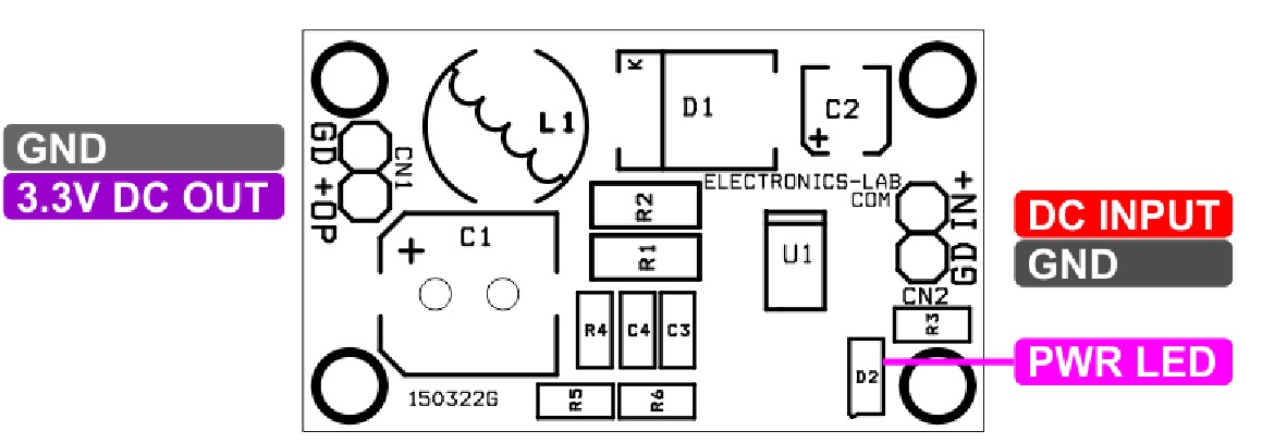

Connections
  • CN1: Pin 1 = 3.3V – 1Amp Output, Pin 2 = GND
  • CN2: Pin 1 = + DC 8 to 36V Input, Pin 2 = GND
  • D2: Power LED Input Side

Schematic

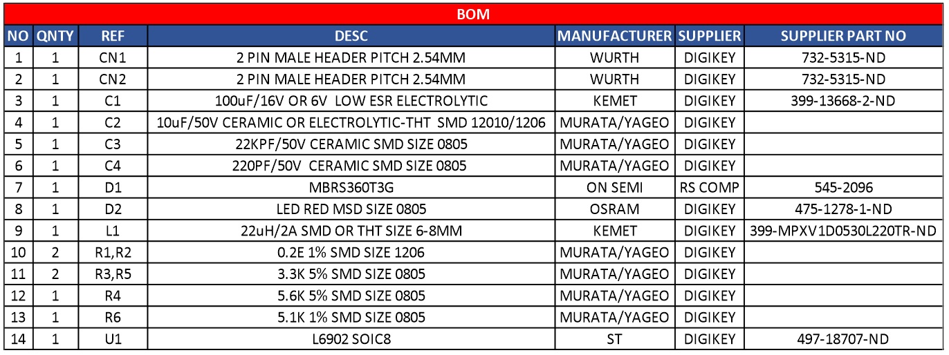

Parts List
NOQNTYREFDESCMANUFACTURERSUPPLIERPART NO
11CN12 PIN MALE HEADER PITCH 2.54MMWURTHDIGIKEY732-5315-ND
21CN22 PIN MALE HEADER PITCH 2.54MMWURTHDIGIKEY732-5315-ND
31C1100uF/16V OR 6V LOW ESR ELECTROLYTICKEMETDIGIKEY399-13668-2-ND
41C210uF/50V CERAMIC OR ELECTROLYTIC-THT SMD 12010/1206MURATA/YAGEODIGIKEY
51C322KPF/50V CERAMIC SMD SIZE 0805MURATA/YAGEODIGIKEY
61C4220PF/50V CERAMIC SMD SIZE 0805 MURATA/YAGEODIGIKEY
71D1MBRS360T3GON SEMIRS COMP545-2096
81D2LED RED MSD SIZE 0805OSRAMDIGIKEY475-1278-1-ND
91L122uH/2A SMD OR THT SIZE 6-8MMKEMETDIGIKEY399-MPXV1D0530L220TR-ND
102R1,R20.2E 1% SMD SIZE 1206MURATA/YAGEODIGIKEY
112R3,R53.3K 5% SMD SIZE 0805MURATA/YAGEODIGIKEY
121R45.6K 5% SMD SIZE 0805MURATA/YAGEODIGIKEY
131R65.1K 1% SMD SIZE 0805MURATA/YAGEODIGIKEY
141U1L6902 SOIC8STDIGIKEY497-18707-ND

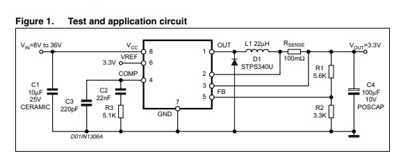

Application Circuit

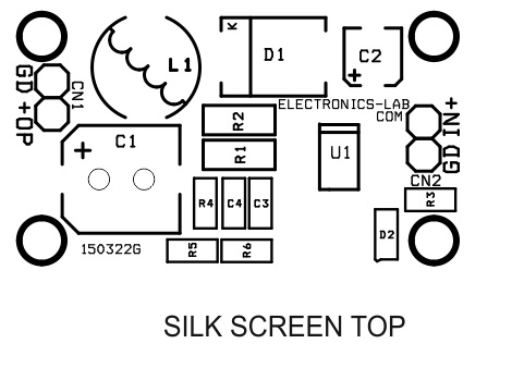

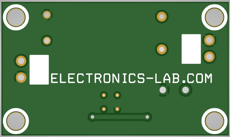

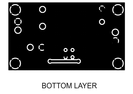

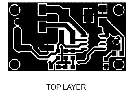

Gerber View

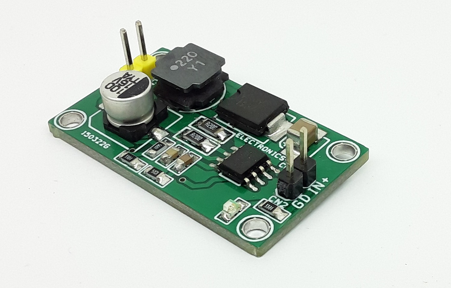

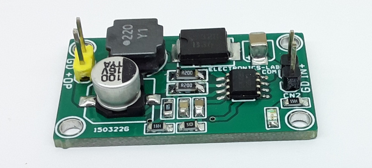

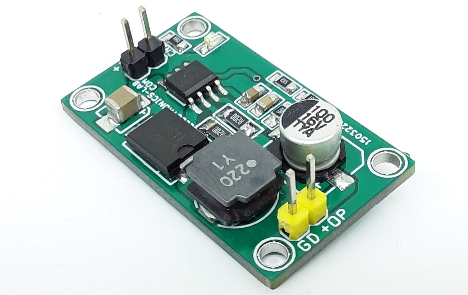

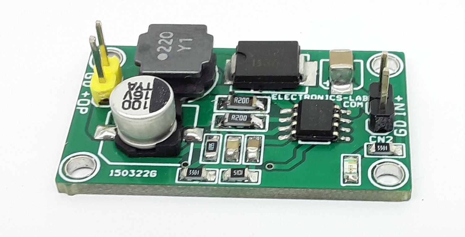

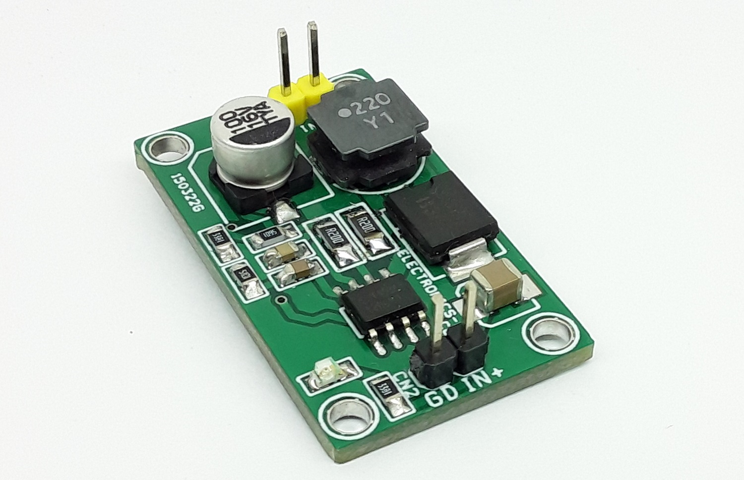

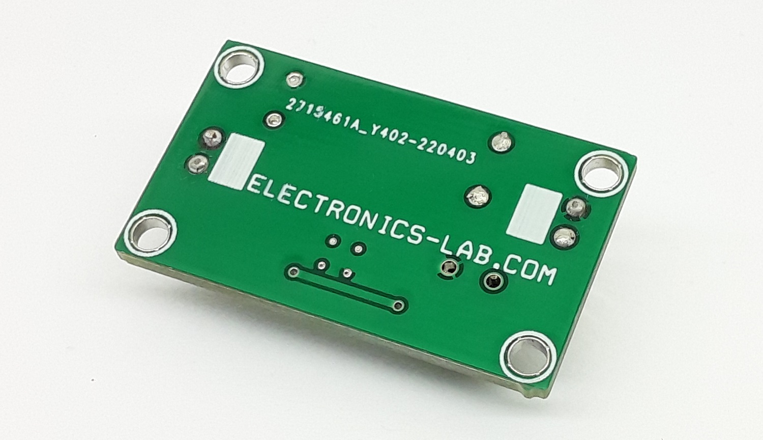

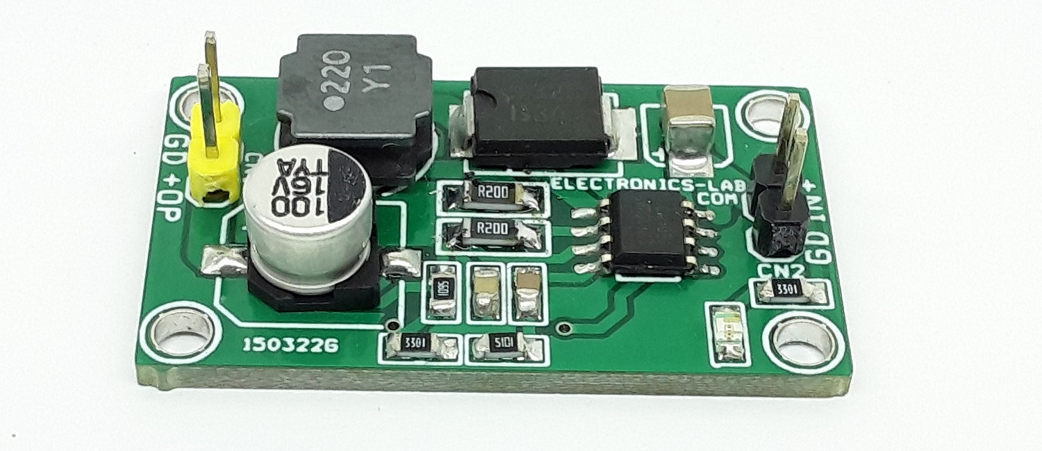

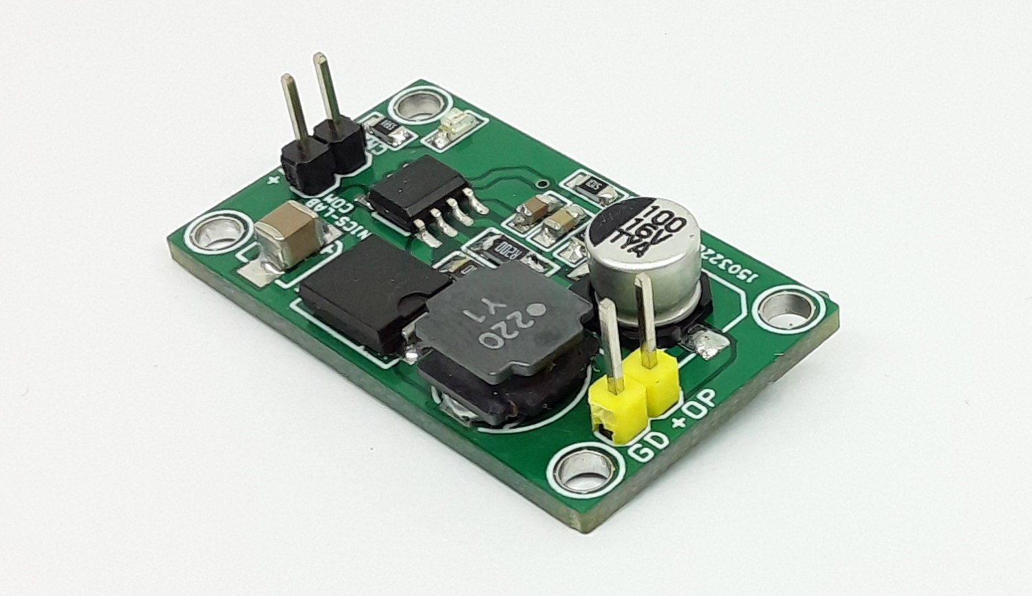

Photos
