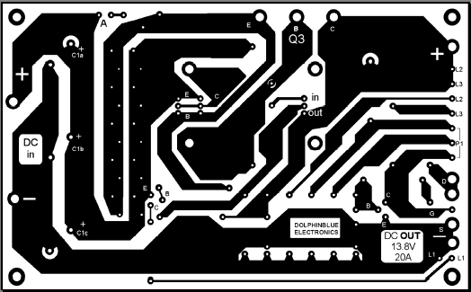

If somebody will be interested, there is a PCB design ready.

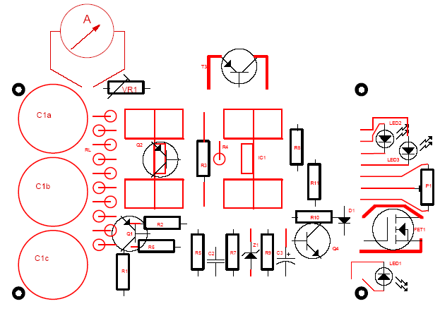

REV1.
I have received several requests for some modifications, and the one I find useful is the addition of an amp meter. Therefore the slightly modified diagram is included in this revision. All elements within the dotted border are now placed on the pcb. There is also elements placement design included. Should one have an 25Amp instrument on hand, there is nothing easier. Just mount it in line and there it goes. However, a ham would probably find an instrument somewhere in his “junk-box”, but the scale would be something completely different, let say an “S” or Voltmeter. No problem. We already have a “shunt” for the amp-meter, and it is there as the Current limiting resistor “RL”. As already known from before, there is a voltage drop of 0V7 over the resistor at current flow of 20A. What we now have to do, is to simply measure the voltage drop over the resistor, and co-relate it with the current. Let us say that our instrument has an internal resistance of 13R, and has a full scale reading of 60mV. The voltage drop over the RL is 0V7 for 20Amps. Therefore, we need another resistance in line with the instrument, that would bring the 0V7 to 60mV, or an voltage drop of 640mV.
The formula is simple:
U1:R1=U2:R2
60:13=640:X
X=13×640/60
X=138.66
Therefore, the resistance that has to be inserted in line is around 140R. I suggest to insert a trimmer (VR1) of around 200R, to fine trim the reading when calibrating the instrument. Using your favorite drawing software, design your scale to your likings, (at least 20A for the full scale) and insert it in the instrument you have. Due to the many requests for the PCB Layout, I have included the design here. The exact dimensions of the pcb are 160x100mm. Please remember, that the pcb has to be printed as a mirror image, to obtain higher quality when transferring it to the copper side of the board.
