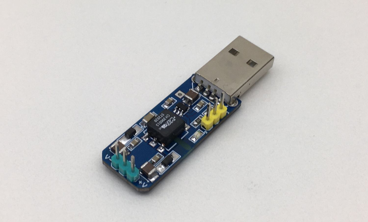

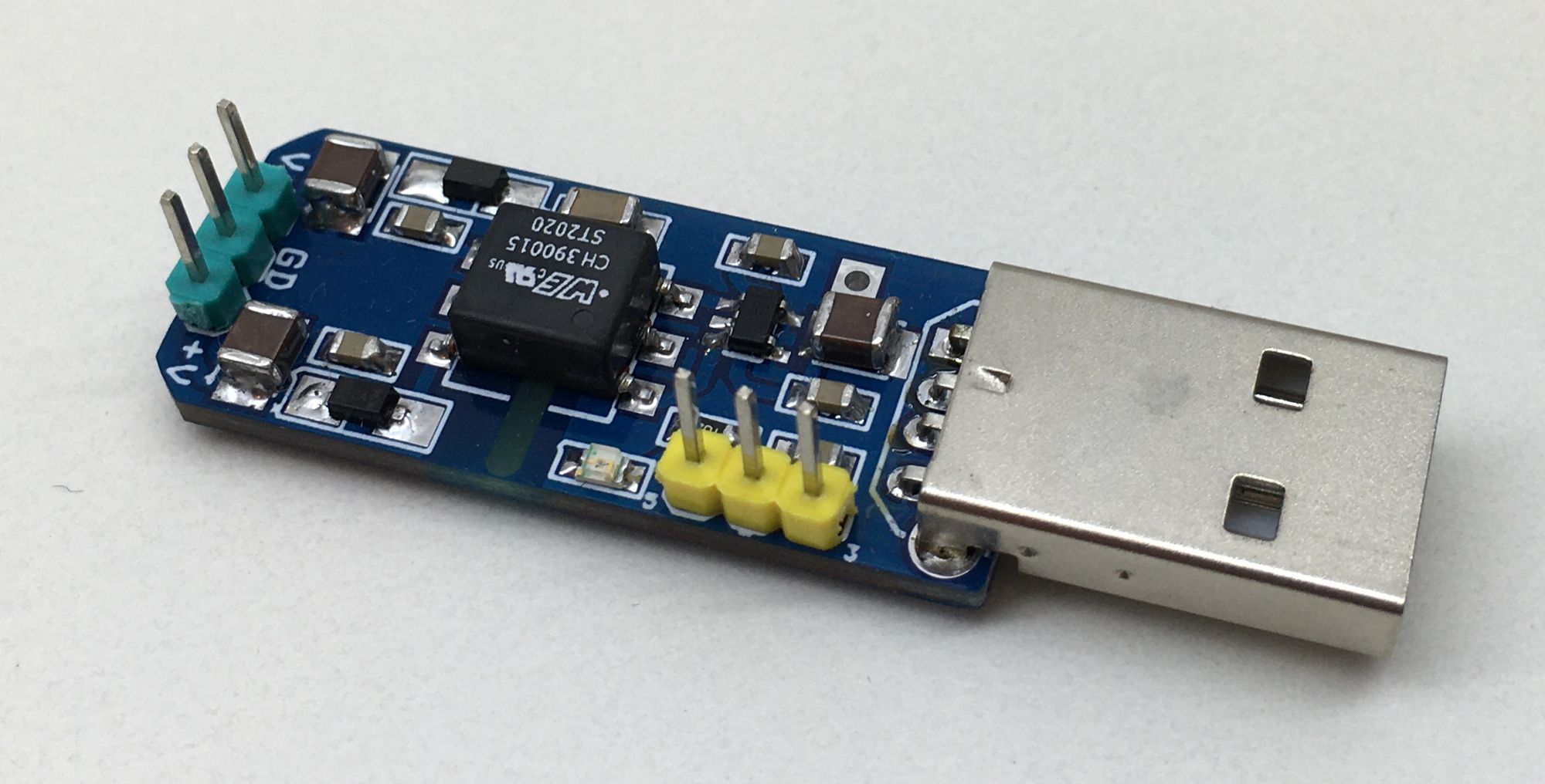

+/-18V Isolated DC-DC Converter Dual Supply Output from USB 5V Power Input
This is a mini DC-DC converter with dual output from single 5V DC supply or USB power source (e.g., +/-18V from 5V/USB). The mini board will fit into small space and perform with high efficiency.
Power by mixos
This is a mini DC-DC converter with dual output from single 5V DC supply or USB power source (e.g., +/-18V from 5V/USB). The mini board will fit into small space and perform with high efficiency. Basically, the circuit transfers power from 5V/USB to the output side +/-18V with high isolation, without a direct connection between 5V/USB power and output. The power isolation prevents ground loops and provides high noise immunity between input and output. The project is based on SN6501 chip, which is oscillator/power-driver, is specifically designed for small factor devices. The device drives a low profile, center-tapped transformer primary from 5V/USB power and secondary side provides unregulated dual output which can be further regulated as per requirement (e.g., +/-5V, +/-12V). Project is a very easy and simple tool to test and run industrial, scientific project, PLC and I/O modules which require dual output from single input. D2 power LED, CN1 USB A type connector for USB power input, CN3 No isolated 3.3V and 5V DC output, CN2 unregulated dual 18V Output.

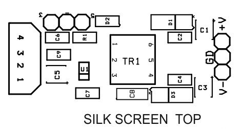

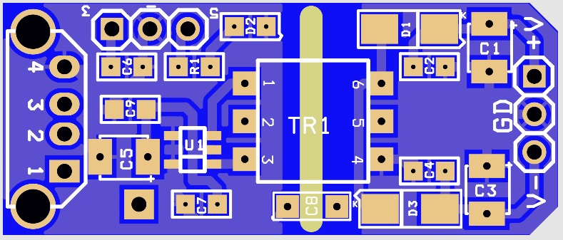

I like this push-pull design,
(Is the C8 really needed ?)

Bryan
The TI app schematics do not show C8. However, the output side isolated ground could get some common mode EMI from the
transformer switching.
Leor Weinstein
It seems a little inadequate to place a 16V rated capacitors on the +/-18V outputs, no?
