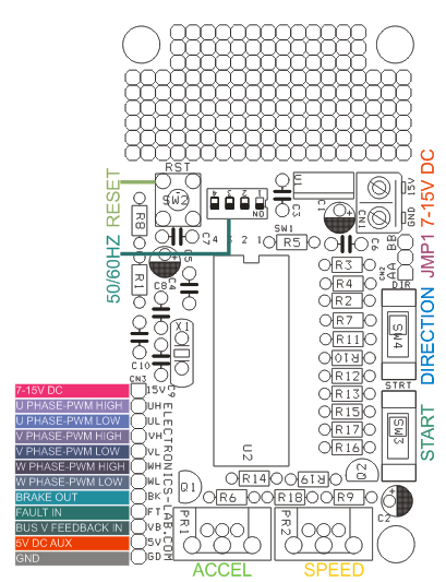

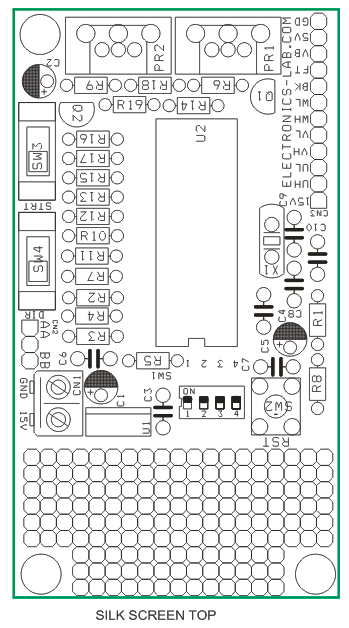

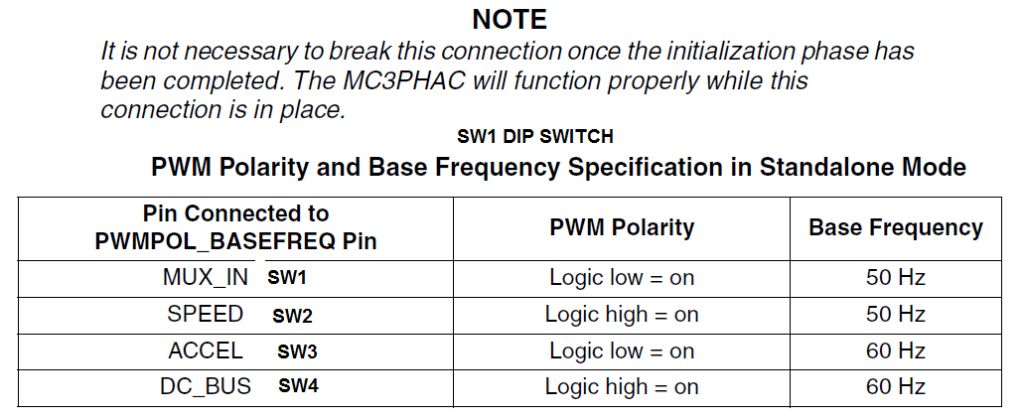

- PR1: Potentiometer to set the Acceleration
- PR2: Potentiometer for speed adjust
- SW1: DIPX4 Switch to set the Frequency 60Hz/50Hz and Also Active low/Active High Output
- SW2: Reset Switch
- SW3: Start/Stop Motor
- SW4: Direction Change CW/CCW of the Motor
- CN1: DC Supply Input 7-15V DC
- CN2: Bus Voltage Feed from IPM/IGBT Module for Over/Under Voltage Protection
- CN3: Interface between IPM Module/IGBT Board Provides 6PWM Out, Brake out and Fault In
- PCB has prototype area that can be used for development.

HI, how to Adjust pwm Frequency
Check on page 11 of datasheet above. There is a table indicating how to choose the desired frequency.

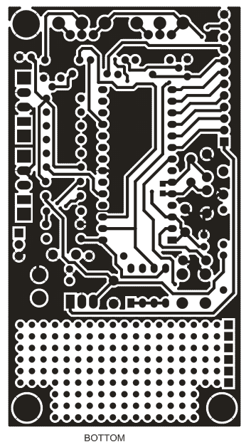

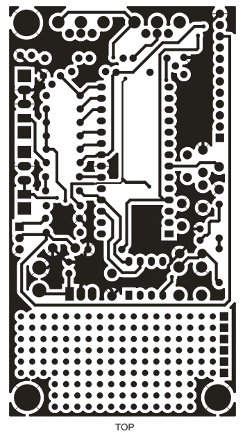

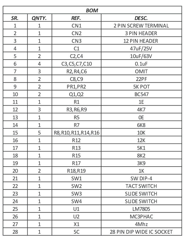

Hi I am interested in this pcb what is the cost how can i purchase the pcb and companents thanks
In case that I’m not mistaken, you’ll have to make the PCB yourself, and obtain the components for yourself too.
You have several options to make the PCB in several CAD programs.
JLCPCB have an online editor, in which you can import schematics and layouts from various formats.
I would recommend using JLCPCB since they’re cheap, and have a most excellent support staff, but you’ll have to make sure your layout complies with their standards.
So, if you’re unable to do it yourself, ask someone to help you to meet their demands.
But, if you want a faster way of making a PCB, you can always buy one with photo-resist, and some Overhead sheets (Transparent film) and print out these layouts above, expose with UV-lamp, etch and then drill. Not the most easy thing to do, given it’s double sided and need some thinking of how do get it right.
