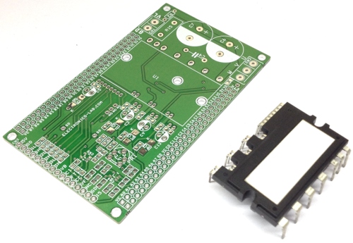

This board is designed to evaluate Fairchild Semiconductor’s FSBS5CH60. The motion SPM is installed as the motor power module on the board to drive a three-phase AC Induction Motor (ACIM), Brushless DC (BLDC) motor, Brushless AC (BLAC) motor, or Permanent-Magnet Synchronous Motor (PMSM). The board has bulk capacitors and microcontroller (MCU) interface circuitry. As this board is designed for a wide variety of motor types, not all included circuitry is required for all types of motors. Some motor types may require some additional circuitry be added, depending on the control algorithms being implemented.
The board is designed to connect DC power sources feeding current to the motor. The three-phase motor output terminals (U-M1, V-M2, W-M3) from the screw terminal should be connected to the motor windings. Three bootstrap power supply circuits are designed into the board, one per phase. A bootstrap capacitor, charge resistor for charging the capacitor, and the blocking diode for high-voltage isolation make up each bootstrap supply. The microcontroller (MCU) or motion-controller development board connects to this IPM board via the provided 16 Pin header connector. Six low-pass filters are used between the signal input connector and the gate input signal pins of the IC. Short-circuit current protection is provided by a single shunt resistor, op-amp, and low-pass filter. Additional resistor divider circuitry is included to monitor bus voltage, inverter phase current, and module temperature.
This board is made for low voltage motor up to 90V DC load up to 5Amps, however it can be used for higher voltage motor up to 400V DC by changing bulk capacitor, refer note for more details. Two 4mm holes were provided to mount the heat sink on top of the IC. The board also works with 28-40 Pin PIC Micro-Controller and dsPIC shield which helps easy interface with many PIC micro-controllers and Motor dsPICs. 16 PIN header connector can be hooked up to any port pin of PIC/dsPIC development board using female to the female wire harness.

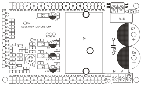

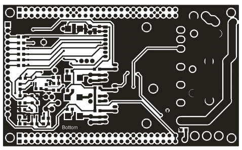

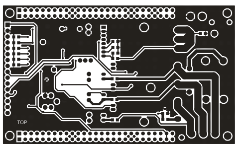

Warning! C9 direction is wrong.
in bottom copper, the line from shunt upper arm had been short circuited to pin 13 Vcc of FSBS5CH60, so +15V is shorted to gnd.
Could you point this to a drawing? I can’t figure our what you are talking about.

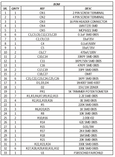

I could not find the resistors R10 R16 2.00E+02 could someone specify what type are they and a link would be very nice.
Thank you.
R4, R10, R16 all are 2.2 Ohms resistors just for overcurrent protection to VCC Pins of each gate driver, they also can be replaced with 0 Ohms
las dos tierra del pin COM y el pin N del integrado tienen que ir separadas, eso lo dice la nota AN9035 de On semiconductor que trata de los integrados FSBxxCH60.
The two ground of the COM pin and the N pin of the integrated have to be separated, that says the note AN9035 of On semiconductor that deals with the FSBxxCH60 integrated.

What is OMIT Capacitor please tell
OMIT means do not place.
What is 2.00E+02 in part no 25 ie.R10, R16 Please tell.
It’s 2.2Ω SMD 0805, fixed on the BOM List
