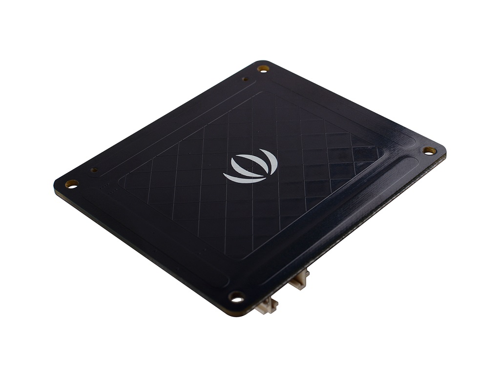

3D Gesture Tracking Shield
3D tracking has been one of the easiest ways of implementing Natural User Interfaces into devices as it allows users to interact with physical objects without touching them. This is exactly the capability that the Seeed 3D Gesture shield brings to the raspberry pi. This shield is based on the Microchip MGC3130 chip, which enables the Raspberry Pi with 3D gesture recognition and motion tracking function. It can capture x y z position information, can also do proximity sensing and touch sensing, support tap, and double click. As shown in the figure below, the recognition area is divided into two parts: the strip area distributed around and a central panel.
The strip areas can sense the orientation change, including the North, South, West, and East. The central area can sense touch, tap, double click, and gestures in the air area above the shield.
3D movements and gestures are detected by the shield using electrical near field sensing in line with Microchip’s patented GestIC® technology. The shield generates a magnetic field above the central panel and when the hand approaches, it will interfere with that magnetic field, and the magnetic field receiver below the shield will detect the change.
This hat communicates with Raspberry Pi via the I2C interface and also it has reserved a Grove I2C connector in case you need to work with other modules.
Some of the features of the shield include;
  • Recognition of 3D Hand Gestures and x, y, z Positional Data
  • Proximity and Touch Sensing
  • Built-in Colibri Gesture Suite (running on-chip)
  • Advanced 3D Signal Processing Unit
  • Detection Range: 0 to 10 cm
  • On-chip Auto Calibration
  • Compatible with various models of Raspberry Pi 2, 3, 4, and zero

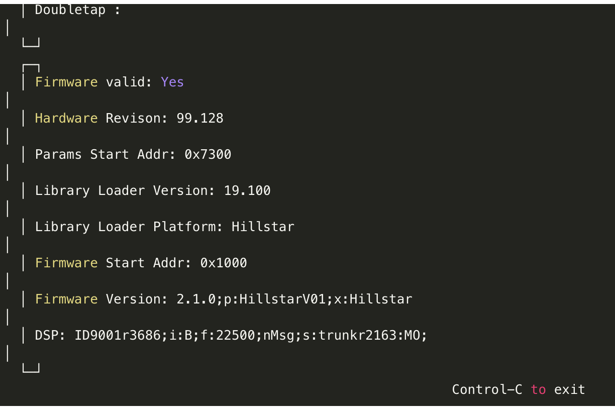

With this done, you can test the installation by running;
ncurses6-config --version
This should give you some information on the version of ncurses installed, or throw an error if it’s not properly installed.
With all the dependencies installed, you can now proceed to download the MGC3130 python library by Linux-Downey. Do this by changing into the home directory and running;
cd ~
git clone https://github.com/linux-downey/seeed_mgc3x30_python.git
change into the library folder, and run the flickrdemo example to test the library installation.
cd seeed_mgc3x30_python
./flick-demo
You should see a result similar to the image below.
With this done, we are now ready to write the code for this project.

    # Clear screen and hide cursor
    stdscr.clear()
    curses.curs_set(0)
    # Add title and footer
    exittxt = 'Control-C to exit'
    title = '**** Flick Demo ****'
    stdscr.addstr( 0, (curses.COLS - len(title)) / 2, title)
    stdscr.addstr(22, (curses.COLS - len(exittxt)) / 2, exittxt)
    stdscr.refresh()
    fw_info = flicklib.getfwinfo()
    datawin = curses.newwin( 8, curses.COLS - 6,  2, 3)
    fwwin   = curses.newwin(10, curses.COLS - 6, 11, 3)
    # Fill firmware info window.
    fwwin.erase()
    fwwin.border()
    fwwin.addstr(1, 2, 'Firmware valid: ' + 'Yes' if fw_info['FwValid'] == 0xaa else 'No')
    fwwin.addstr(2, 2, 'Hardware Revison: ' + str(fw_info['HwRev'][0]) + '.' + str(fw_info['HwRev'][1]))
    fwwin.addstr(3, 2, 'Params Start Addr: ' + '0x{:04x}'.format(fw_info['ParamStartAddr']))
    fwwin.addstr(4, 2, 'Library Loader Version: ' + str(fw_info['LibLoaderVer'][0]) + '.' + str(fw_info['LibLoaderVer'][1]))
    fwwin.addstr(5, 2, 'Library Loader Platform: ' + 'Hillstar' if fw_info['LibLoaderPlatform'] == 21 else 'Woodstar')
    fwwin.addstr(6, 2, 'Firmware Start Addr: 0x' + '{:04x}'.format(fw_info['FwStartAddr']))
    fwver_part1, fwver_part2 = fw_info['FwVersion'].split(';DSP:')
    fwwin.addstr(7, 2, 'Firmware Version: ' + fwver_part1)
    fwwin.addstr(8, 2, 'DSP: ' + fwver_part2)
    fwwin.refresh()

With the code complete, we can now proceed to try things out.
Demo
Save the code with whatever name you desire and run it. you should now be able to control the robotic hand by moving your hand in a different direction over the 3D Gesture tracker.
Demo
To better understand how the hand movements work, you can watch the video below to see the project in action.
