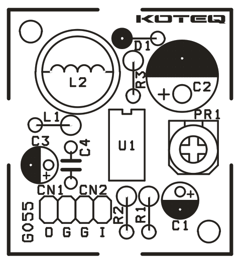

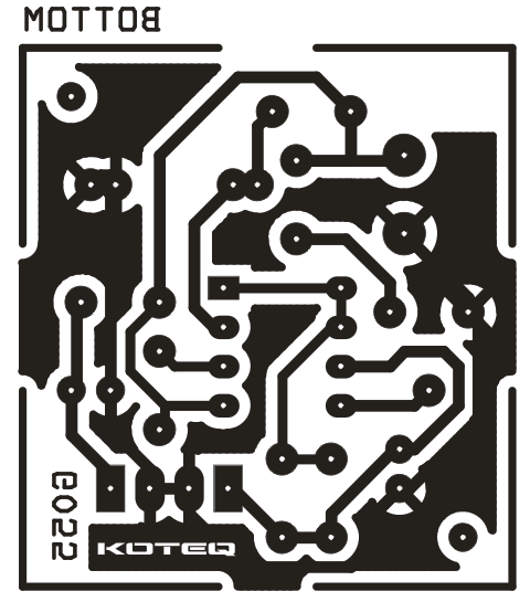

- PCB Dimensions 31.75mmX34.93MM

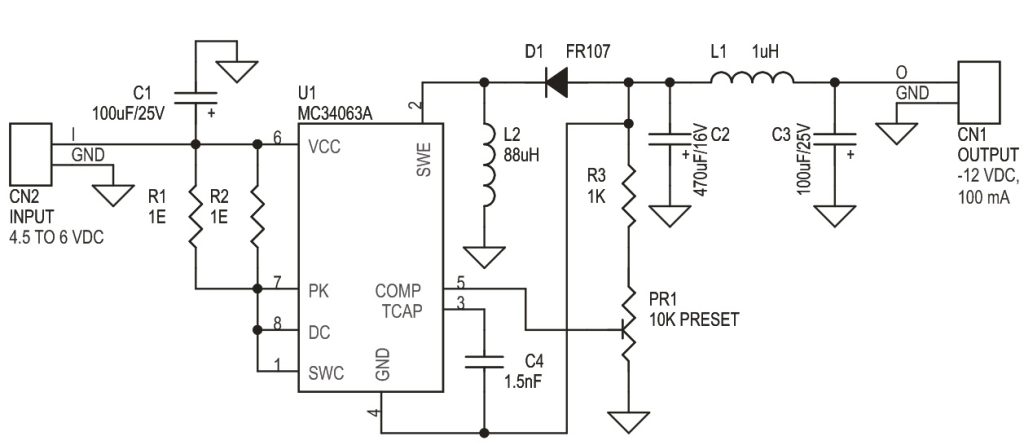

PR1=Output Voltage Adjust
CN1=Output -12V 100mA (Negative 12V)
CN2=Supply Input 4.5V to 6V DC
Schematic
Hello Rajkumar, Is there any reason why I can’t apply a greater input voltage? What I need is a +9V to -9V voltage inverter. Thanks, mike
According to the datasheet the input voltage can be in the range of 4-6V in the inverting configuration.
Thanks, yes I saw that in the datasheet but still can’t understand why. Shall have to build one and see what happens.
my output is not -12, but its increasing in minus ,,, reaching -24 and its going on , whats the reason ??
Please check for correct parts alignment, especially for D1 diode and capacitors and for correct voltage feedback to the IC (the resistor divider that goes to PIN5)
