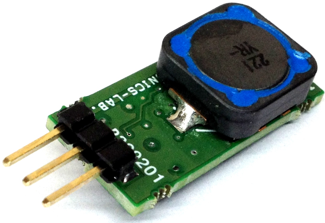

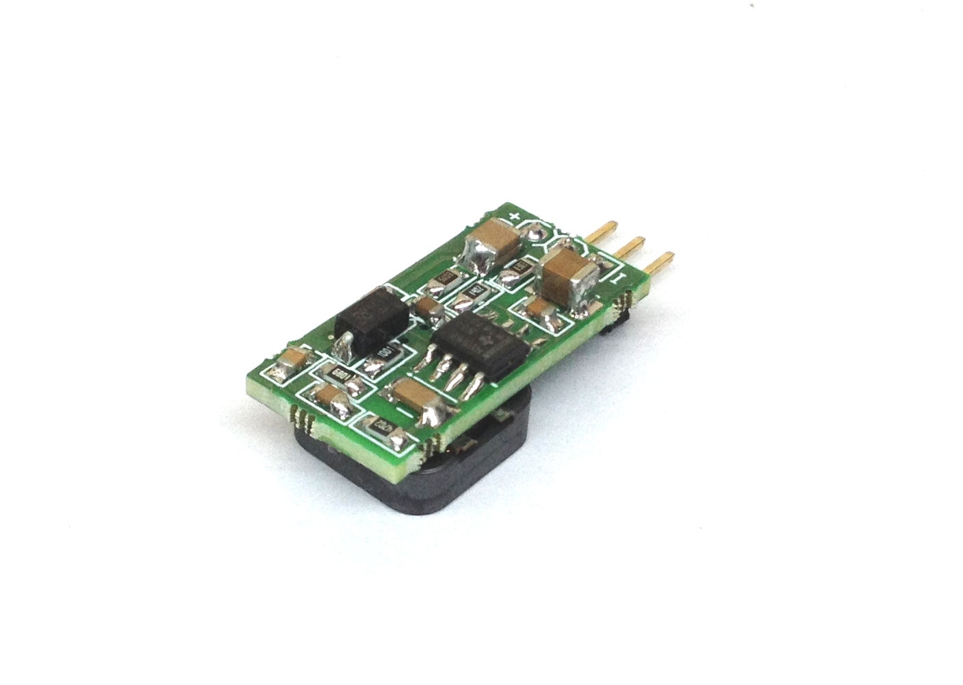

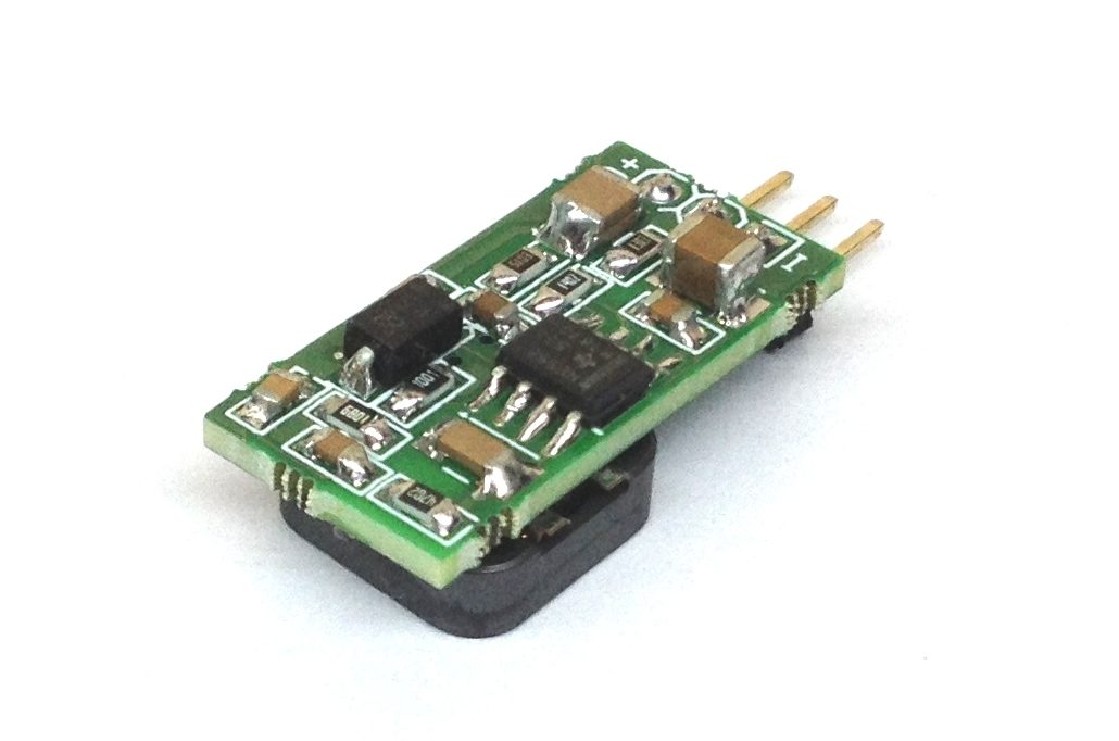

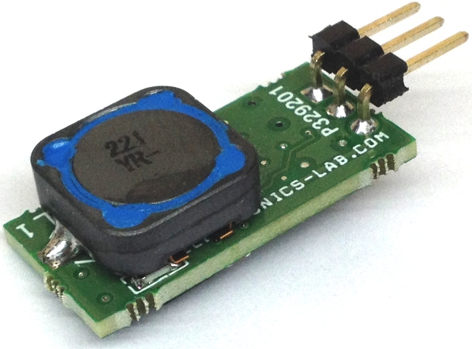

This is a versatile tiny module that provides 10V/500mA from 90V DC input. It is a high voltage input DC-DC buck converter, based on LM5017 IC, which is a 100-V, 600-mA synchronous step-down regulator with integrated high side and low side MOSFETs.
Power by mixos

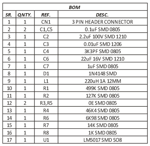

This is a versatile tiny module that provides 10V/500mA from 90V DC input. It is a high voltage input DC-DC buck converter, based on LM5017 IC, which is a 100-V, 600-mA synchronous step-down regulator with integrated high side and low side MOSFETs. The constant on-time (COT) control scheme employed in the LM5017 requires no loop compensation, provides an excellent transient response, and enables very high step-down ratios. The ON-time varies inversely with the input voltage resulting in nearly constant frequency over the input voltage range. A high voltage startup regulator provides bias power for the internal operation of the IC and for integrated gate drivers. A peak current limit circuit protects against overload conditions. The under-voltage lockout (UVLO) circuit allows the input under-voltage threshold and hysteresis to be independently programmed. Other protection features include thermal shutdown and bias supply under-voltage lockout (VCC UVLO). Supply input range 13V to 90V, provides 10V/500mA, switching frequency 225 KHz. Adjustable output voltage possible by altering Resistor R6 and R8 value, refer data sheet. Under-Voltage lockout set to 12.4V.

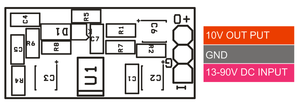

  • Adjustable Under voltage Lockout (UVLO) (Set to 12.4V)

Parts List
Connections
Photos
