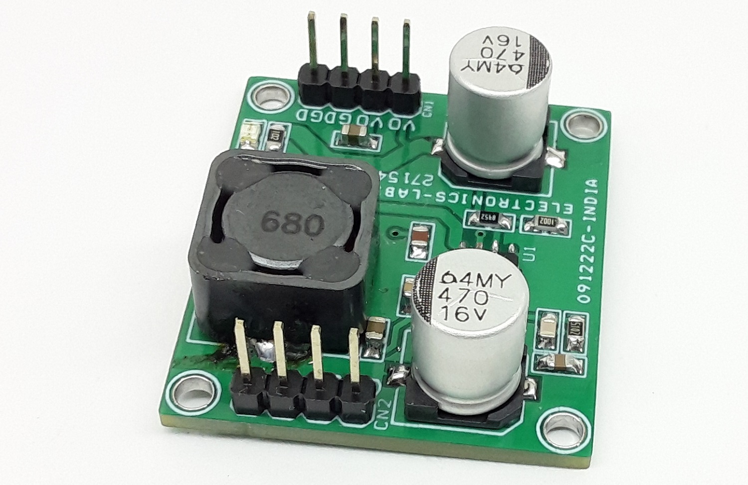

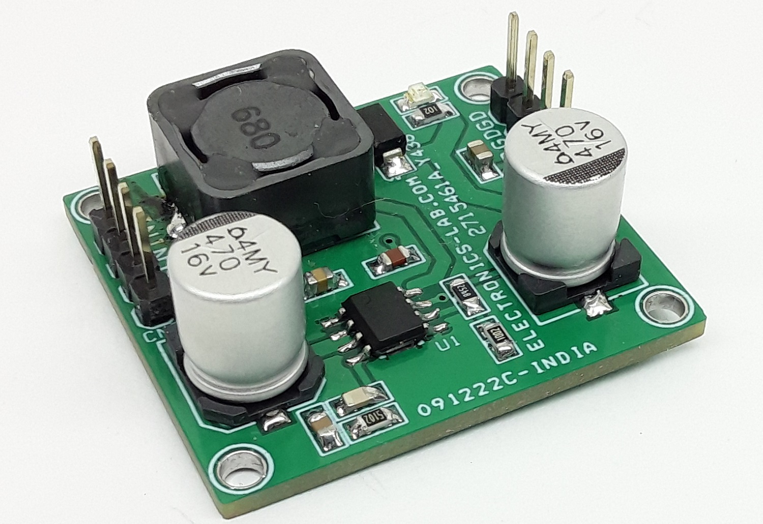

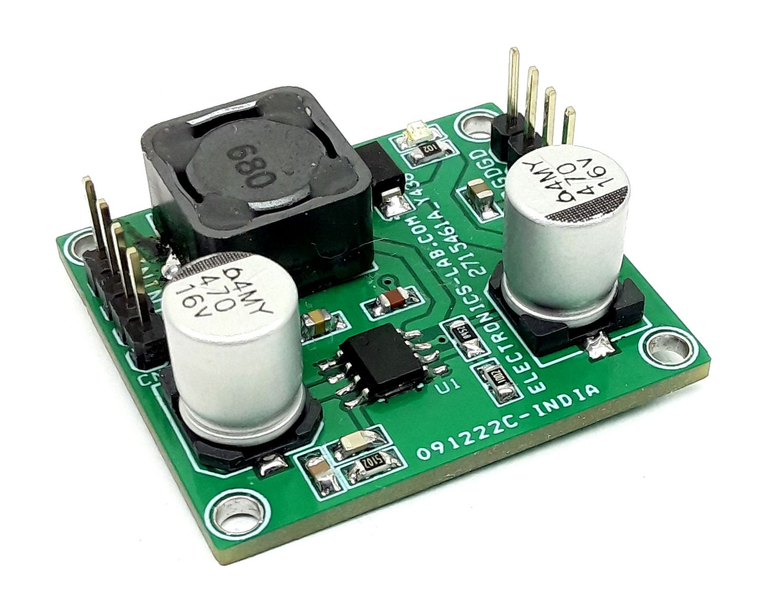

Step Up DC-DC Converter 12V Output – 5V Input

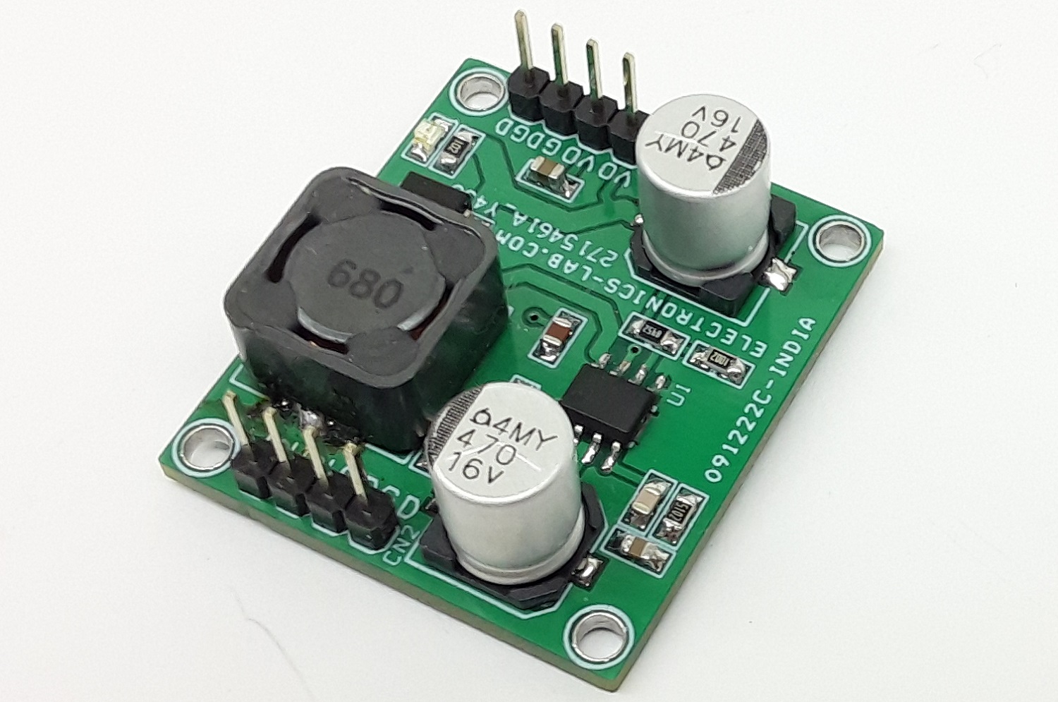

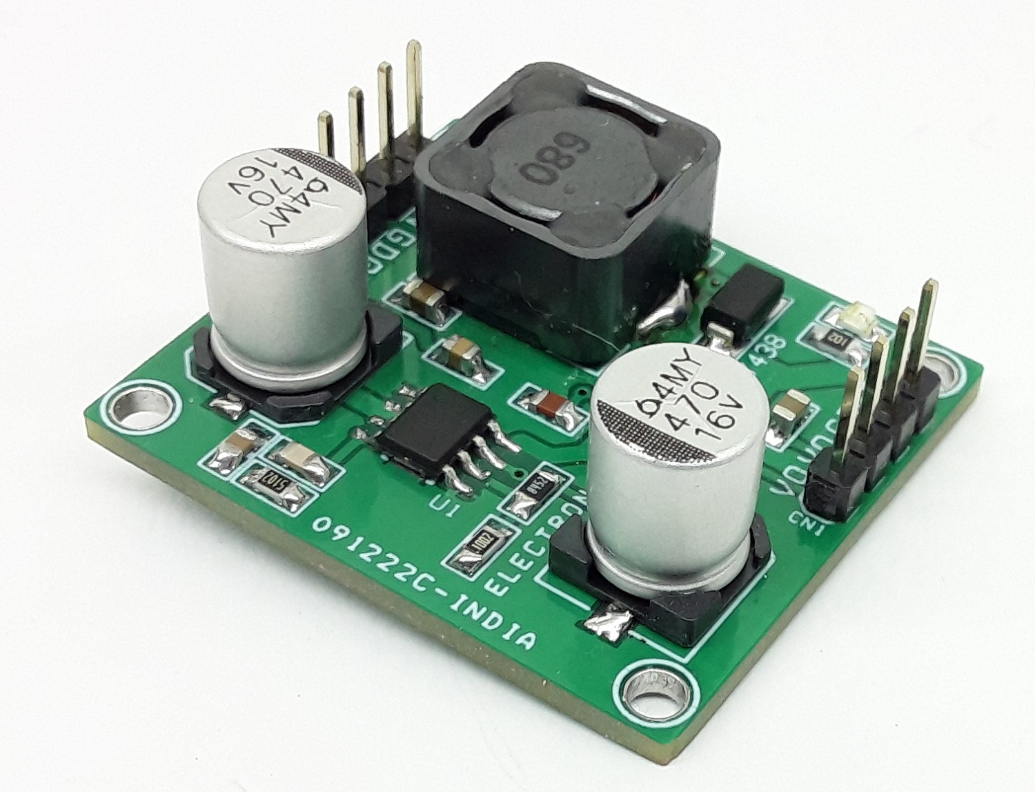

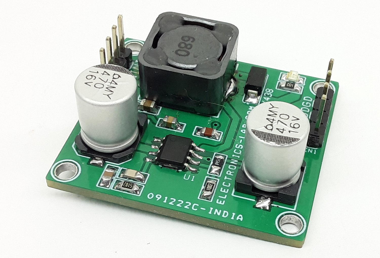

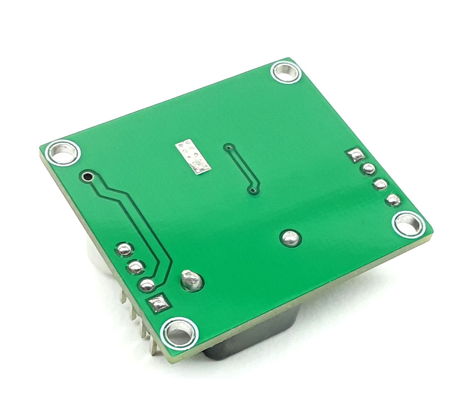

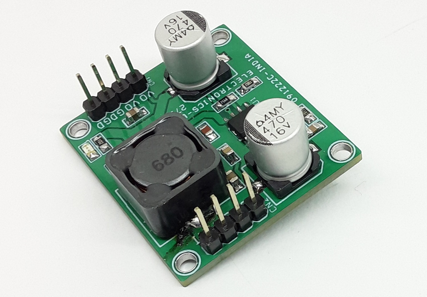

This high-performance, fixed frequency, current-mode PWM step-up DC/DC converter efficiently produces 12V from input voltages between 3.6V to 5.5V. The project is built using the PAM2423 chip, which includes an integrated power MOSFET that supports a peak current of up to 5.5A.
This high-performance, fixed frequency, current-mode PWM step-up DC/DC converter efficiently produces 12V from input voltages between 3.6V to 5.5V. The project is built using the PAM2423 chip, which includes an integrated power MOSFET that supports a peak current of up to 5.5A. The IC utilizes simple external loop compensation allowing optimization between component size, cost, and AC performance across a wide range of applications. Additional functions include an externally programmable soft-start function for easy inrush current control, internal over-voltage protection (OVP), cycle-by-cycle current limit protection, under-voltage lock-out, and thermal shutdown.
- Input Supply 5V DC (Range 3.6V to 5.5V)
- Output 12V DC
- Load Current Up to 500mA
- Output Power LED

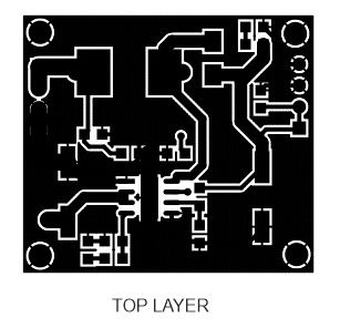

- PCB Dimensions 35.08 X 31.12MM
- Efficiency Up to 90%
- Operating Frequency 520Khz
- Soft-Start Function
- Built-in Over-Voltage Protection (OVP)
- Under-Voltage-Lockout
- Under Voltage Lockout Threshold 2.5V, Hysteresis 200mV
- Over-Current Protection – Threshold 5.5A
- Thermal Shutdowns – Threshold 150 Degree Cent.
- 4 X 2.5MM Mounting Holes
- PCB Dimensions 35.08 x 31.12mm

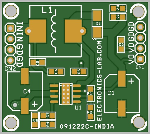

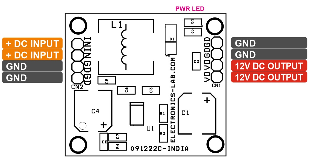

Connections and Other Details
- CN1: Pin 1 & 2 = V-Output 12V DC, Pin 3 & 4 = GND
- CN2: Pin 1 & 2 = V-Input 5V DC, Pin 3 & 4 = GND
- D2: Output LED

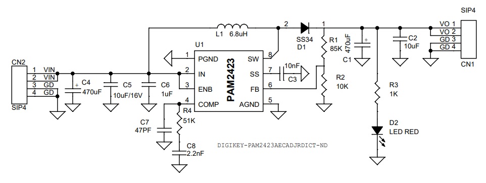

Schematic
Parts List
| NO. | QNTY. | REF | DESC. | MANUFACTURER | SUPPLIER | SUPPLIER PART NO |
| 1 | 2 | CN1,CN2 | 4 PIN MALE HEADER PITCH 2.54MM | WURTH | DIGIKEY | 732-5317-ND |
| 2 | 2 | C1,C4 | 470uF/16V ELECTROLYTIC | UNITED CHEM | DIGIKEY | 565-4278-1-ND |
| 3 | 1 | C2 | 10uF/25V CERAMIC SMD SIZE 0805 | YAGEO/MURATA | DIGIKEY | |
| 4 | 1 | C3 | 10nF/50V CERAMIC SMD SIZE 0805 | YAGEO/MURATA | DIGIKEY | |
| 5 | 1 | C5 | 10uF/16V CERAMIC SMD SIZE 0805 | YAGEO/MURATA | DIGIKEY | |
| 6 | 1 | C6 | 1uF/25V CERAMIC SMD SIZE 0805 | YAGEO/MURATA | DIGIKEY | |
| 7 | 1 | C7 | 47PF/50V CERAMIC SMD SIZE 0805 | YAGEO/MURATA | DIGIKEY | |
| 8 | 1 | C8 | 2.2nF/50V CERAMIC SMD SIZE 0805 | YAGEO/MURATA | DIGIKEY | |
| 9 | 1 | D1 | SS34 | TAIWAN SEMI | DIGIKEY | 1801-SS34TR-ND |
| 10 | 1 | D2 | LED RED SMD SIZE 0805 | OSRAM | DIGIKEY | 475-1278-1-ND |
| 11 | 1 | L1 | 6.8uH 10.4 X 10.4MM | EPCOS-TDK | DIGIKEY | 495-1808-1-ND |
| 12 | 1 | R1 | 85K 1% SMD SIZE 0805 | YAGEO/MURATA | DIGIKEY | |
| 13 | 1 | R2 | 10K 1% SMD SIZE 0805 | YAGEO/MURATA | DIGIKEY | |
| 14 | 1 | R3 | 1K 5% SMD SIZE 0805 | YAGEO/MURATA | DIGIKEY | |
| 15 | 1 | R4 | 51K 1% SMD SIZE 0805 | YAGEO/MURATA | DIGIKEY | |
| 16 | 1 | U1 | PAM2423 SOIC8 | DIODE INCORP | DIGIKEY | PAM2423AECADJRDICT-ND |
