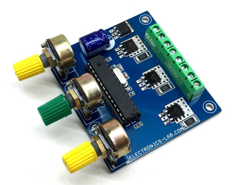

Make a control board. A control board is the pattern to control the flash of the LED strips. Aided by Arduino Nano and equipped with a keypad, we can control the LED strip to display different pattern.

Step 2.5) Welding
It is very easy to make a control board. Just as the following picture described, as soon as the components are welded, it is completed.
