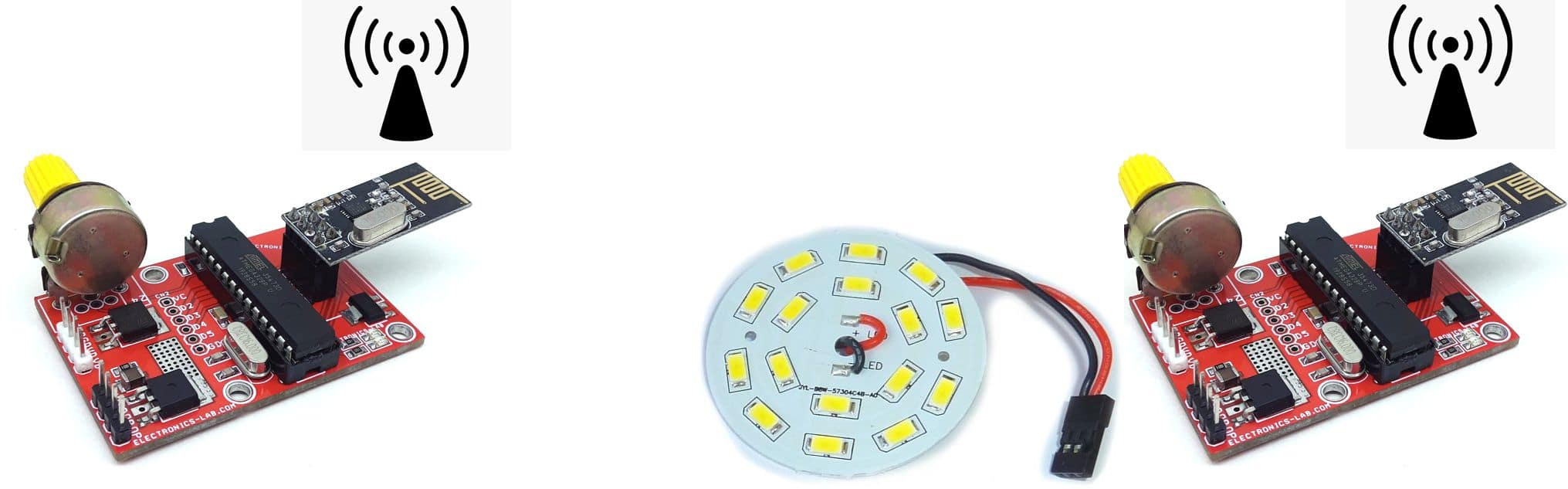

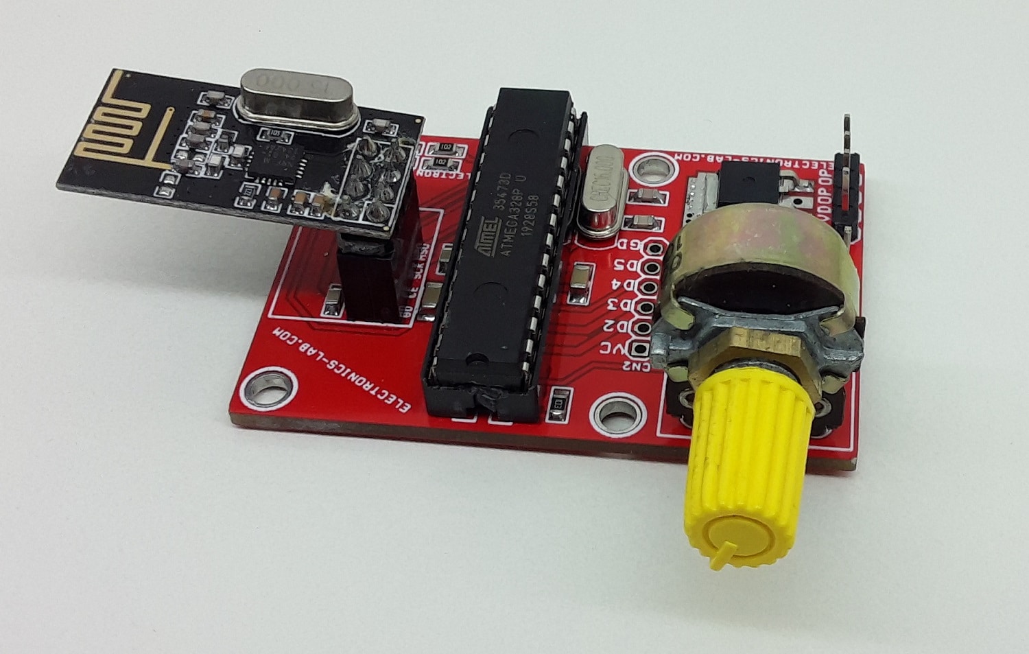

This is an easy-to-make LED dimmer using RF remote control. The project is capable of driving a load up to 24W (2A X 12V LED).

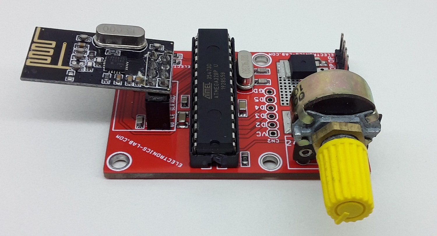

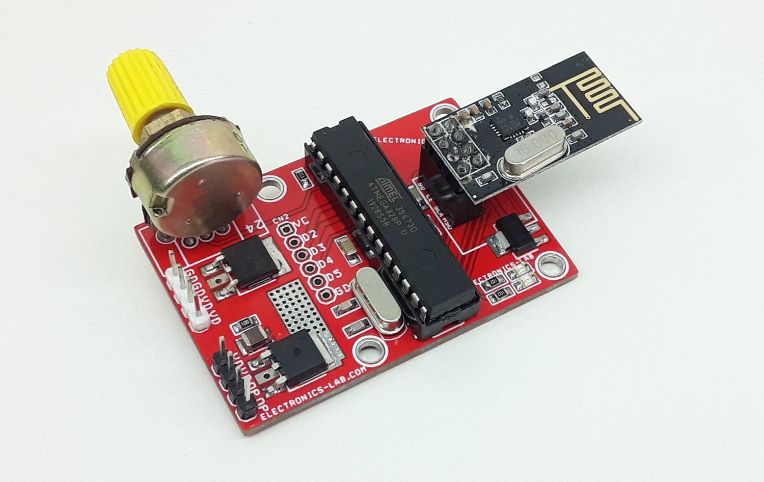

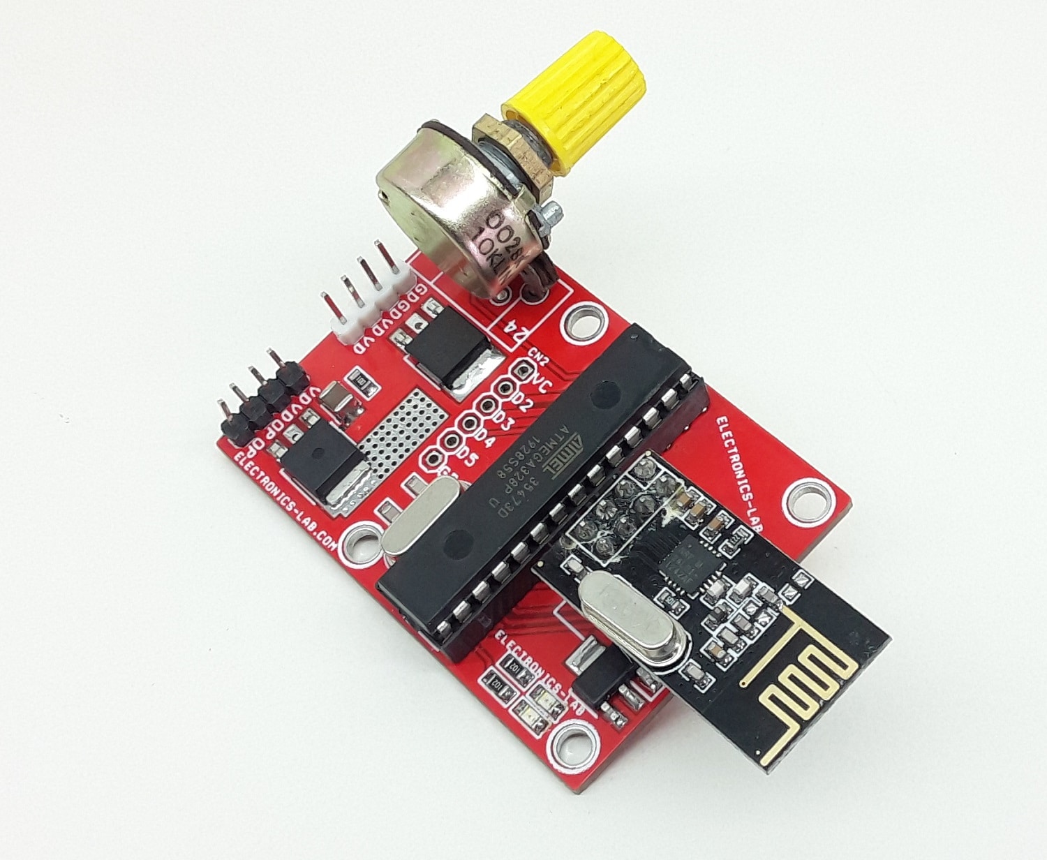

This is an easy-to-make LED dimmer using RF remote control. The project is capable of driving a load up to 24W (2A X 12V LED). Any 12V single or 12V LED strip can be used. This is an open-source Arduino compatible hardware that has Atmega328 microcontroller, Potentiometer, MOSFET, 5V Regulator, 3.3V Regulator, NRF24L01 Radio modules, and few other components. The same PCB can be used for Transmitter and Receiver. LED D2 Power LED, LED D1 optional.

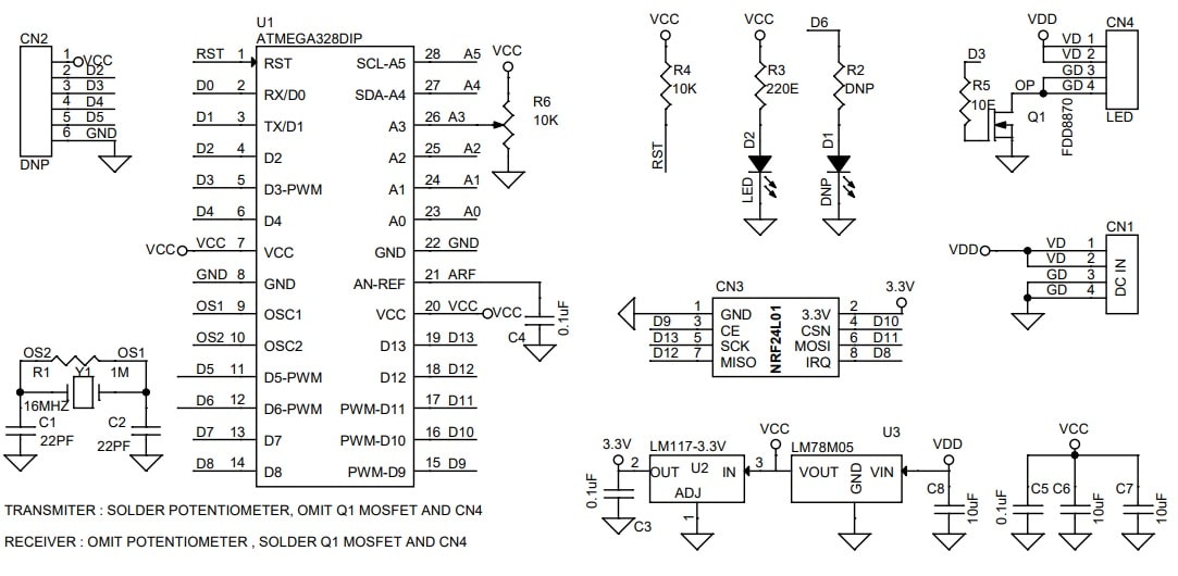

Arduino Pins Transmitter
  • NRF24L01 RF Module: GND>>GND, 3.3V>>3.3V Regulator, CE>> Arduino Digital Pin D9, CSN>> Arduino Digital Pin D10, MOSI>>Arduino Digital Pin D11, MISO>> Arduino Digital Pin D12, CSK>>Arduino Digital Pin D13
  • Potentiometer: Analog Pin A3
Arduino Pins Receiver
  • LED Driver MOSFET Gate: Digital Pin D3

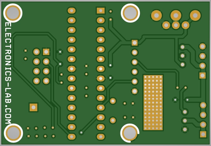

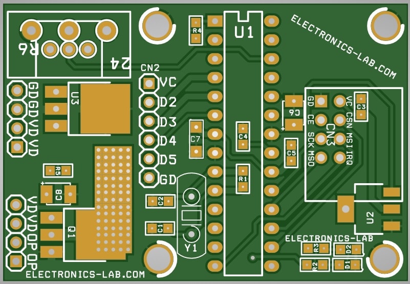

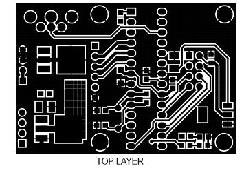

Note: PCB has dual options, it can be used for transmitter and receiver, for transmitter don’t install Q1 MOSFET and CN4 connector, for receiver don’t install potentiometer. Upload the related Arduino code that is available as a download.

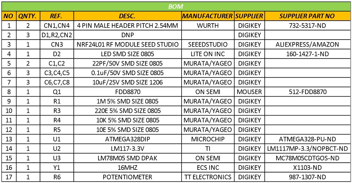

Parts List
NOQNTY.REF.DESC.MANUFACTURERSUPPLIERSUPPLIER PART NO
12CN1,CN44 PIN MALE HEADER PITCH 2.54MMWURTHDIGIKEY732-5317-ND
23D1,R2,CN2DNPDIGIKEY
31CN3NRF24L01 RF MODULE SEED STUDIOSEEEDSTUDIODIGIKEYALIEXPRESS/AMAZON
41D2LED SMD SIZE 0805LITE ON INCDIGIKEY160-1427-1-ND
52C1,C222PF/50V SMD SIZE 0805MURATA/YAGEODIGIKEY
63C3,C4,C50.1uF/50V SMD SIZE 0805MURATA/YAGEODIGIKEY
73C6,C7,C810uF/25V SMD SIZE 1206MURATA/YAGEODIGIKEY
81Q1FDD8870ON SEMIMOUSER512-FDD8870
91R11M 5% SMD SIZE 0805MURATA/YAGEODIGIKEY
101R3220E 5% SMD SIZE 0805MURATA/YAGEODIGIKEY
111R410K 5% SMD SIZE 0805MURATA/YAGEODIGIKEY
121R510E 5% SMD SIZE 0805MURATA/YAGEODIGIKEY
131U1ATMEGA328DIPMICROCHIPDIGIKEYATMEGA328-PU-ND
141U2LM117-3.3VTIDIGIKEYLM1117MP-3.3/NOPBCT-ND
151U3LM78M05 SMD DPAKON SEMIDIGIKEYMC78M05CDTGOS-ND
161Y116MHZECS INCDIGIKEYX1103-ND
171R6POTENTIOMETERTT ELECTRONICSDIGIKEY987-1307-ND
