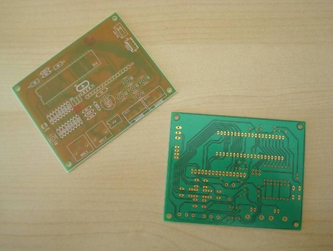

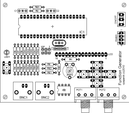

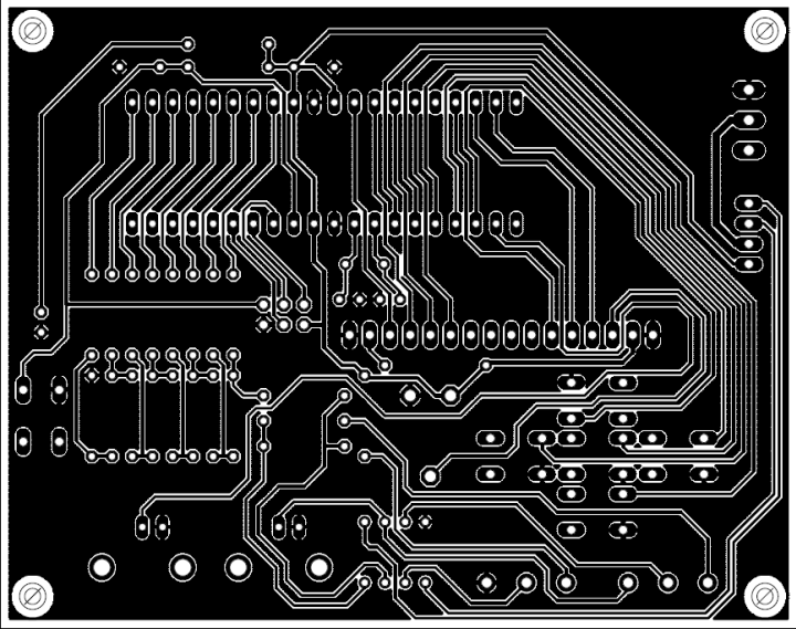

This is a new implementation of the AVR DDS signal generator v2.0, already published in scienceprog.com. It is obvious that full credit for the original schematic and the firmware goes to its original creator. Presented here is a different PCB that is compact, single sided with only through-hole components for easy construction.
The function generator features two BNC outputs : one for the high speed [1 to 8 MHz] square signal (BNC1) and another for the DDS signal (BNC2). Offset and amplitude can be regulated by two potentiometers : offset in range of +5V to -5V (POT1) and amplitude in range of 0 to 10V (POT2). Up and down arrow buttons are used for changing the function type (sine, triangle etc.) while left and right arrow buttons are used for changing the frequency value. There is also a separate menu for changing frequency step. When the middle button is pressed, the signal generation starts. Middle button is pressed again for stopping the signal. More details can be found in the original site.

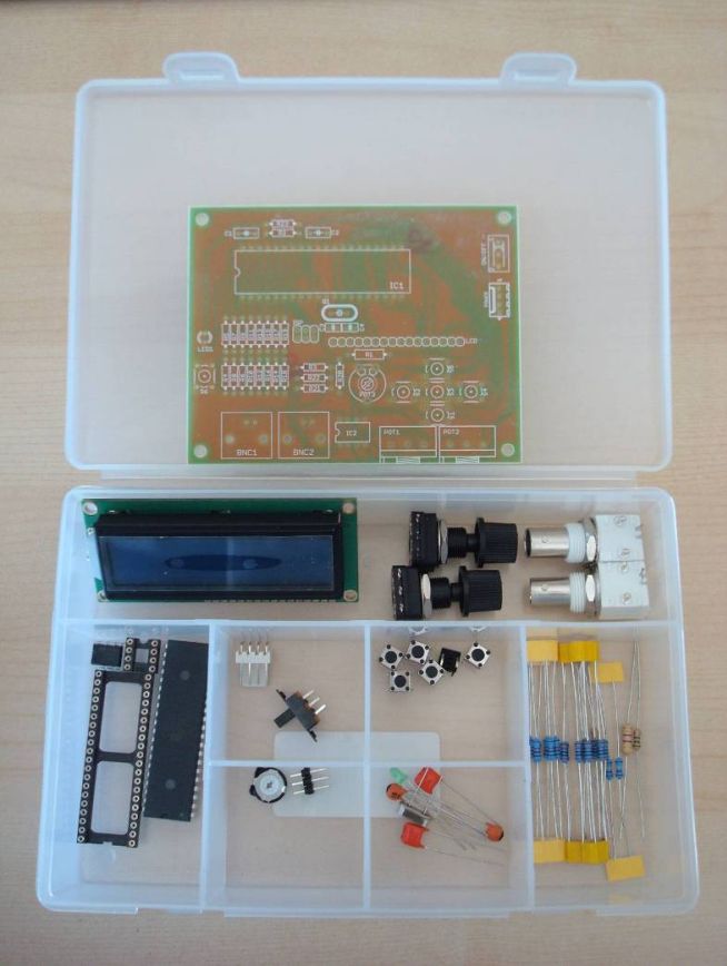

Photos of factory-made PCB and parts
Photo_1
Photo_2

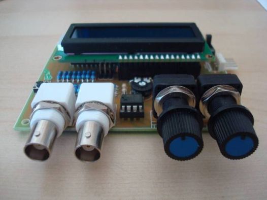

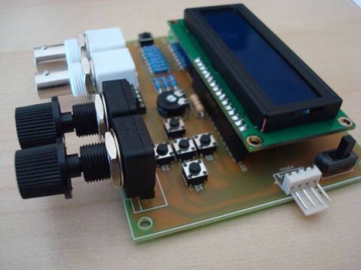

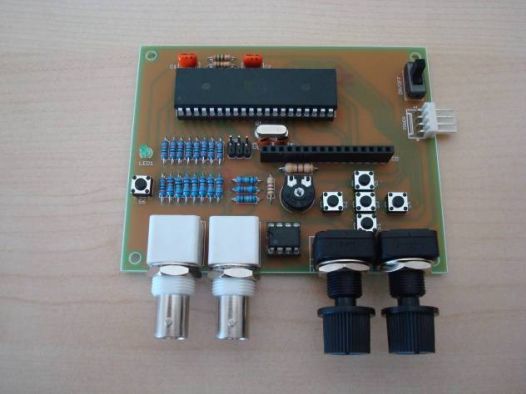

Photos of assembled PCB
Photo_3
Photo_4
Photo_5
Photo_6
Photo_7
Photo_8

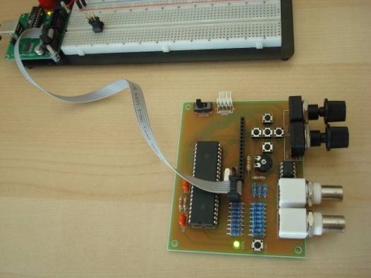

Programming of the ATMEGA16 with usbtiny programmer
Photo_9
Photo_10

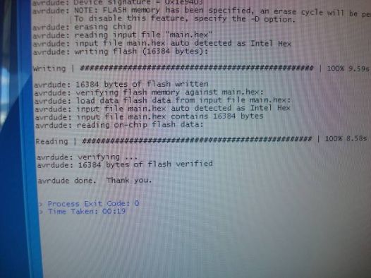

The device firmware can be downloaded from :
http://www.scienceprog.com/avr-dds-signal-generator-v20

The ATMEGA16 fuses should be :
HIGH = 0×59
LOW = 0xCF
This is interpreted to the following options checked (all others unchecked) :
OCDEN
SPIEN
BOOTSZ1
BOOTSZ2
SUT1
SUT0

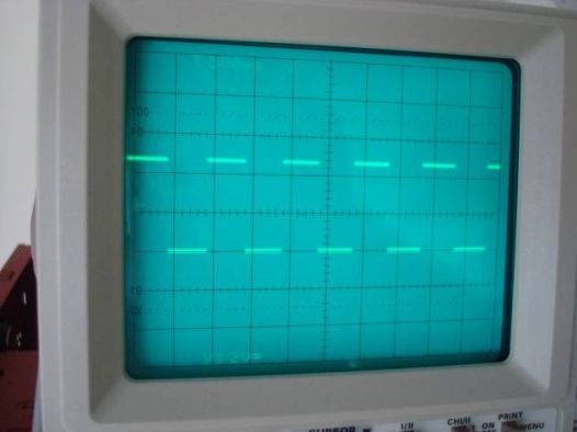

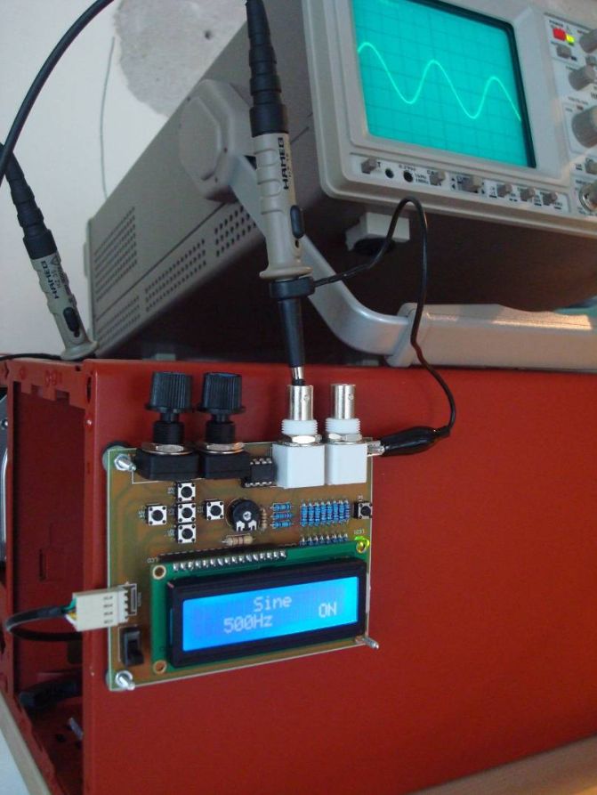

Photos of the device operation
Photo_11
Photo_12
Photo_13
Photo_14
Photo_15
Photo_16
Photo_17

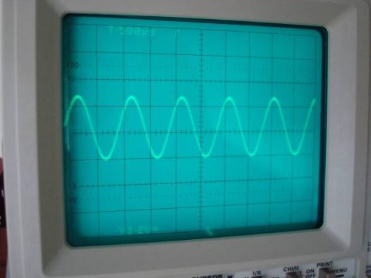

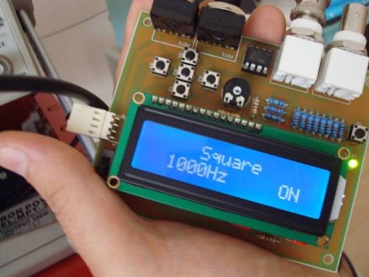

I just bought this on Ebay http://www.ebay.com/itm/1PC-DDS-Function-Signal-Generator-Module-Sine-Square-Sawtooth-Triangle-Wave-Kit-/251768575779?hash=item3a9e939723 which appears to be a fully built kit for sale, using the circuit described on this webpage. Unfortunately, the frequency output is half what it should be (1000Hz signal of any waveform setting gives me a 500Hz signal instead). Is this most likely something that was done wrong by the person who built the kit, or maybe in the firmware for the device has a glitch to start with? Would correcting it be as simple as adjusting the 10kohm trimmer resistor? Or would I need to reprogram the microcontroller to fix this issue? Any help with this would be great. Thanks in advance.
kolja
I bought the same board as you and unfortunately with the identical malfunction!
kolja
i could solve the problem 🙂 .. you have to reflash the controller because the fusebits are wrong. so i had dowloaded the firmware here: http://www.scienceprog.com/avr-dds-signal-generator-v20/, than i flashed ist with a usbtinyisp and avrdude. here the correct commands: avrdude -b 1200 -c usbtiny -p m16 -U flash:w:main.hex:i -U lfuse:w:0xcf:m -U hfuse:w:0x59:m
Jean Iroz
when i assembled my wingoon generator i was given 2 xtals one for16mhz and another for 8 mhz the silkscreen clearly indicate 16mhz. the other xtal was an 8mhz xtal wich if used would result in your issue
