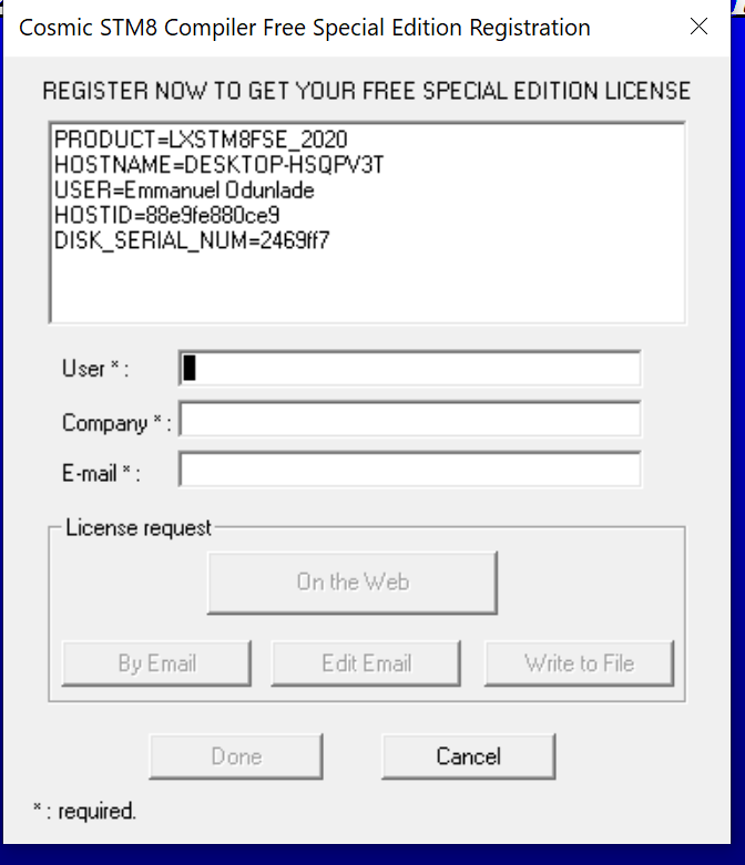

Install the Cosmic C compiler and STVD
To program the microcontroller, we need an IDE and a compiler. As mentioned during the introduction, we will use the Cosmic C compiler and the ST Visual Develop (STVD) IDE. Unfortunately, both software is only available in the Windows OS version so you will need a windows based machine or a partition to install and use them.
Head over to Cosmic and ST websites and download the software. Both software is free to use and will only require you to sign up on the websites to download.

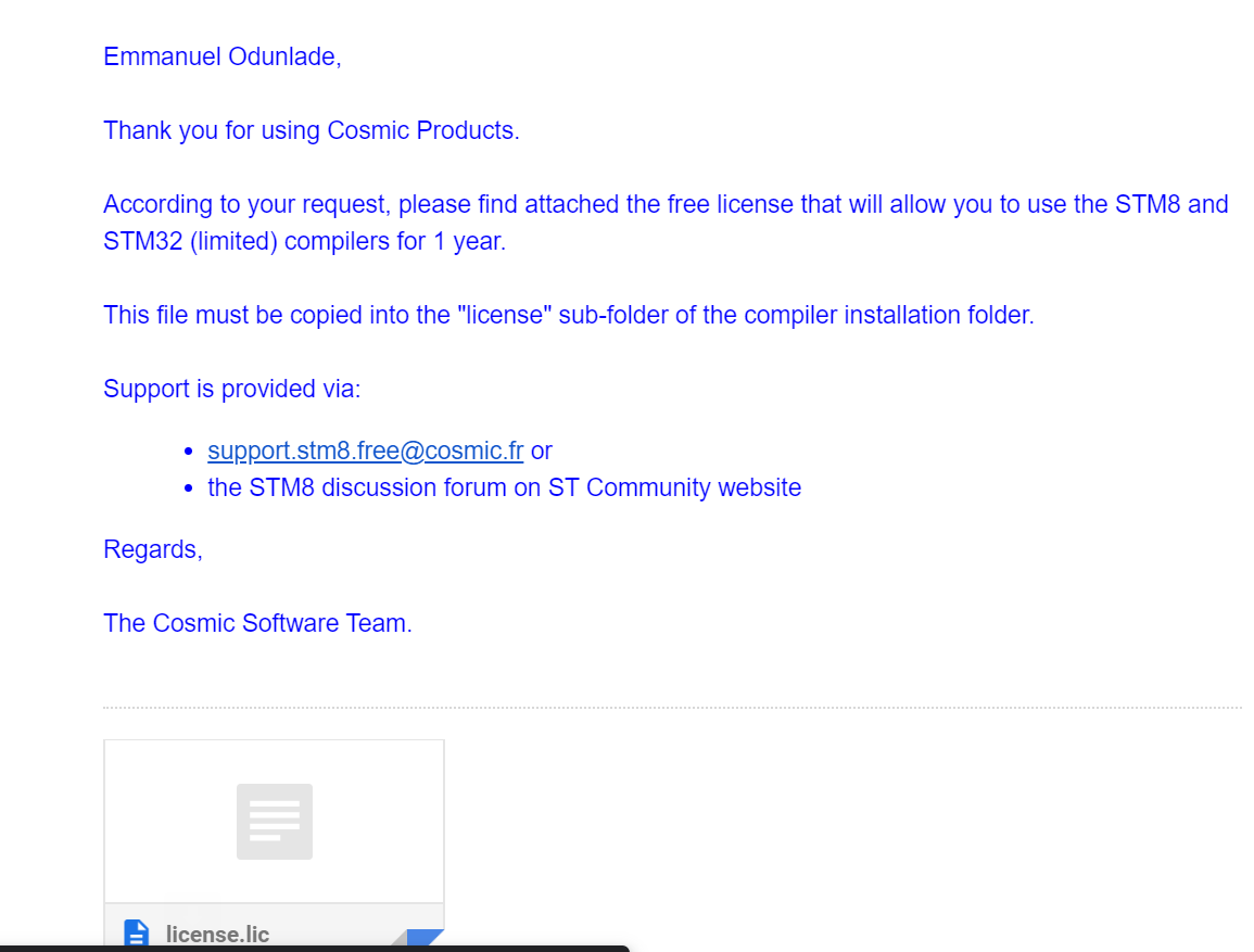

With both software downloaded, run the installation, following the on-screen instructions displayed by the setup wizard. The STVD IDE should install without a fuss, but the Cosmic C compiler will request that you get a free license key, with a prompt that asks for your email address.
The prompt is displayed after a readme file that contains guidelines on use, is closed.
Fill the information requested by the prompt, select the “On the Web” option (if you are connected to the internet), and click on done. This should launch a webpage where you will be required to enter your email address again if not auto-filled. With these complete, you should get a license request processed notification, and receive the license key in your email, a few minutes after submitting the request. Due to spam algorithms, the license email may be “quarantined” in the spam section of your email box. Make sure also to check there.
With the license file received, follow the installation instruction, and copy the license.lic file to the “license” sub-folder of the COSMIC installation folder on your computer. In my case the license sub-folder was located at this path: “C:\Program Files (x86)\COSMIC\FSE_Compilers\CXSTM8\License“.
With this done, both software should now be fully installed and ready for use.

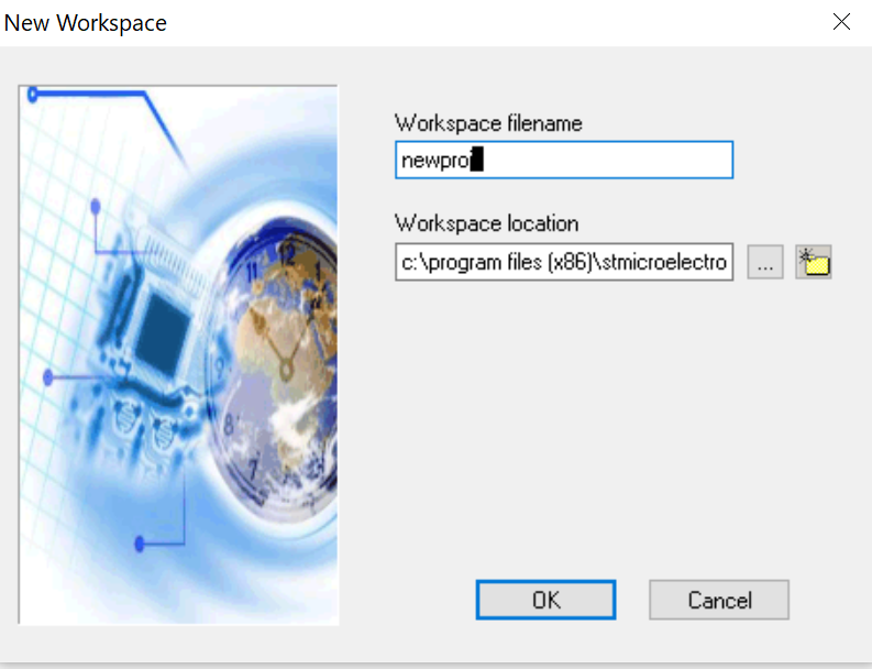

Start by opening STVD and select File -> WorkSpace, in the pop-up, select “New Workspace” and enter the Project name and path where the program should be saved. I am naming my program BareMinimum and saving it in a folder on the desktop. Click OK and you will get the New Project dialog box as shown below.
1. Open the Installed ST Visual Develop and go to File -> “New Workspace” to create a new workspace.
2. On the resulting pop-up box, select the “Create a Workspace and Project” option highlighted in the image below.
3. On the next window, enter your preferred workspace name. I will be calling this “newproj” and will save it in the default location.  Click OK when done.

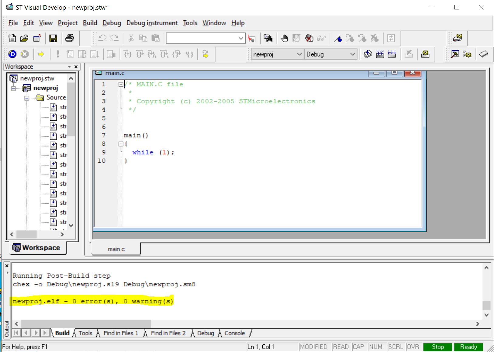

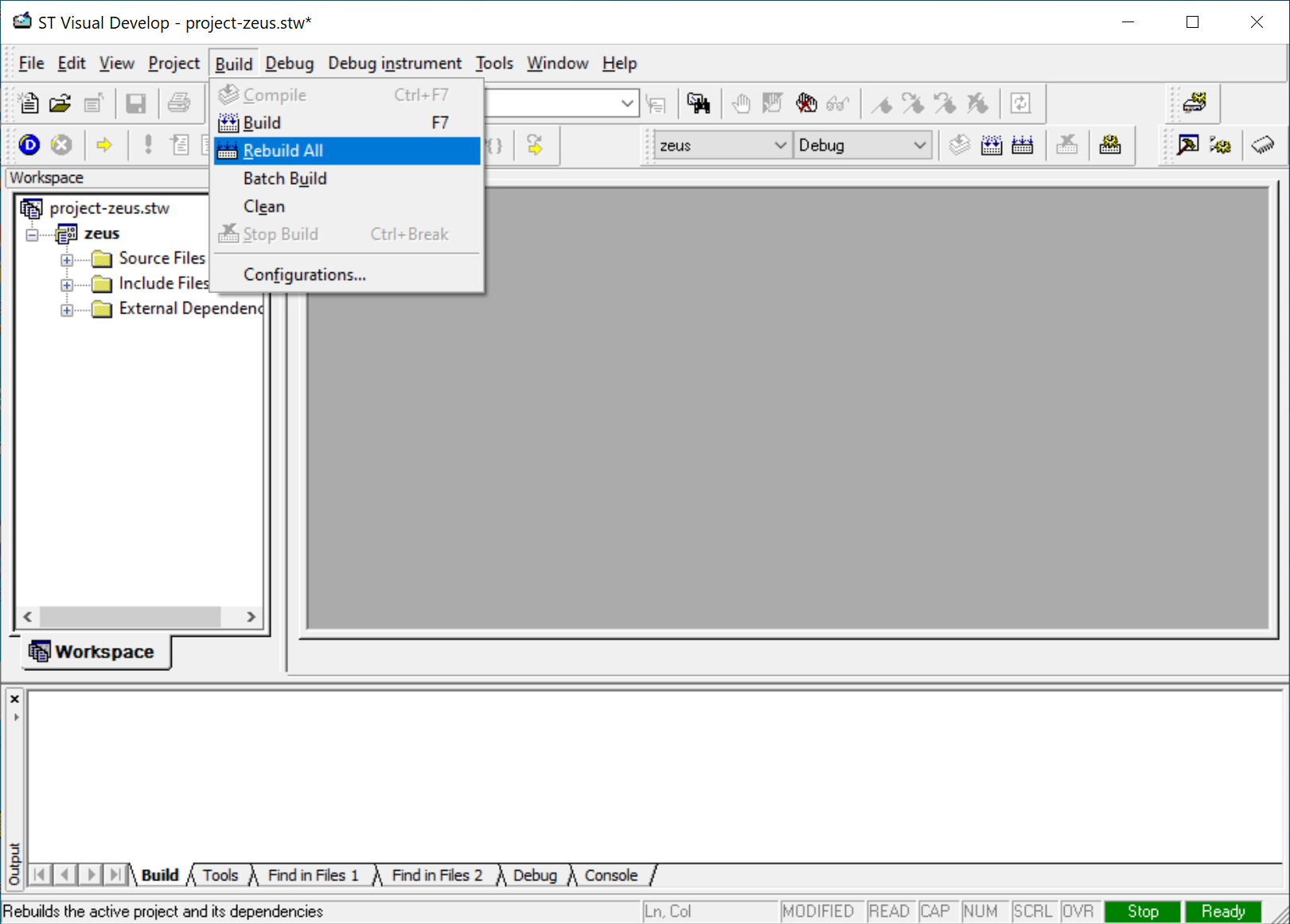

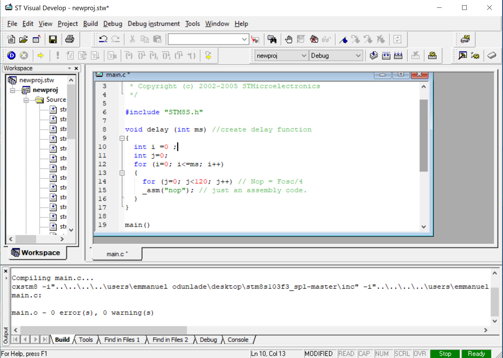

8. Verify library addition and general setup by building. Click on the “build” button and select “rebuild all” followed by the “compile” button.
If the build is successful, you should see “zero build errors” displayed on the command line like in the image below.
With this done you are now ready to start writing the code for our project.

Once the code is complete, click on the Build -> rebuild all and ensure there are no errors. If everything is fine, it should return the “0 errors and o warnings” line. With this done, hit the Compile button. If there are no errors, the program should compile easily and you should see the “0 errors and 0 warnings” in compile success line.

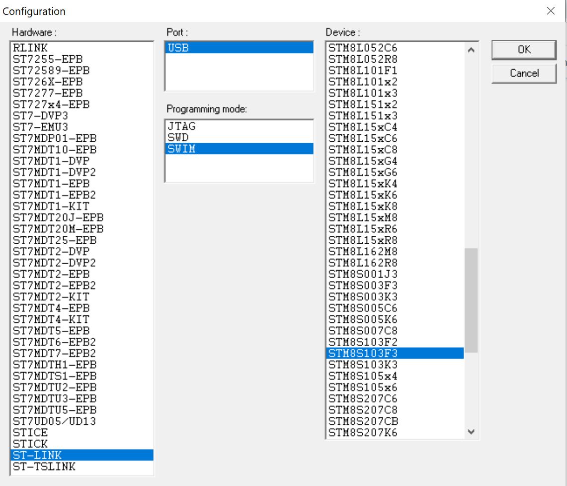

With the successful compiling, a “.s19” file will be generated under the debug directory of the project’s folder.  This file is similar to the Hex file and it’s what you will upload to the microcontroller. To upload the .s19 file to the microcontroller we will use the ST Visual Programmer (STVP) which would have been installed alongside STVD.
When opened, the STVP presents the configuration page shown below. Select the programmer, the programming mode, and the device/microcontroller which in this case are ST-Link, SWIM, and STM8s103F3 respectively.
Hit the OK button when complete. This should launch the STVP interface.
Click on “file->Open” and navigate to the debug folder where you have the .s19 file we generated earlier and open it.  Click on Program” and selectCurrent Tab“. These should begin the flashing process and the firmware should now be loaded on your microcontroller.  If successful, you should see the following line on the command prompt area of the software:
and the LED on the STM8sblue should also start blinking at a pace equal to the 200ms we specified.
