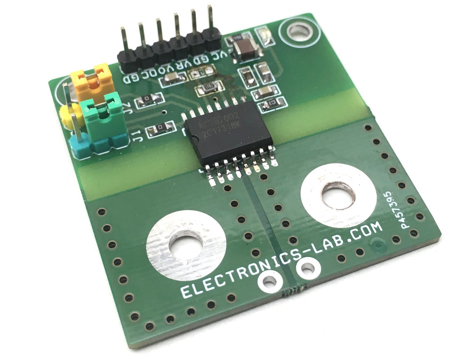

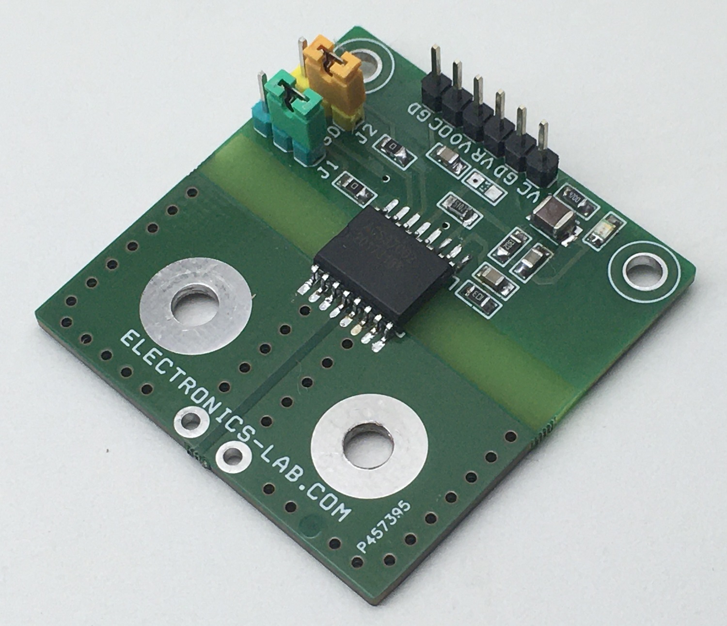

This is a high accuracy current sensor project build using ACS37002 IC from Allegro, which is a fully integrated Hall-effect current sensor with 0.85mOhms integrated conductor. A fast overcurrent alert output, programmable gain settings and analog linear voltage outputs are key features of this project.

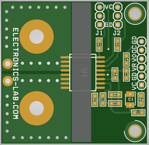

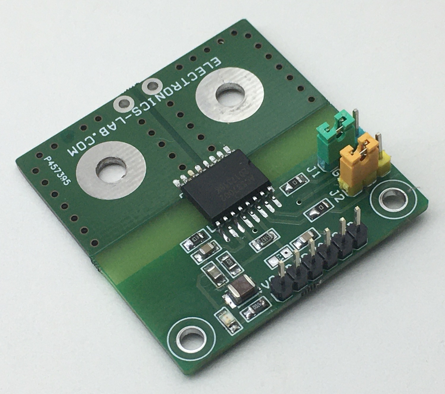

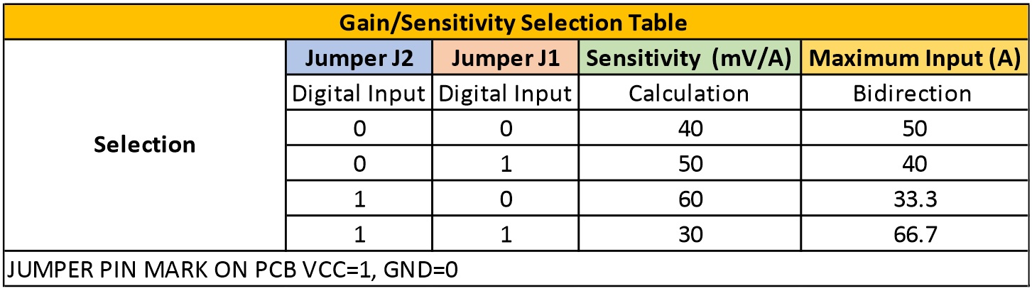

This is a high accuracy current sensor project build using ACS37002 IC from Allegro, which is a fully integrated Hall-effect current sensor with 0.85mOhms integrated conductor. A fast overcurrent alert output, programmable gain settings and analog linear voltage outputs are key features of this project. The sensor has optimized accuracy for current ranges +/-33A to +/-66 A and the analog voltage output is linear for the current of this range. The operating voltage of the project is 5V DC. The output voltage of this sensor is centered at VCC/2 =2.5V. Output sensitivity depends on the jumper settings, please refer to the table below for sensitivity/Gain configuration. CN2 6-pin header connector provided for power input and outputs. D1 is the power LED. Overcurrent alert is set to a minimum but it can be set as per user requirement by changing resistor divider R4 and R5, more information provided below.
Note: It is advisable to change the jumper J1 and J2 settings when the power is OFF. Refer to Jumper setting table for Gain settings

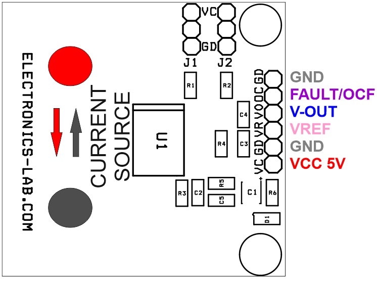

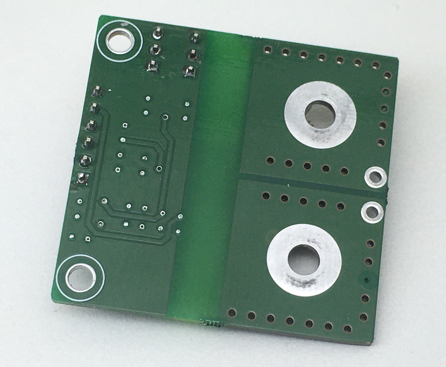

Connector CN2 Connections Details
  • Pin1=VCC 5V DC
  • Pin2=GND
  • Pin3= VREF 2.5V For ADC (Can be used for Microcontroller Interface Left Unused for Stand Alone Use)
  • Pin4=Sensor Voltage Output
  • Pin5= Over Current/Fault Output

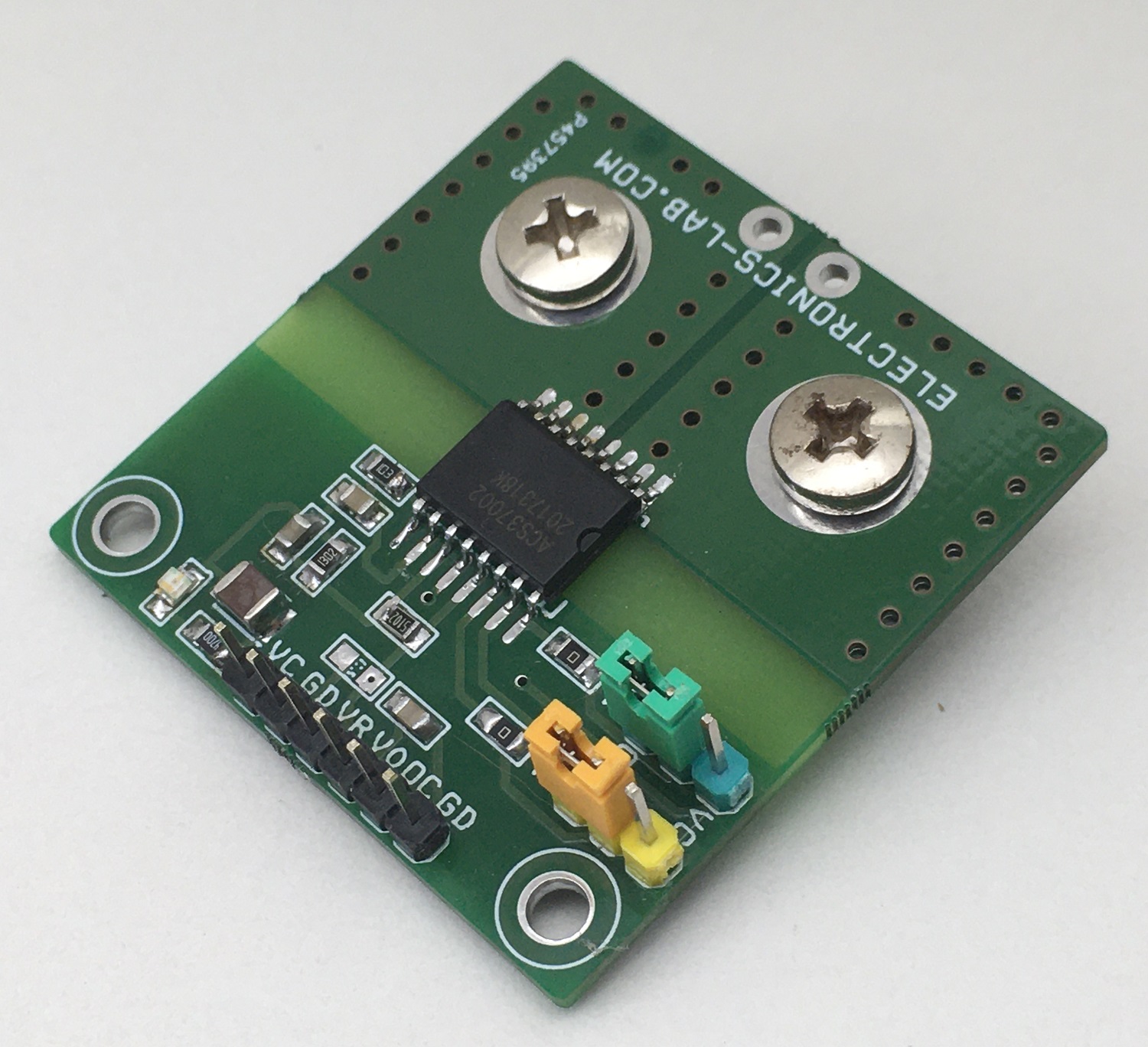

Connector CN1 = Current Source Connections (Use 5 mm Ring Terminal with 4 mm Screws and Nuts)
  • Operating Supply 5V DC
  • Output-VO 40mV/A, 50mV/A, 60mV/A, 30mV/A (50A,40A,33.3A,66.7A)
  • Four Configurable Gain Settings Using Jumper J1, J2
  • Adjustable Fast Over Current Fault 1us Response Time
  • Over Current Output Normally High Goes Low @ Fault Condition (OCF)
  • High Operating Bandwidth for Fast Control Loops
  • 400Kz Frequency Bandwidth, 2us Response Time
  • Very Low Sensitivity Error 1%
  • 6mV Maximum Offset Voltage Over Temperature
  • PCB DIMENSIONS 42.55  X 41.59 mm

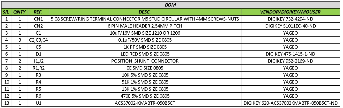

Parts List

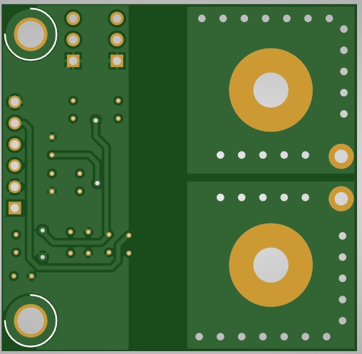

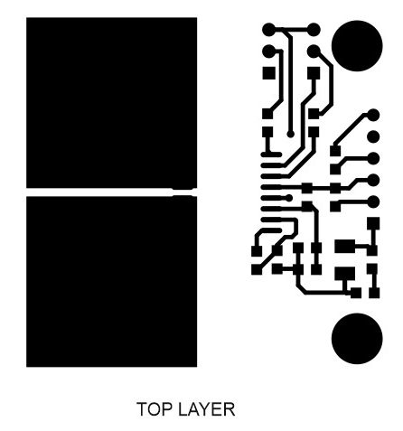

Gerber View
