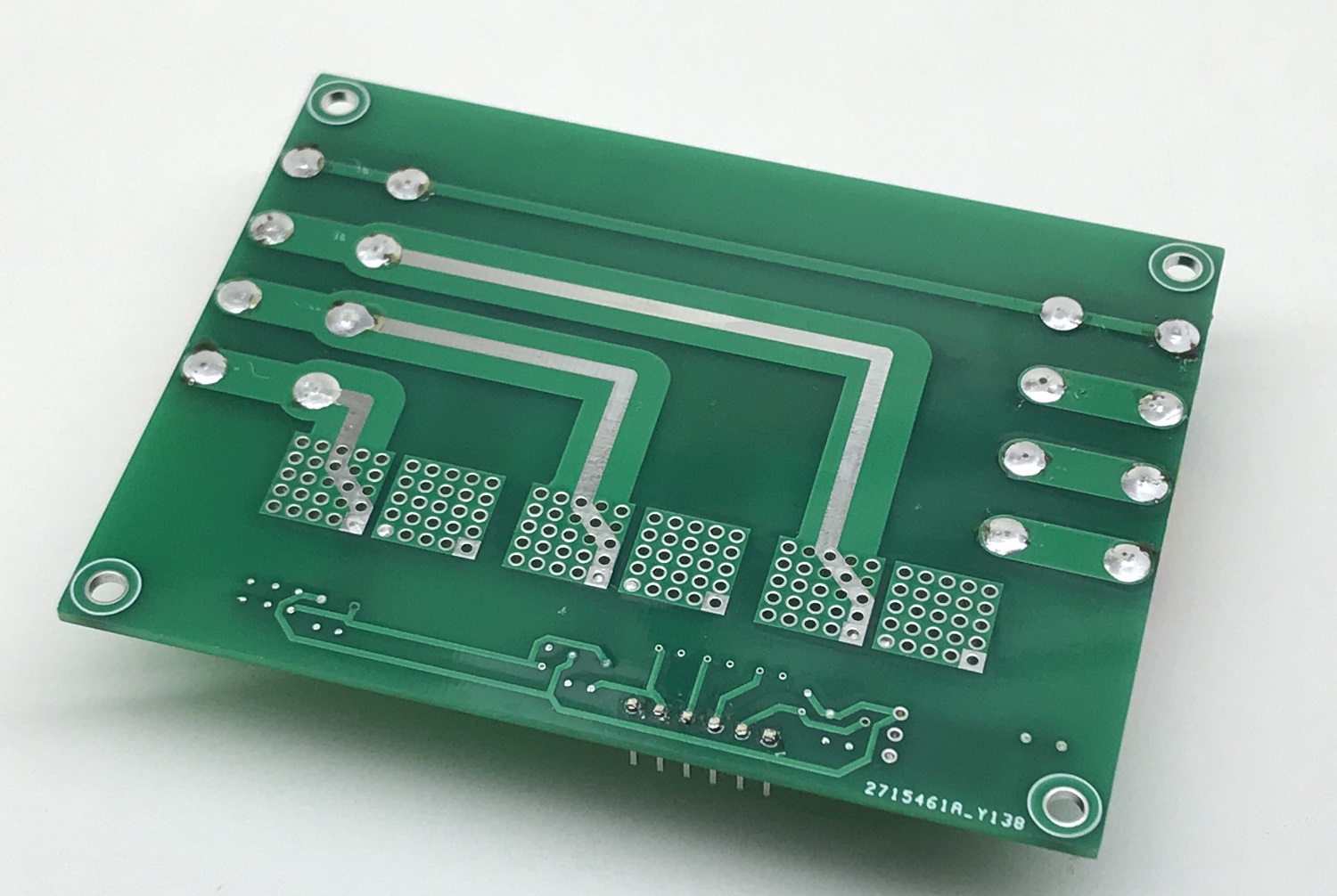

- PCB Dimensions 97 x 72.71 mm

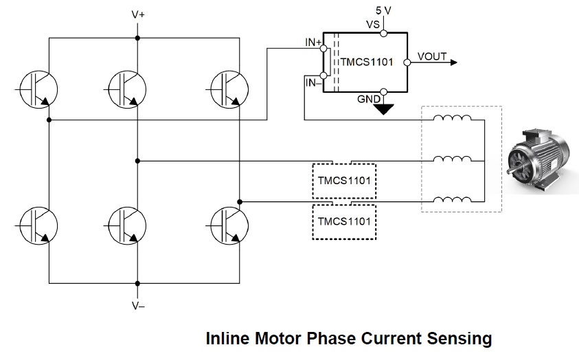

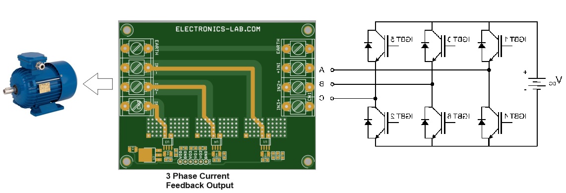

- Inline Motor Phase Current Sensing
- 3 Phase Motor or Load Current measurement
- 3 Phase DC or AC Power Monitoring

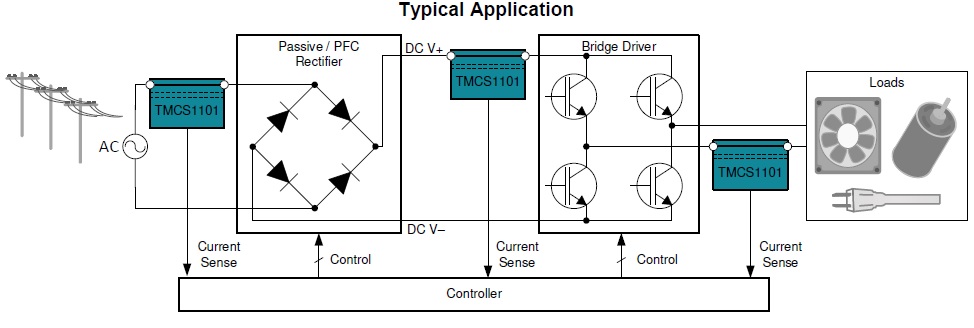

TMCS1101 Typical Application

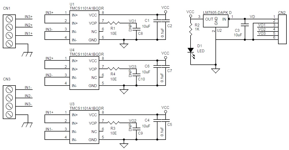

Schematic

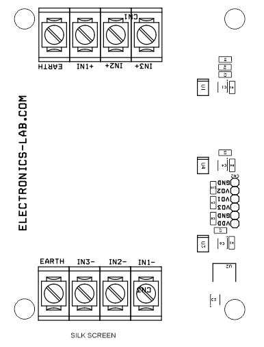

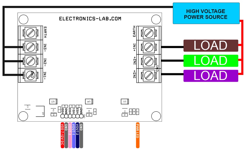

Connections
3-Phase Current Measurement

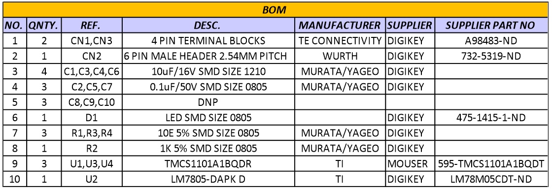

Parts List
| NO. | QNTY. | REF. | DESC. | MANUFACTURER | SUPPLIER | SUPPLIER PART NO |
| 1 | 2 | CN1,CN3 | 4 PIN TERMINAL BLOCKS | TE CONNECTIVITY | DIGIKEY | A98483-ND |
| 2 | 1 | CN2 | 6 PIN MALE HEADER 2.54MM PITCH | WURTH | DIGIKEY | 732-5319-ND |
| 3 | 4 | C1,C3,C4,C6 | 10uF/16V SMD SIZE 1210 | MURATA/YAGEO | DIGIKEY | |
| 4 | 3 | C2,C5,C7 | 0.1uF/50V SMD SIZE 0805 | MURATA/YAGEO | DIGIKEY | |
| 5 | 3 | C8,C9,C10 | DNP | |||
| 6 | 1 | D1 | LED SMD SIZE 0805 | DIGIKEY | 475-1415-1-ND | |
| 7 | 3 | R1,R3,R4 | 10E 5% SMD SIZE 0805 | MURATA/YAGEO | DIGIKEY | |
| 8 | 1 | R2 | 1K 5% SMD SIZE 0805 | MURATA/YAGEO | DIGIKEY | |
| 9 | 3 | U1,U3,U4 | TMCS1101A1BQDR | TI | MOUSER | 595-TMCS1101A1BQDT |
| 10 | 1 | U2 | LM7805-DAPK D | TI | DIGIKEY | LM78M05CDT-ND |
