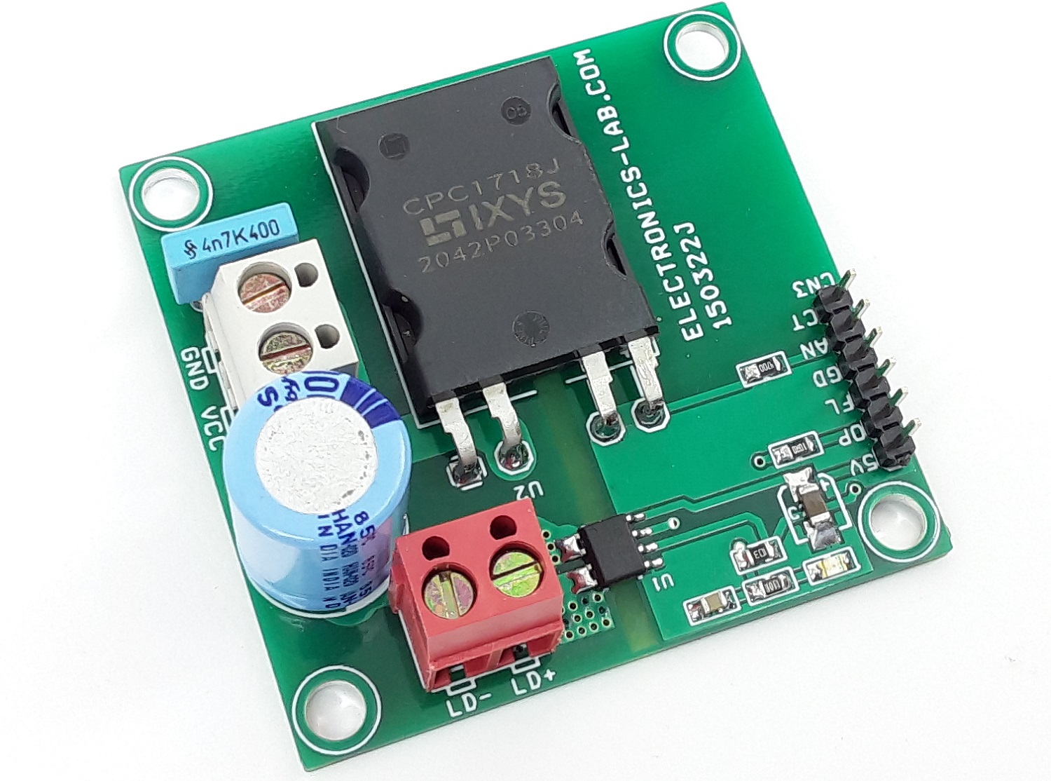

Optically Coupled Power MOSFET Relay with Galvanically Isolated Current Monitor Output This project employs CPC1718J 100V Single-Pole, Normally Open DC-Only Power Relay and ACS71240 Galvanically Isolated Current Sensor IC with Common-Mode Field Rejection and Overcurrent Detection. The board can be used for applications such as industrial controls, motor control, robotics, and electronics switching.

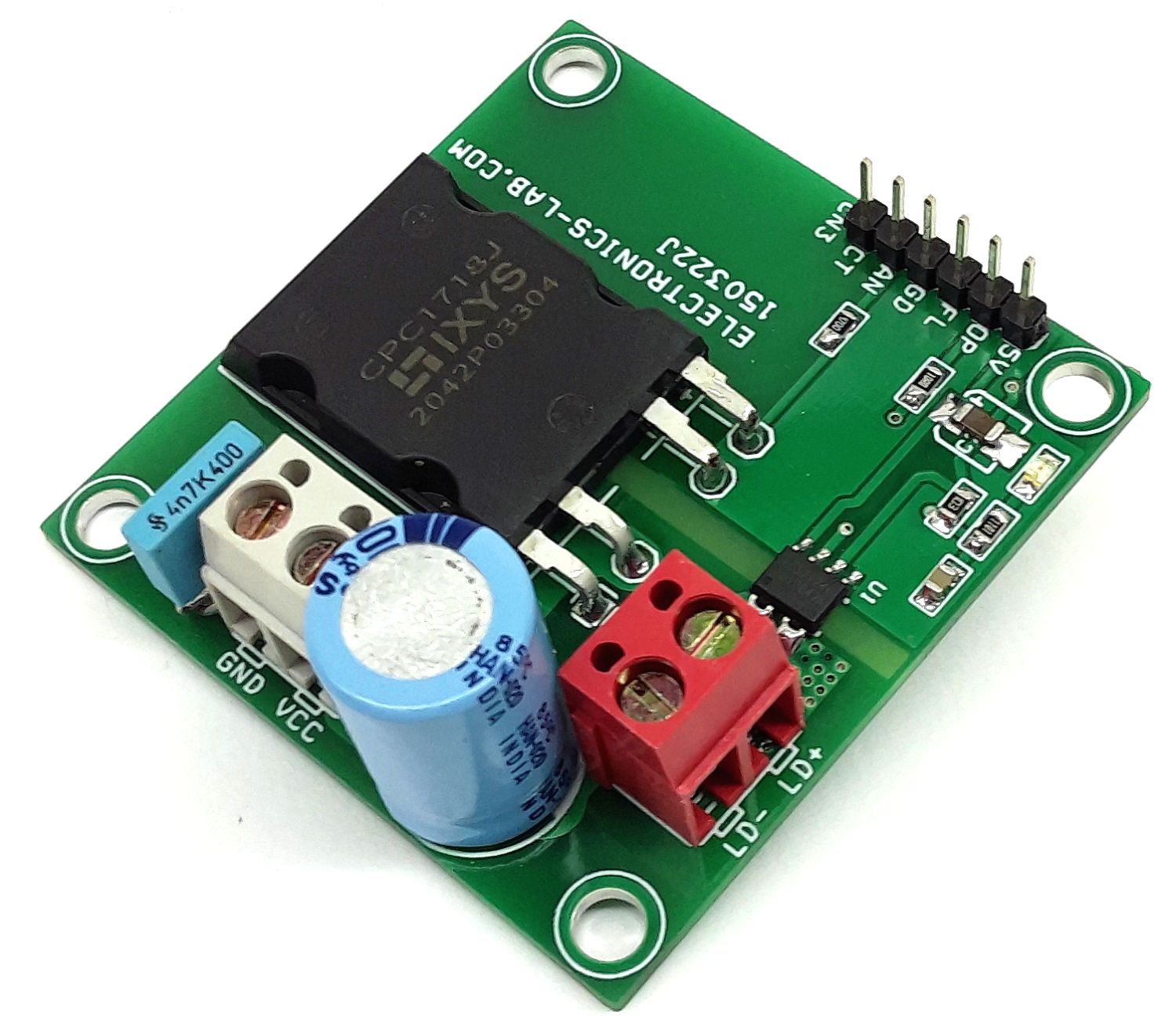

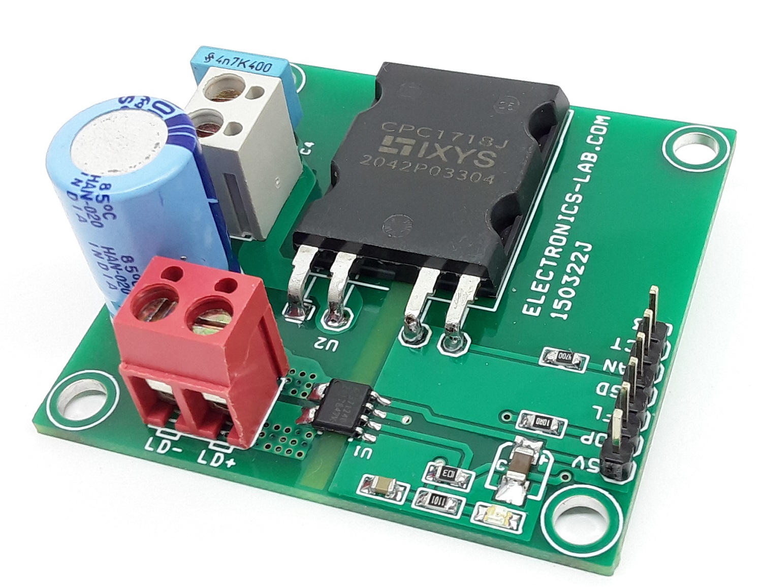

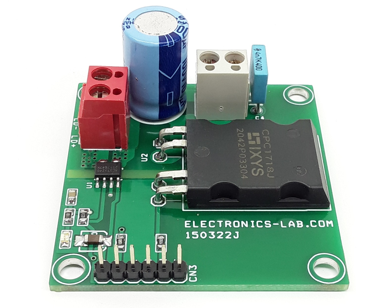

This project employs CPC1718J 100V Single-Pole, Normally Open DC-Only Power Relay and ACS71240 Galvanically Isolated Current Sensor IC with Common-Mode Field Rejection and Overcurrent Detection. The board can be used for applications such as industrial controls, motor control, robotics, and electronics switching. The relay is normally open and requires a 3.3V to 5V input signal to operate with a maximum operating load power supply of 100V DC, and load up to 6.75A without a heatsink and 17.5A with a heatsink.

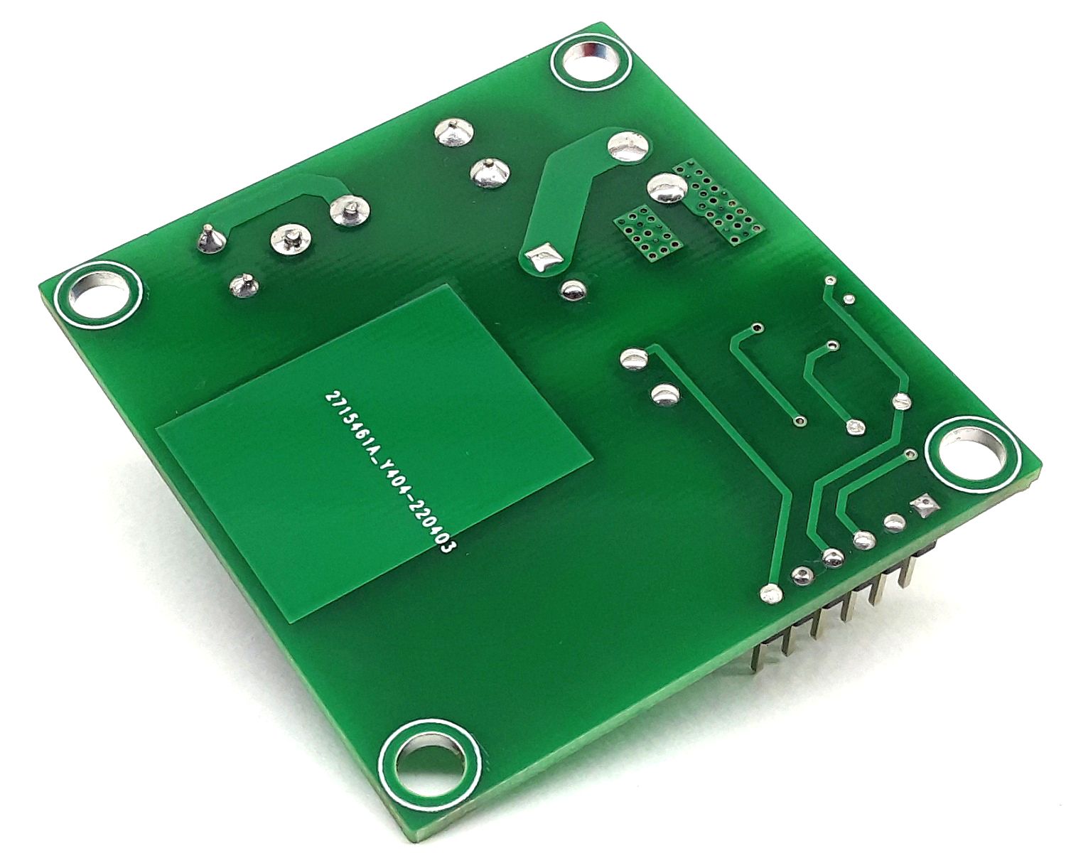

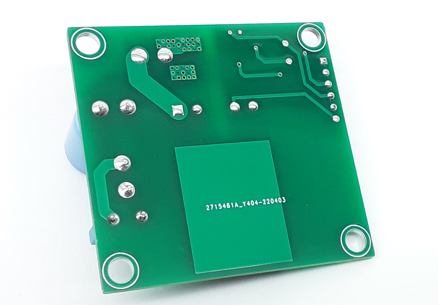

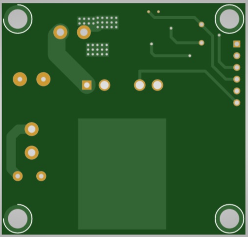

Note1: The relay can handle load up to 17.5A with heatsink and 6.75A without heatsink, solder the CPC1718J relay under the PCB for heatsink mount.
Note2: ACS71240 Current sensor can measure current up to 10A. The working voltage of the chip is 3.3V. This sensor is available with various current ranges and working voltage, refer to the datasheet of the ACS71240 chip for an appropriate device as per user requirements.

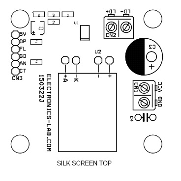

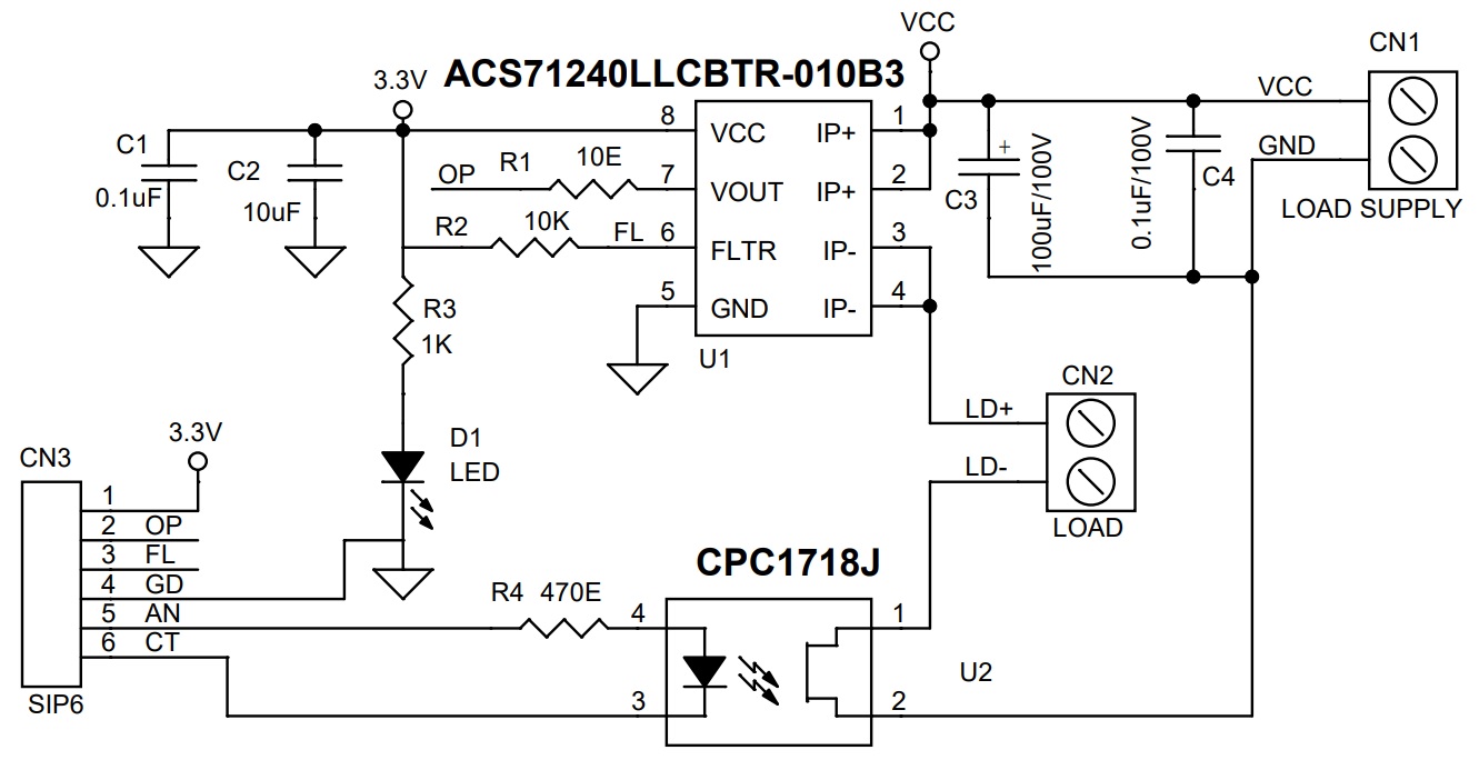

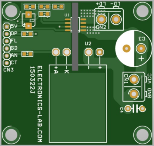

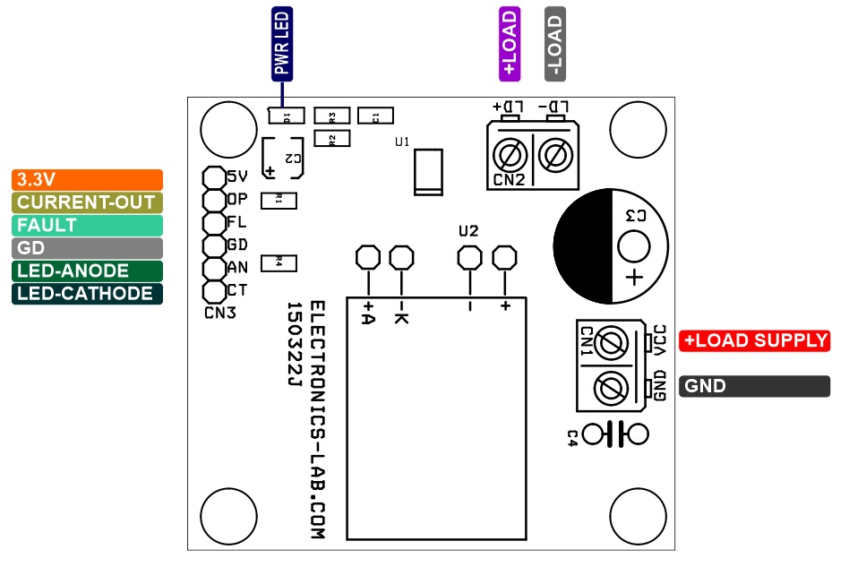

Connections and Other Details
  • CN1: Pin 1 = VCC Input Up to 90V DC, Pin 2 = GND
  • CN2: Pin 1 = +Load, Pin 2 = GND-Load
  • D1: Power LED Logic Supply for Current Sense Circuit
  • CN3: Pin 1 = 3.3V Input for Current Sense IC, Pin 2 = Current Monitor Output, Pin 3 = Fault (Active Low), Pin 4 = GND(Logic), Pin 5 = LED Anode, Pin 6 = LED Cathode
  • Load Power Supply 90V DC (Range up to 100V)
  • Load Current 6.75A Without Heatsink, 17.5A with heatsink and Fan
  • Power Relay Low 0.075W On-Resistance
  • 2500Vrms Input/Output Isolation

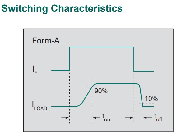

  • Relay Turn-on Time 7.5mS to 20mS
  • Relay Turn Off Time 0.19mS to 5mS
  • Relay Input Signal 3.3V to 5V @ 10mA
  • PCB Dimensions 52.71MM X 50.17MM
  • 4 X 4MM Mounting Holes
  • 100uF /100V DC Bus Capacitor
  • Screw Terminals for Load and Load Power Supply

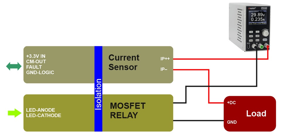

The project also consists of a current sensor for load current feedback. The current sense circuit is built using ACS71240. The current sense output is also galvanically isolated and can be used to monitor the load current, fault condition, open load, and short circuit. The current sense circuit requires 3.3V Supply, and the sensor output is 132mV/A, Zero-Current Output Voltage 1.65V. The normal output of the current sensor is 1.65V when the load is disabled or not connected.
The ACS71240 current sensor IC is an economical and precise solution for AC or DC current sensing in industrial, automotive, commercial, and communications applications. The device consists of a precise, low-offset linear Hall sensor circuit with a copper conduction path located near the surface of the die. Applied current flowing through this copper path generates a magnetic field which is sensed by the integrated Hall IC and converted into a proportional voltage. The resistance of the integrated conductor is far less than typical sense resistors, which reduces power loss and improves efficiency.  Rejection of external common-mode magnetic fields is achieved through differential sensing, enabling high accuracy in magnetically noisy environments. A precise voltage proportional to the measured current is generated by the low-offset, chopper stabilized Hall front end

Schematic

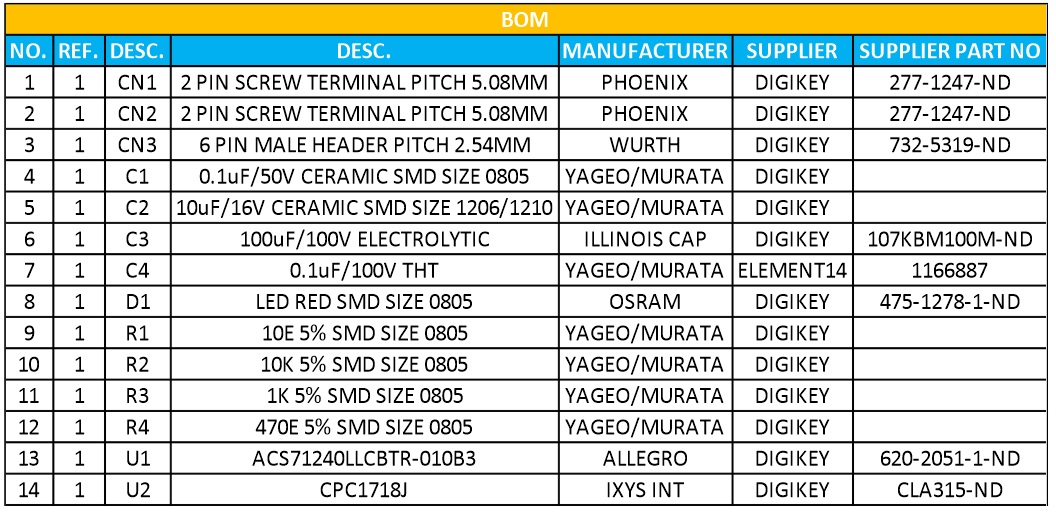

Parts List
NO.REF.DESC.DESC.MANUFACTURERSUPPLIERPART NO
11CN12 PIN SCREW TERMINAL PITCH 5.08MMPHOENIXDIGIKEY277-1247-ND
21CN22 PIN SCREW TERMINAL PITCH 5.08MMPHOENIXDIGIKEY277-1247-ND
31CN36 PIN MALE HEADER PITCH 2.54MMWURTHDIGIKEY732-5319-ND
41C10.1uF/50V CERAMIC SMD SIZE 0805YAGEO/MURATADIGIKEY
51C210uF/16V CERAMIC SMD SIZE 1206/1210YAGEO/MURATADIGIKEY
61C3100uF/100V ELECTROLYTICILLINOIS CAPDIGIKEY107KBM100M-ND
71C40.1uF/100V THTYAGEO/MURATAELEMENT141166887
81D1LED RED SMD SIZE 0805OSRAMDIGIKEY475-1278-1-ND
91R110E 5% SMD SIZE 0805YAGEO/MURATADIGIKEY
101R210K 5% SMD SIZE 0805YAGEO/MURATADIGIKEY
111R31K 5% SMD SIZE 0805YAGEO/MURATADIGIKEY
121R4470E 5% SMD SIZE 0805YAGEO/MURATADIGIKEY
131U1ACS71240LLCBTR-010B3ALLEGRODIGIKEY620-2051-1-ND
141U2CPC1718JIXYS INTDIGIKEYCLA315-ND
Connections

Switching Timing

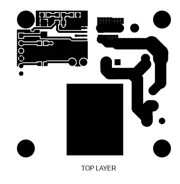

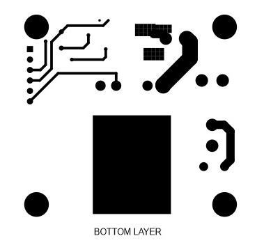

Gerber View

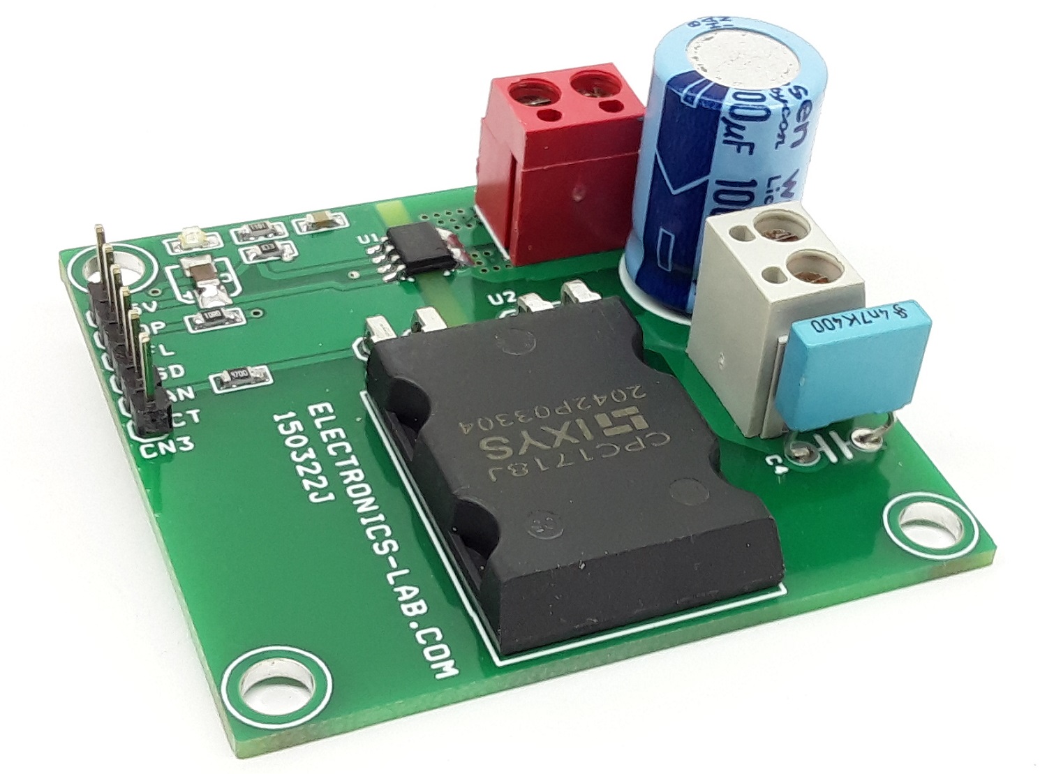

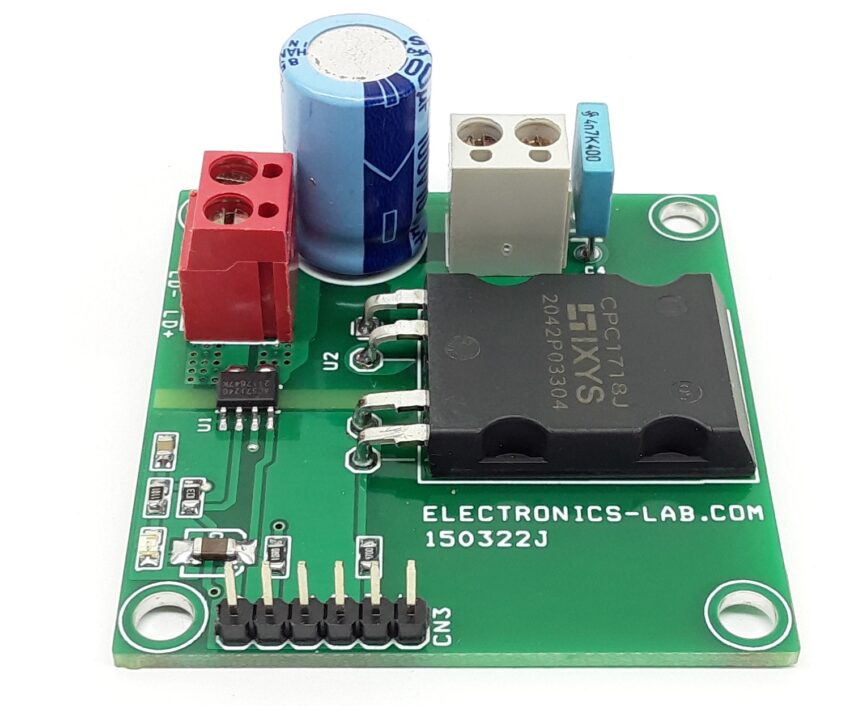

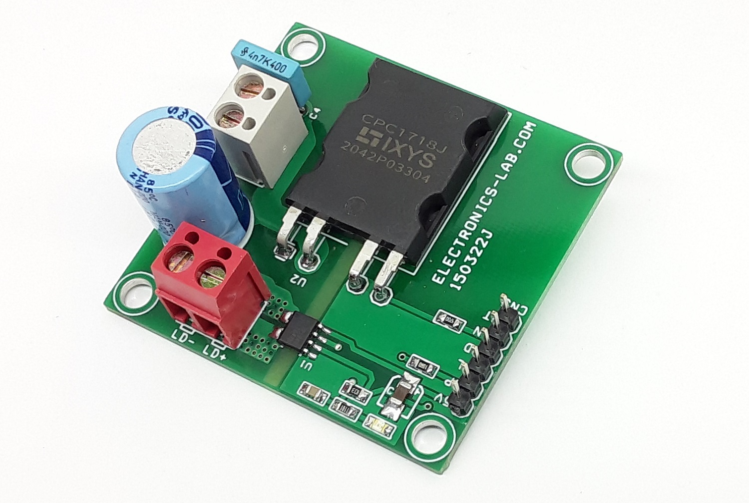

Photos
