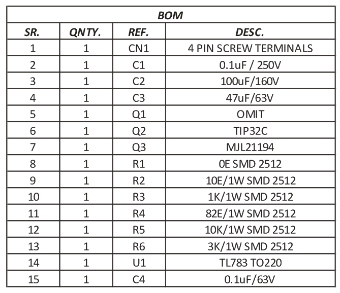

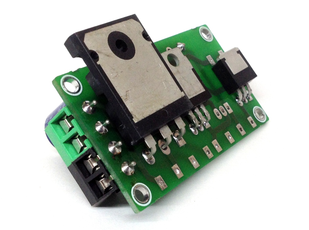

Even if ADJ is disconnected inadvertently, the protection circuitry remains functional. Only two external resistors are required to program the output voltage. An input bypass capacitor is necessary only when the regulator is situated far from the input filter. An output capacitor, although not required, improves transient response and protection from instantaneous output short circuits. Excellent ripple rejection can be achieved without a bypass capacitor at the adjustment terminal. Output voltage fixed 48V DC but it is adjustable by changing the value of resistor value R6,  refer to datasheet for the formula to choose the appropriate value of R6. LT783 and transistors require a large size heat sink.

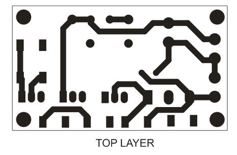

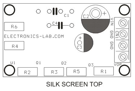

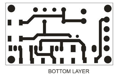

  • PCB Dimensions 57 x 33mm

Parts List

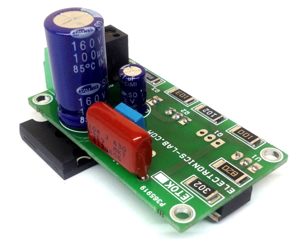

Photos
