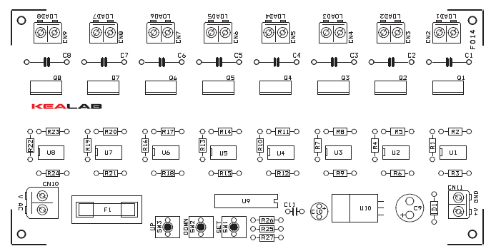

This project provides some lighting effect by the blinking pattern of the bulbs connected at its output. Up to 8 Bulbs can be connected in between connector CN2 to CN9 and AC power to control them should be connected at Connector CN10. DC Power should be applied at Connector CN11 in accordance with the polarity marked on this connector. Care should be taken while using this it as it contains Main Power on the board.
We can change the Blink pattern by the press of the SET switch and change the blinking speed by the press of the UP and DOWN keys on the PCB. Fuse F1 will protect the Kit from any possible short circuit and excess current flowing through it.

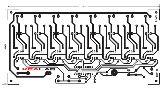

- PCB dimensions 86 mm x 173 mm

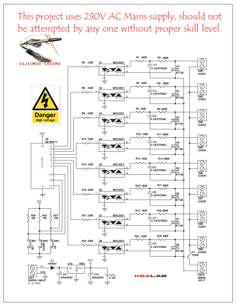

Schematic
Would you please get the Hexfile for the above project in the above E-mail.ID. Regards Das
You can download .hex file on the link above.

Helloo, i bulit this project, but it doesn’t work, it keeps open only RB7 port.
Can you share the source code??
We are sorry, source code isn’t available. Please double check your connections and programming of the micro controller.
helloo, I bult this project to use it with some LED light rope , but there is a small problem, the led’s doesn’t close totelly, can you help me please.
This project is mainly used with incandescent lamps and it seems that there is some leakage current through the TRIAC. You may try another TRIAC with lower “Off-state leakage current”
Can you recomend me what triac I should use??
You may try MAC12DG from ON Semiconductor which has 1/10th of leakage current of BT136

Dear Sir. The (U9) master ic is ready to use or program. and i need the pcb
