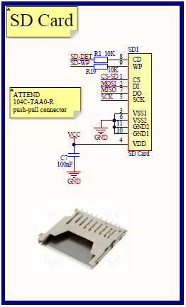

sd_card_schematic

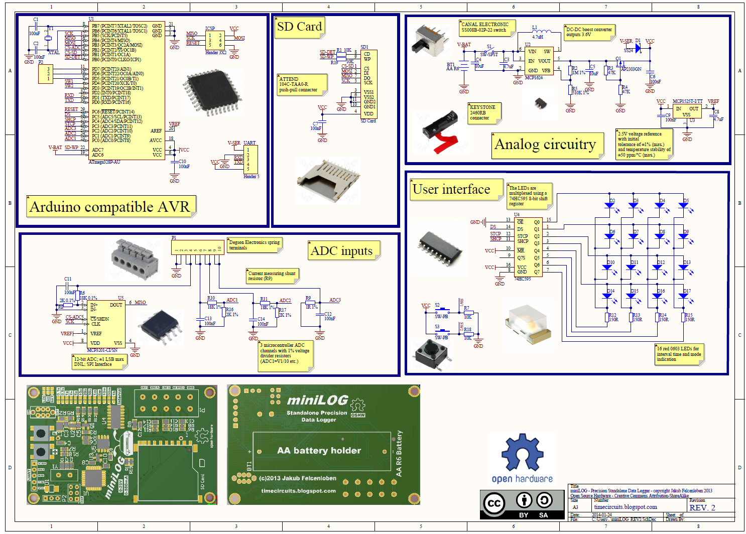

Schematic
The full schematic is show below
schematic

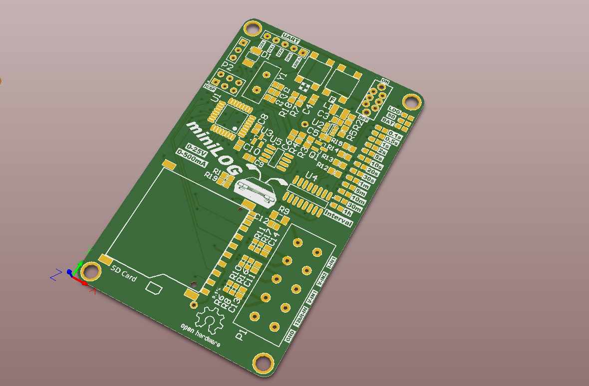

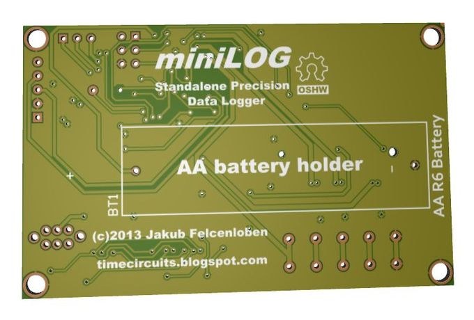

Photos
3D_minilog_back_th
