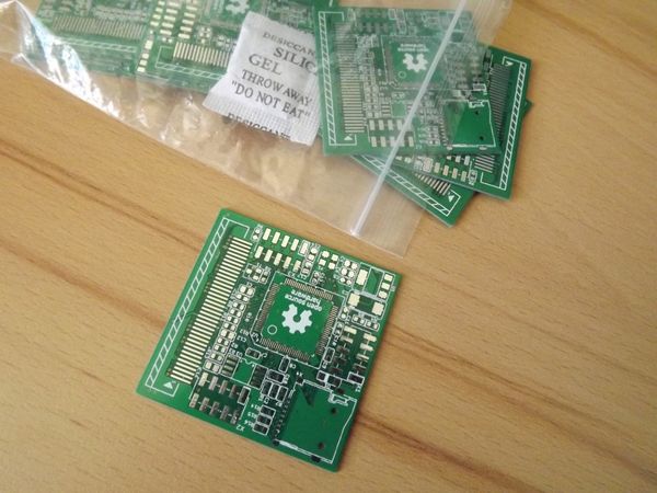

In the beginning, I just wanted to play with these cheap TFT screens available on eBay (displaying some pictures & text, nothing more); step by step, I finally designed a PCB and a built a consequent software with many 2D basic functions and even a small GUI.
The board is based on a PIC32 and a 3.2′ TFT with touchscreen (ILI9320 controller, using 16bits PMP). The PCB is 4.9 x 4.9 cm, 2 layers (=> $15 / 10 units at seeedfusion).

PCB
smart_display_2
reception_pcb
